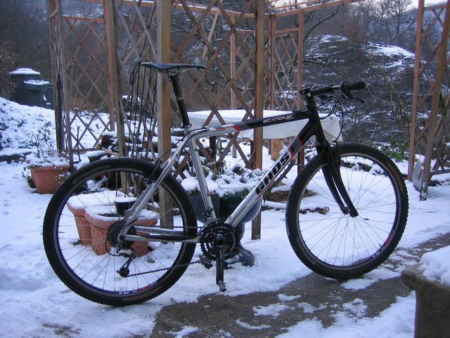

ghost in der 1. ausbaustufe, fahrfertig:
teile:
frame "2003 ghost htx scandium team 20,5""; incl. headset, dropout,
2 alloy bottle cage bolts; excl. canti studs, seatpost clamp " 1449
headset cane creek regular 1 1/8" (50g without seatrings)
fork braxxo rigid carbon, incl. clamp, excl. canti studs 64
stem syntace force 99 mtb 120mm, titanium bolts 102
handlebar easton ec90 carbon, 3°, 560mm 100
grip no name kork; cut, inkl. end plugs 16
spacer carbon 1 1/8"; ∑ total 11
seatpost tune starkes stück Æ31,8, uncut 190
saddle selle slr tt 140
seat post clamp quantec; incl. bolt 24
ahead cap syntace lite cap, inc. syntace alloy bolt 11
crank set shimano xtr fc-m 960 688
bottom bracket shimano xtr fc-m 960 105
front derailleur shimano lx 137
rear derailleur shimano xtr sgs 200
front brake avid single digit ti; incl. xlc pads, bolts; excl. pipe 159
rear brake avid single digit ti, incl. kool stop pads, bolts; excl. pipe 151
front brake lever avid speed dial ti 95
rear brake lever avid speed dial ti 94
rear gear shifter sram rocket; inkl. uncut cable 108
front gear shifter sram rocket; inkl. uncut cable 104
pedal egg beater sl 271
chain shimano dura ace, inkl. sram lock; cut to size 260
canti studs front and rear 40
cassette xtr 11-32, titanium 240
front hub american classic road micro / front wheel 651
rear hub american classic mtb / rear wheel 825
spokes dt swiss 1,8 - 1,6 - 1,8
nipples brass
front rim dt swiss xr 4.1
rear rim dt swiss xr 4.1
rim tape regular; pair 38
front tire continental twister ss 369
rear tire continental twister ss 363
inner tubes schwalbe xxlight / pair (123g & 129g) 252
skewers tune ac 16 & 17 54
protection stickers 15
brake cable delta duracote, inkl. nokon housing 71
gear shift cable sram
brake cable housing nokon;
gear shift cable housing nokon; front & rear 57
∑ total 8031
gewechselt wird noch:
bremshebel (extralite), cantibolzen (alu), umwerfer (xtr fc-m 950 oder 952), sattelschelle (extralite) einige schrauben (alu)
alle gewichte selbst nachgewogen - nix geschätzt!
ups, was ist denn da schief gegangen?
641 stimmt! das gesamtgewicht stimmt aber!
gib bitte mal einen fahrbericht über die gabel ab! mit der liebäugele ich auch schon lange!
ich hoffe, die extralite teile sind schon bestellt? weisst du was darüber?
gerade erst zusammengezimmert, aus resten und neuteilen - die gabel ist neu.
wollte erst eine steinbach, dann hat mir die braxxo aber trotz des mehrgewichts besser gefallen. sobald die fahreindrücke vorliegen melde ich mich.
ein bekannter ist die bisher gefahren (gegen eine sid getauscht - wird wohl langsam alt) - der ist normalerweise ein ziemlicher nörgler wenn ansatzweise was nicht stimmt, hat beim selberbauen an jeder hand 5 dicke linke zehen. aber über die gabel hat er nie gemeckert! eingebaut und über jahre gefahren - allerdings ist er auch ein leichtbauer was seinen körper angeht.
@frogfrank
bitte mal ne teileliste posten, wenn´s geht mit gewicht.
dein gewicht macht mich, auch wenn´s kein 20,5"er ist, neugierig!!!!
also die gabel funktioniert einwandfrei - kein bocken, flattern, knacken.
sehr steif.
das leicht nervöse fahrverhalten des bocks liegt eher an der rahmengeo die für federgabeln ausgelegt ist.
die tatsache, das die gabel seit jahren technisch unverändert produziert wird zeigt wohl, das es ein kleiner markt ist und die teile funktionieren.
