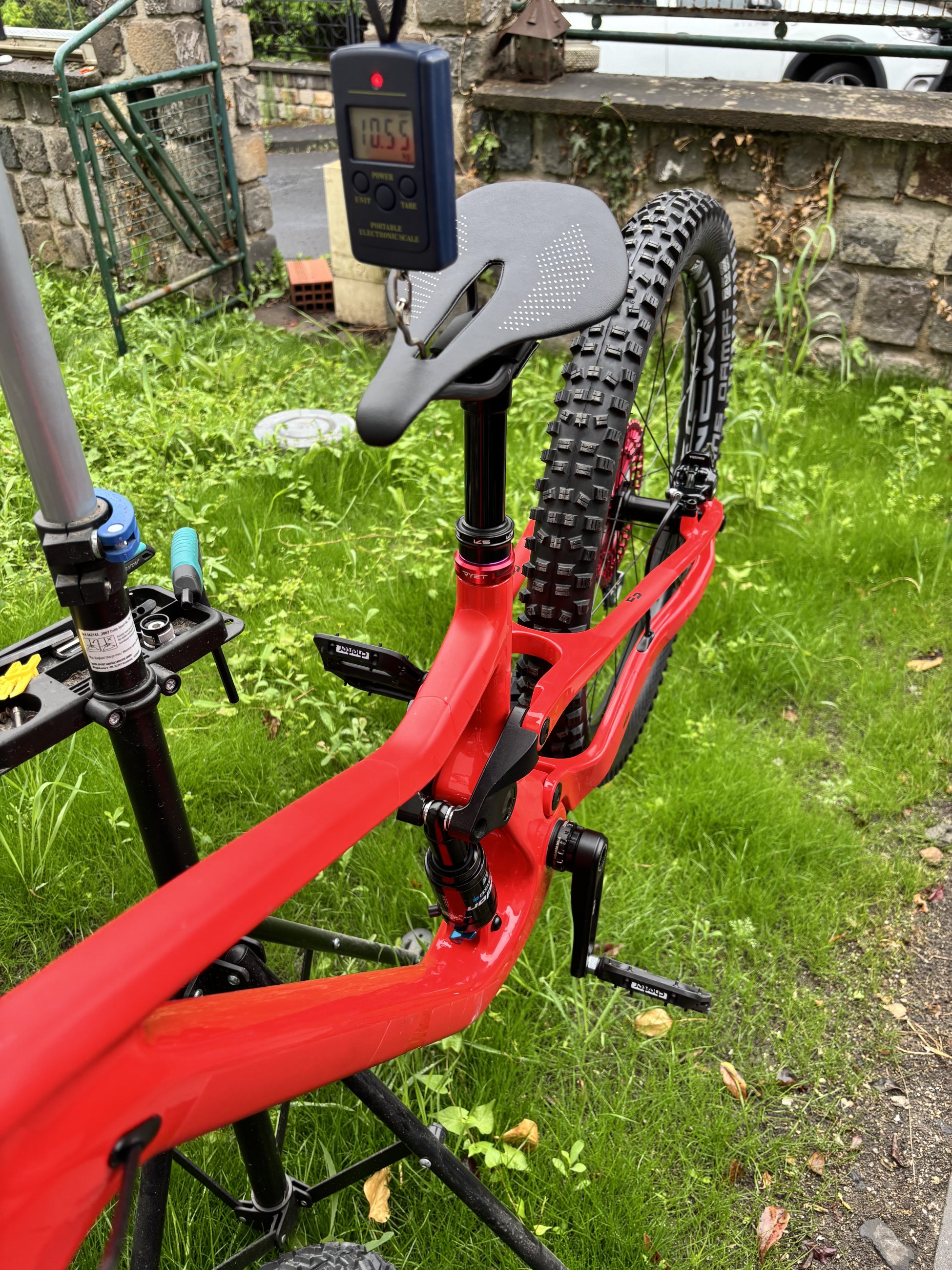

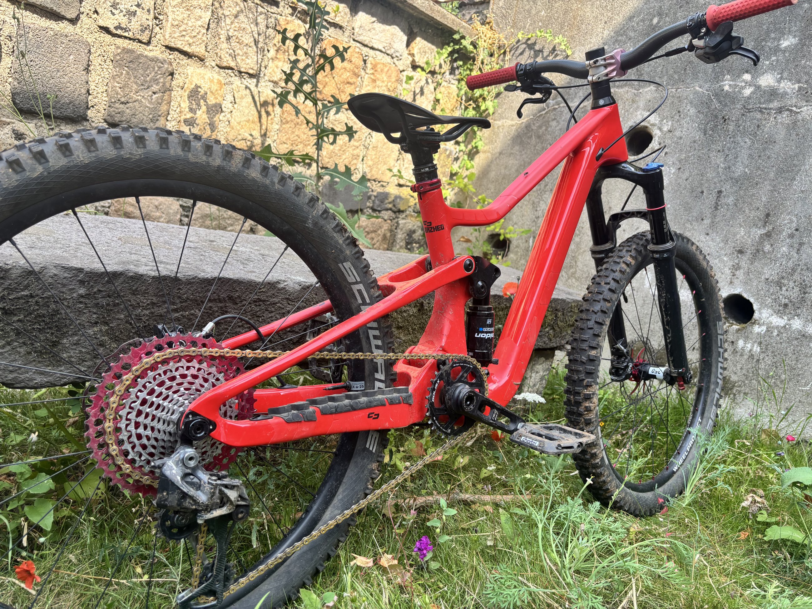

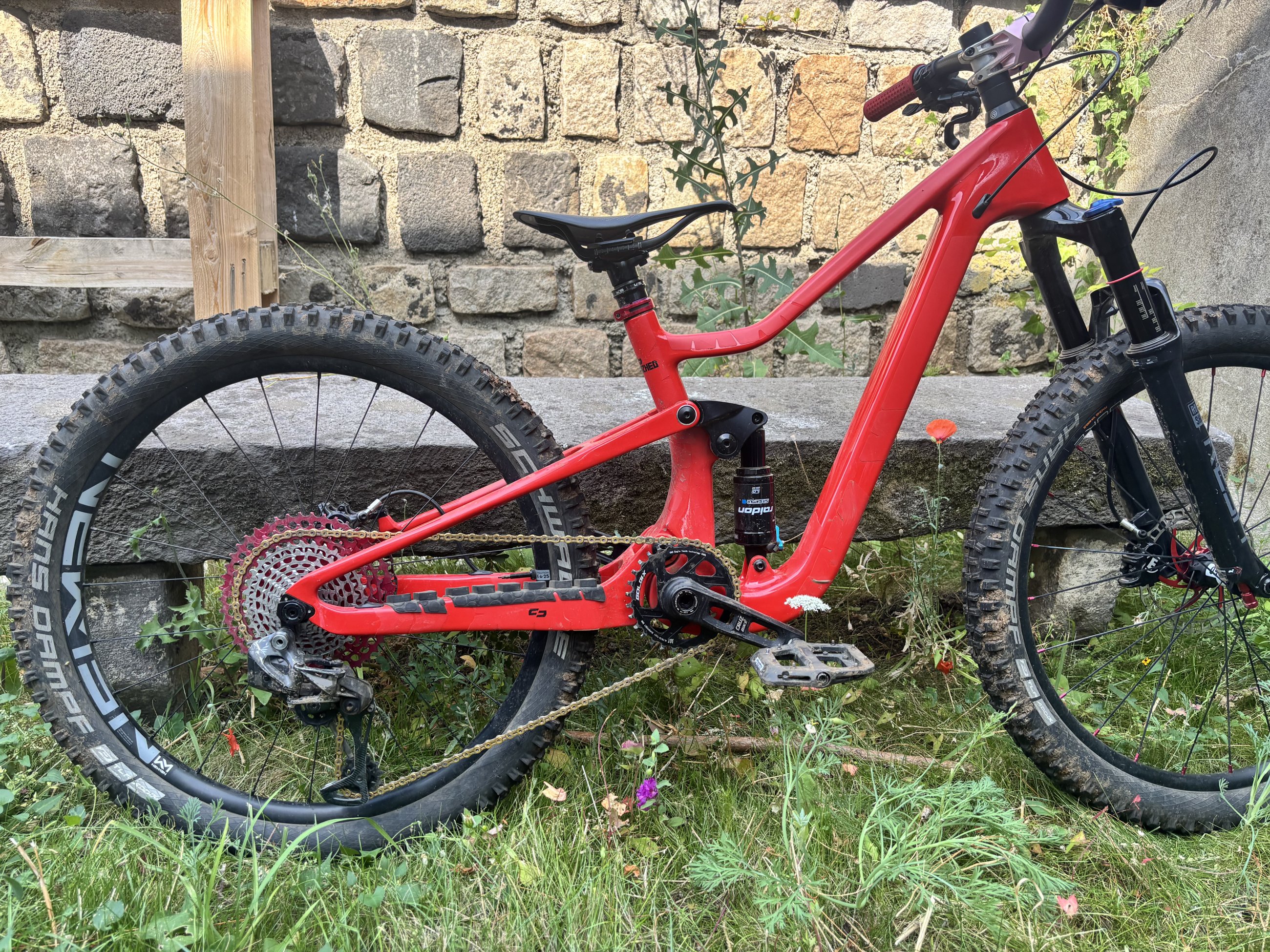

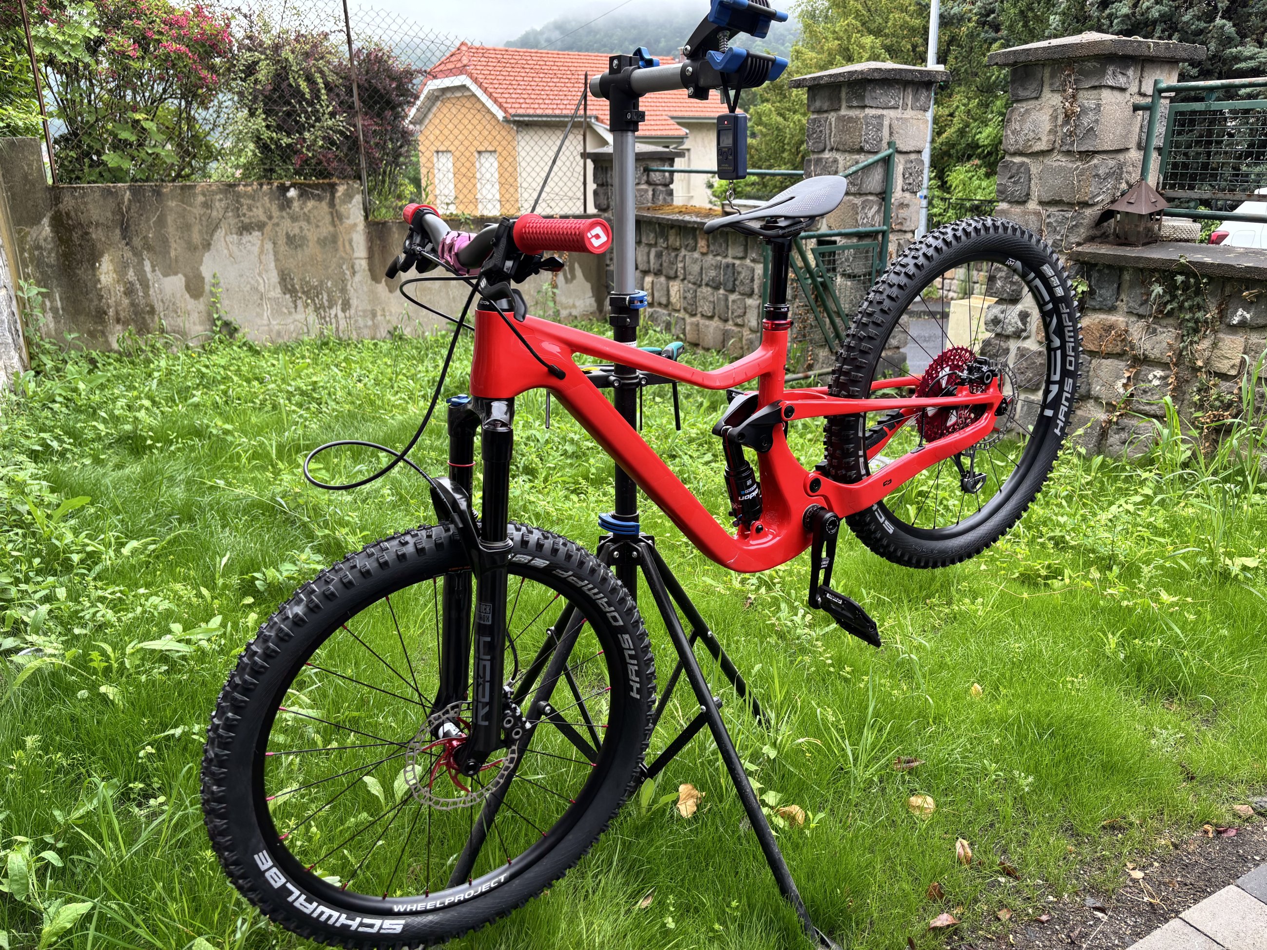

Build is not completely finished, the chain is being cleaned and waxed but overall I’m quite happy.
I will probably change the pedals as they’re huge and the front brake line will be shortened as well
Frame bxt24
Fork Reba solo air 26
Shock sr suntour 165x38
Rear wheel : newmen evolution kid 24
Front wheel : duke lucky star 24 / dt350 / sapim cx ray
Brakes : mt5/mt4 (waiting for hc levers)
Ztto slr 3 cassette 10-46
Chain ztto gold ultra light
X01 axs derailleur
Ks lev 75mm dropper and oneup remote
AliExpress 80gr seat
Evosid cheap Ali crankset (did not find any good alternative at a reasonable price)
Old carbon bar shortened and alloy stem I had in my garage
