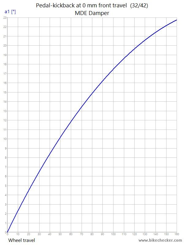

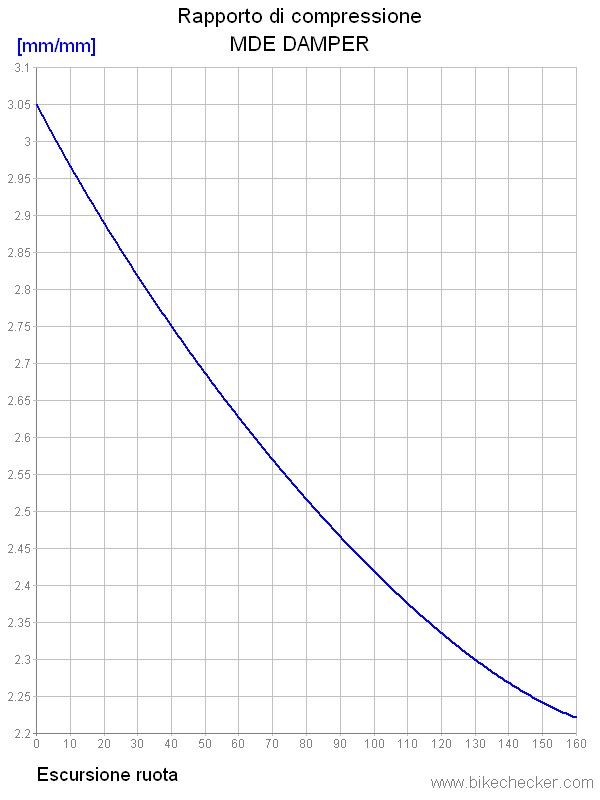

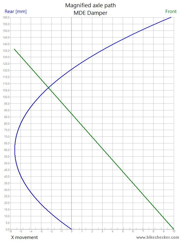

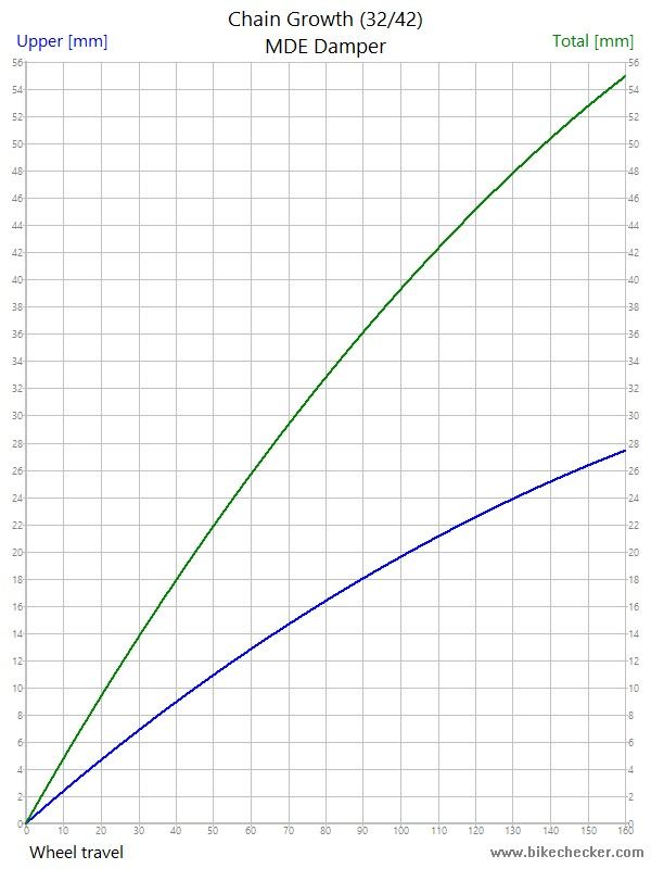

In diesem Post mochte ich die Kurven, die ich von Federico dem CEO von MDE bekommen habe zeigen. Diese zeigen, meiner Meinung nach, dass das MDE eines der besten Bikes ist, die man kaufen kann. Besser kann es vermutlich nur werden wenn man irgendwo eine Kettenumlenkung montiert.

The path of the rear wheel axle is also very important. Making a compromise we preferred to have a little pedal kickback, getting a better trajectory of the wheel in return. This is designed to further facilitate the overcoming of the obstacle. So now in the very first part of the movement of the wheels the axle goes back up to 5 mm (previously this value was 2 mm) up to the level of sag, and then goes in fornt for the rest of the travel. This allows a better overcoming of the obstacle, favoring more the natural movement in the impact phase and then crushing the bike and pushing it once the impact is overcome. This also proved to be an improvement for us.
You refer to the anti-squat on long gear ratios, but normally when you pedalin wiht 32T-10t or 14T your are in descendant or at least flat. So you shouldn't push hard or at least do it but on very high rotation frequencies, frequencies and levels that are normally not very influential on the anti-squat. While very important is that the suspension is stable when you push hard uphill at a much slower pace. The new Damper in these situations is exceptional. The suspension does not move. It is completely still. And that was our goal.
About the leveral ratio the curve is pretty similar to the old model. It is a progressive curve tha became little bit less progressive at the end, close to be linear (non regressive) but just in the last few millimeter.
Also this is something that we studied and defined during the development. For us the most important part of the travel is the mid part. It is very important that this part is supported and on the new Damper, this part it is very progressive. We also noticed that with the shock absorbers with medium settings which are the ones we take as reference (both air or coil) a more linear final part helps to use the whole travel especially because being the first part very progressive, already from halfway on, the rate is very high. If we had pushed the progressivity even at the end it would have taken shock absorbers with special settings to be able to take advantage of the whole travel.

Das Leverage Ratio sieht grundsätzlich auch gut aus, allerdings finde ich einen Startwert von über 3 immer etwas grenzwertig. Klar wird dadurch im ersten Bereich ein schönes Ansprechverhalten provoziert, aber schwerere Fahrer müssen hier immer ans Limit der zulässigen Luftdrücke gehen, was oftmals trotzdem zu entweder etwas harschem Ansprechverhalten und schwieriger Abstimmung der Zugstufe führen kann...
