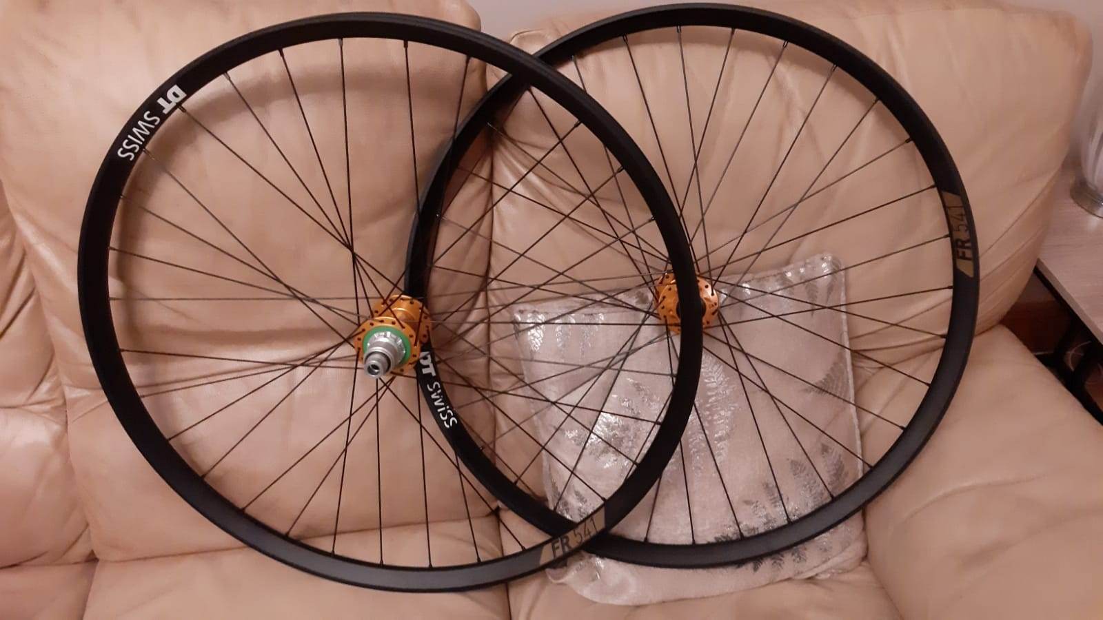

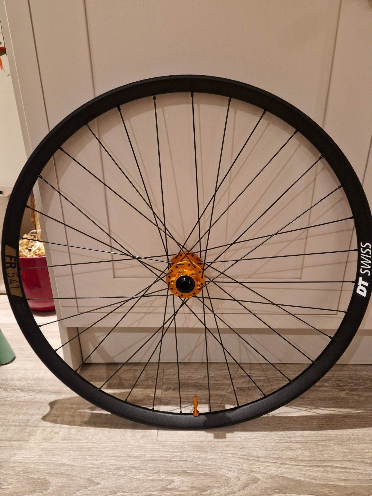

What is the weight of the weehls?New wheels for my 2021 Tyee AL
Hope Pro4 Hubs laced with DT Swiss Champion Spokes & Prolock Brass Nipples on DT Swiss FR541 Rims.
Replacing the stock Stans Flow on Propain hubs
Just waiting on my new tires and sealant before I fit them.
Anhang anzeigen 1623658Anhang anzeigen 1623659
