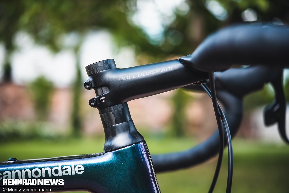

LenkerHollowgram Save System BarCannondale 3Cannondale 3
LenkerbandCannondale Bar TapeCannondale Bar TapeCannondale Bar Tape
Vorbau HollwoGram SaveCannondale 2Cannondale 2
