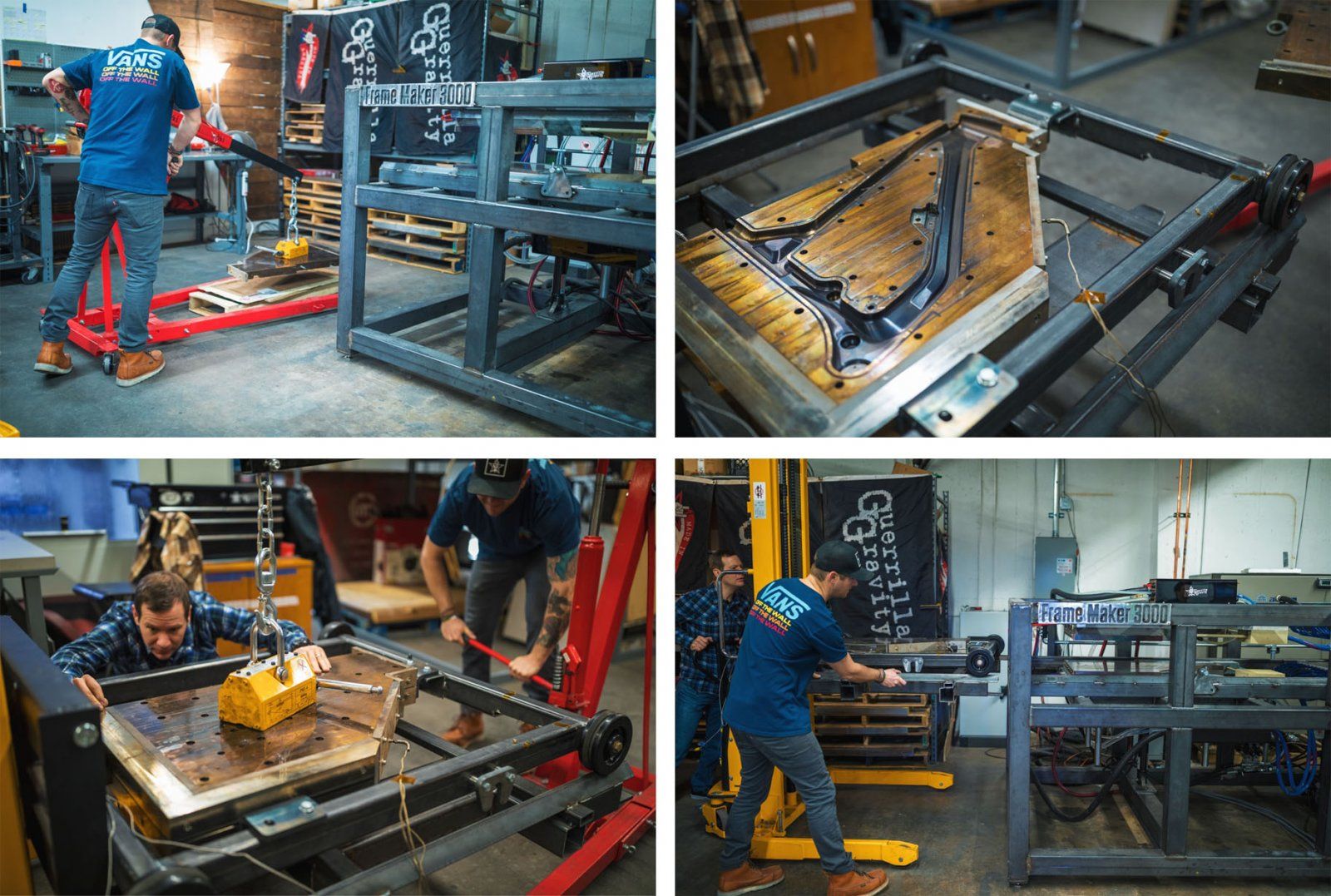

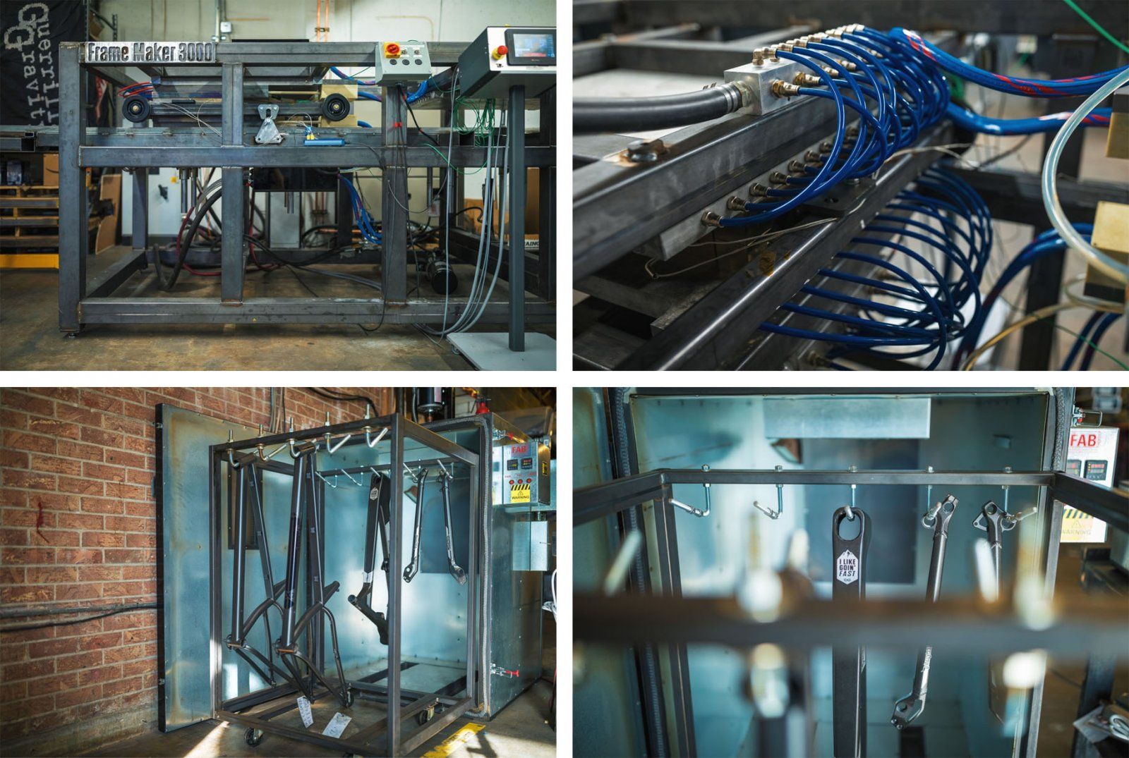

Die Jungs von GG machen das mit ihrem Frame Maker 3000
Guerilla-Gravity-Megatrail-Sred-Dogg-Smash-Trail-Pistol-one-carbon-frame-manufacturing-Revved-...jpg
Guerilla-Gravity-Megatrail-Sred-Dogg-Smash-Trail-Pistol-one-carbon-frame-revved-carbon-frame-m...jpg
Nachtrag:
Automated fiber placement has been around for a handful of years now, mostly in the aerospace sector, but Guerrilla Gravity says that using that method to construct hollow, 3D tubes wasn't something that had been done before. That's the secret, patent-pending part, and it required them to investigate new bladder and mold techniques to make it a viable process.
Once the robot has done its thing and the mold is closed, it's off to get cooked in by their 'Frame Maker 3000' machine, a job that takes just thirty minutes rather than hours and hours. The frame that emerges on the other end is then touched up by hand as required before being sent off to be powder-coated. What comes out is said to weigh 6.5lb without a shock, so while it's not the lightest frame around, it's also not the heaviest either.
