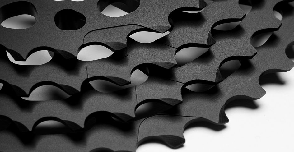

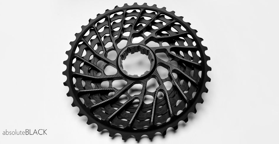

Hi,
We just wanted to do a small update..
We have moved spiderless design to narrow wide now, so if anyone of you still have some problems with dropping the chain, you have now new option. This solves all the problems and there is no need for the chainkeeper.
Like i mentioned before, if you want to change your old version to the new one i can offer a discount to such customers. Please contact me directly on my email
We also make some Cassette adapters now:
4 cog cluster 28-32-36-40. This saves almost 100g compared to single 40T cog addition and costs only 105eur.
http://absoluteblack.cc/cassette-adapter-28-40.html
