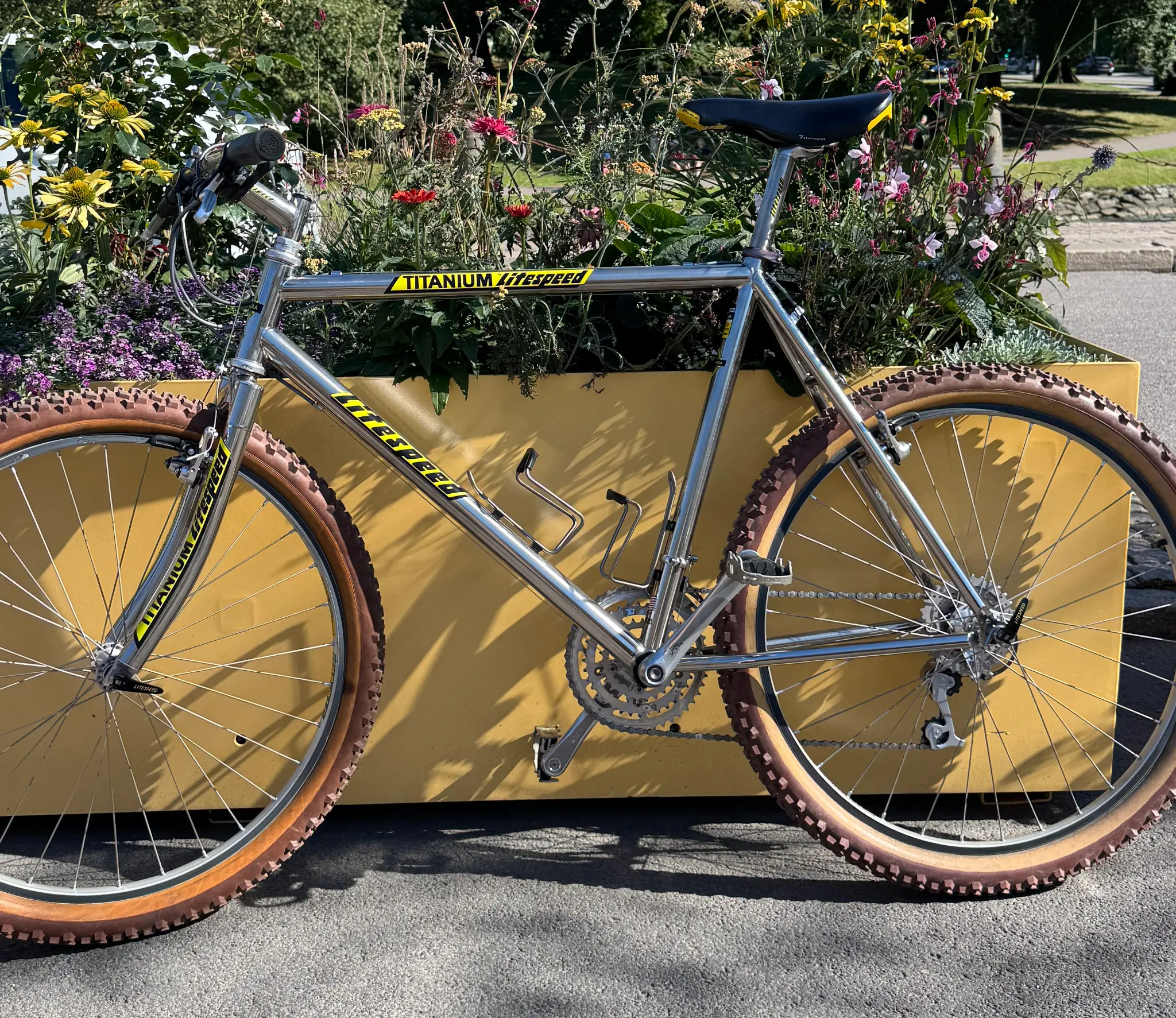

Hey everyone,
This build thread originally started on Retrobike, but I thought I’d continue the project here instead. I've shared the build already on my Instagram, but I wanted to post a more in-depth walkthrough of the build process here..
It began with me buying a complete, truly amazing Litespeed from Second Spin — equipped with everything Litespeed originally offered, plus a full Shimano XTR M900 group with matching date codes across all components.. After finishing the build and trying the bike a couple of times, I realized it was simply too big for me — a real bummer, and the start of a bit of a rollercoaster.
I decided to sell the frame and reuse all the components, wheels, and fork on another smaller (blasted) ’92 Litespeed I had sitting around. The large frame went off to Italy, and through a trade with a fellow collector in Austria I swapped my fork with the long steerer for his with a shorter one (so he could get his Litespeed bike together). We then went a step further and exchanged my matte-blasted frame for his polished frame of the right size. Phew!
In the end, I’ve basically ended up with a similar frameset as I started with—but this time in a size that fits me better. I actually prefer the neon decals on this one too, so that’s a bonus. The trade also brought in a stem with the diamond logo decal, which I kind of like more than the previous Litespeed one.
A few differences on this frame compared to the first one:
  • It’s from an earlier production run 4130 (!) vs 5xxx, with downtube routing for the rear derailleur cable.
  • It has no separate seatpost collar but instead an integrated seatpost binder bolt.

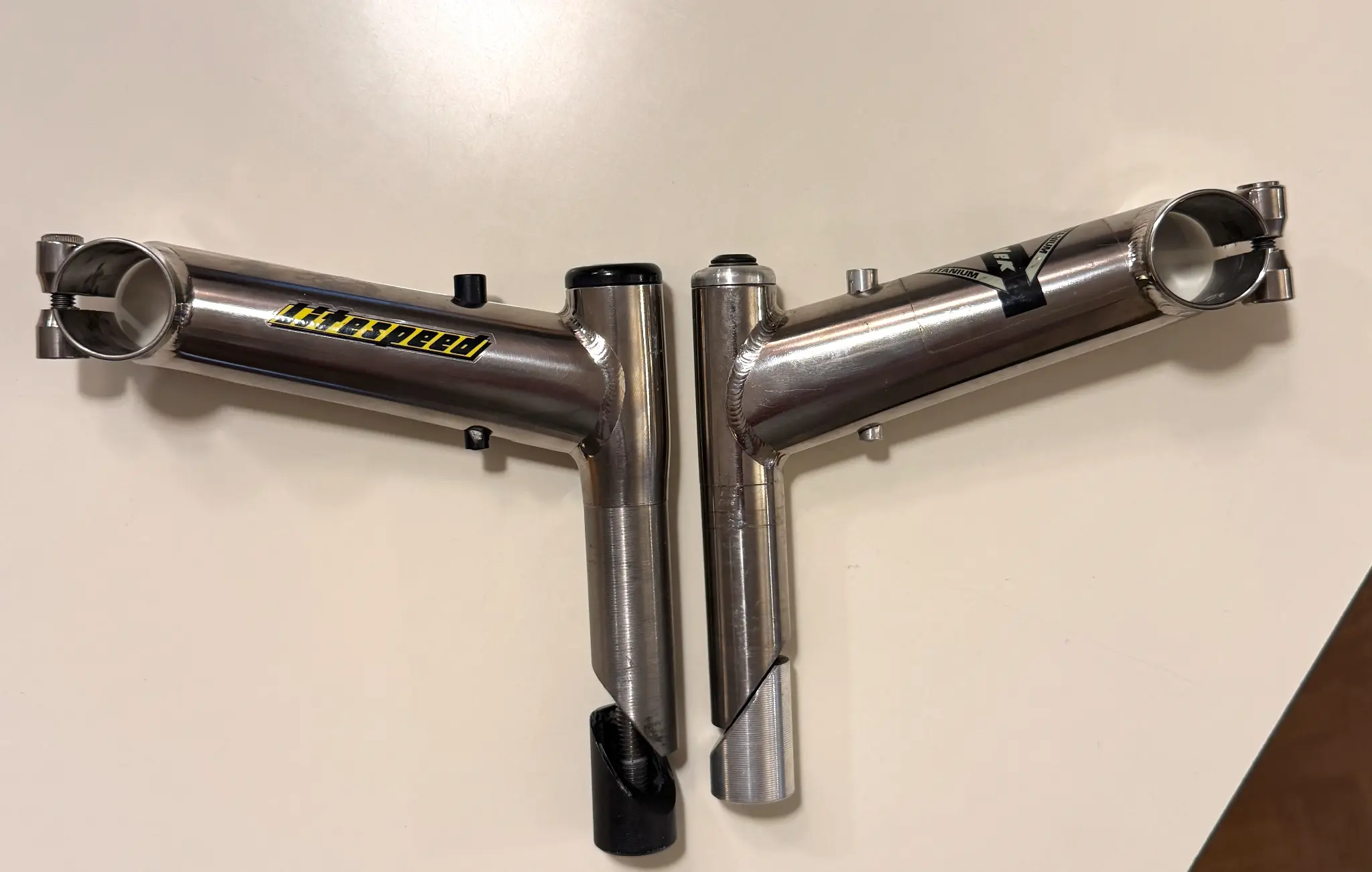

  • Earlier generation stem with the smaller diameter stem
Regards
Martin

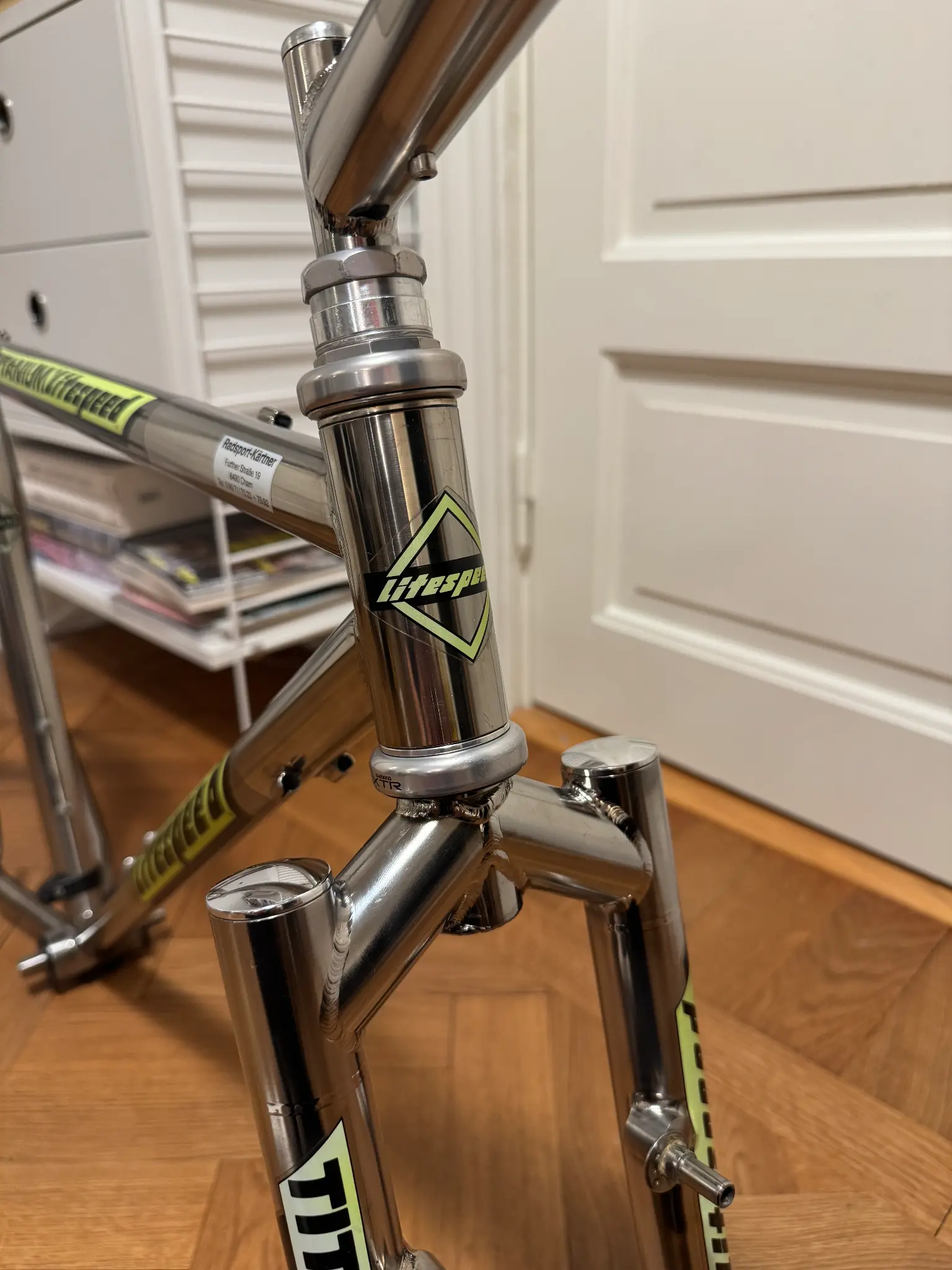

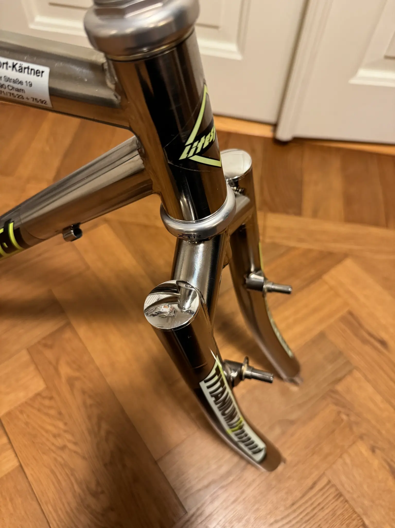

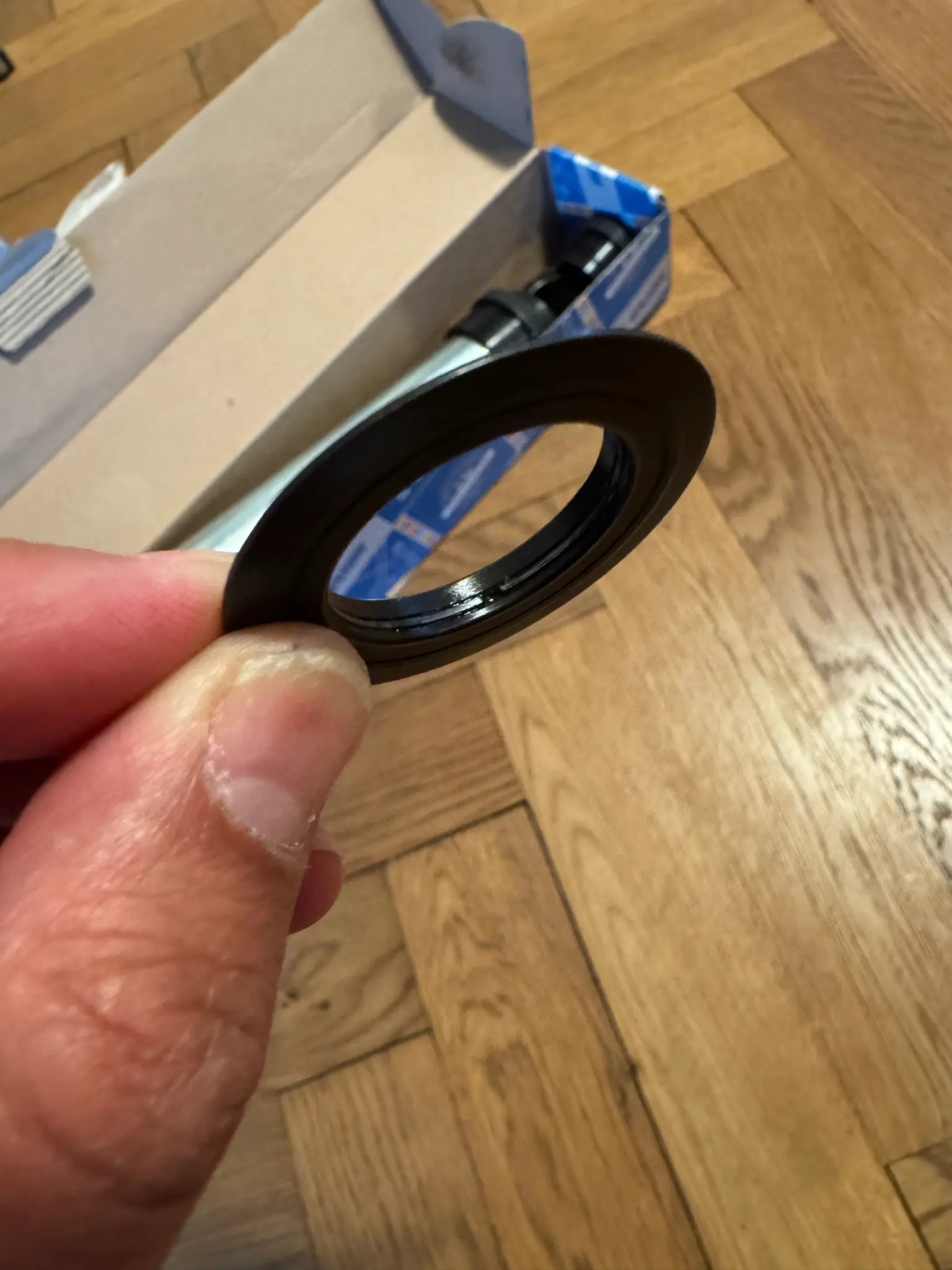

XTR M900 headset mounted. I hadn’t noticed before that the crown race actually has a retaining ring in a groove, nice detail!

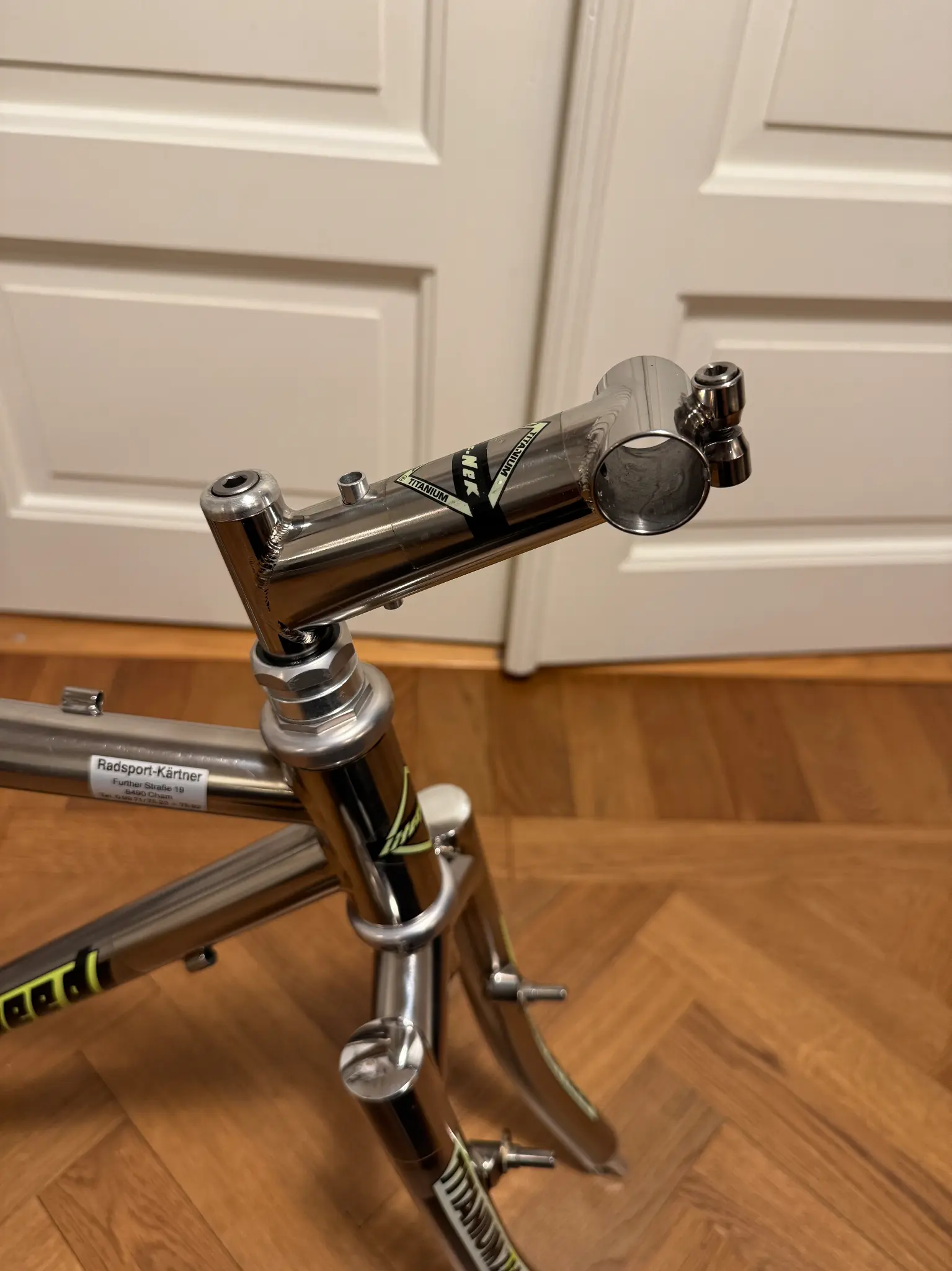

The steerer is slightly too long, but I don’t want to cut it, so I’m using a few spacers for now.

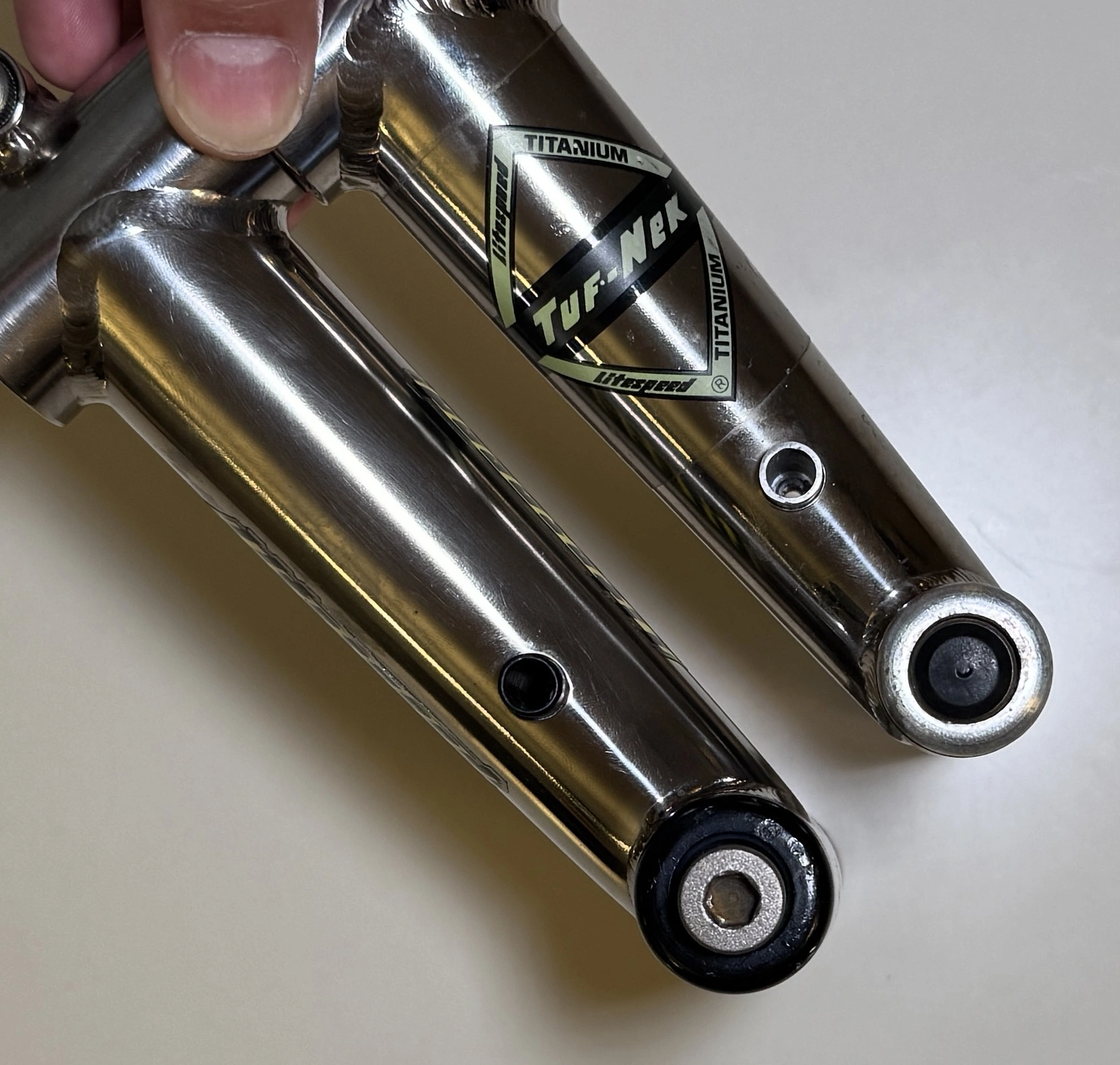

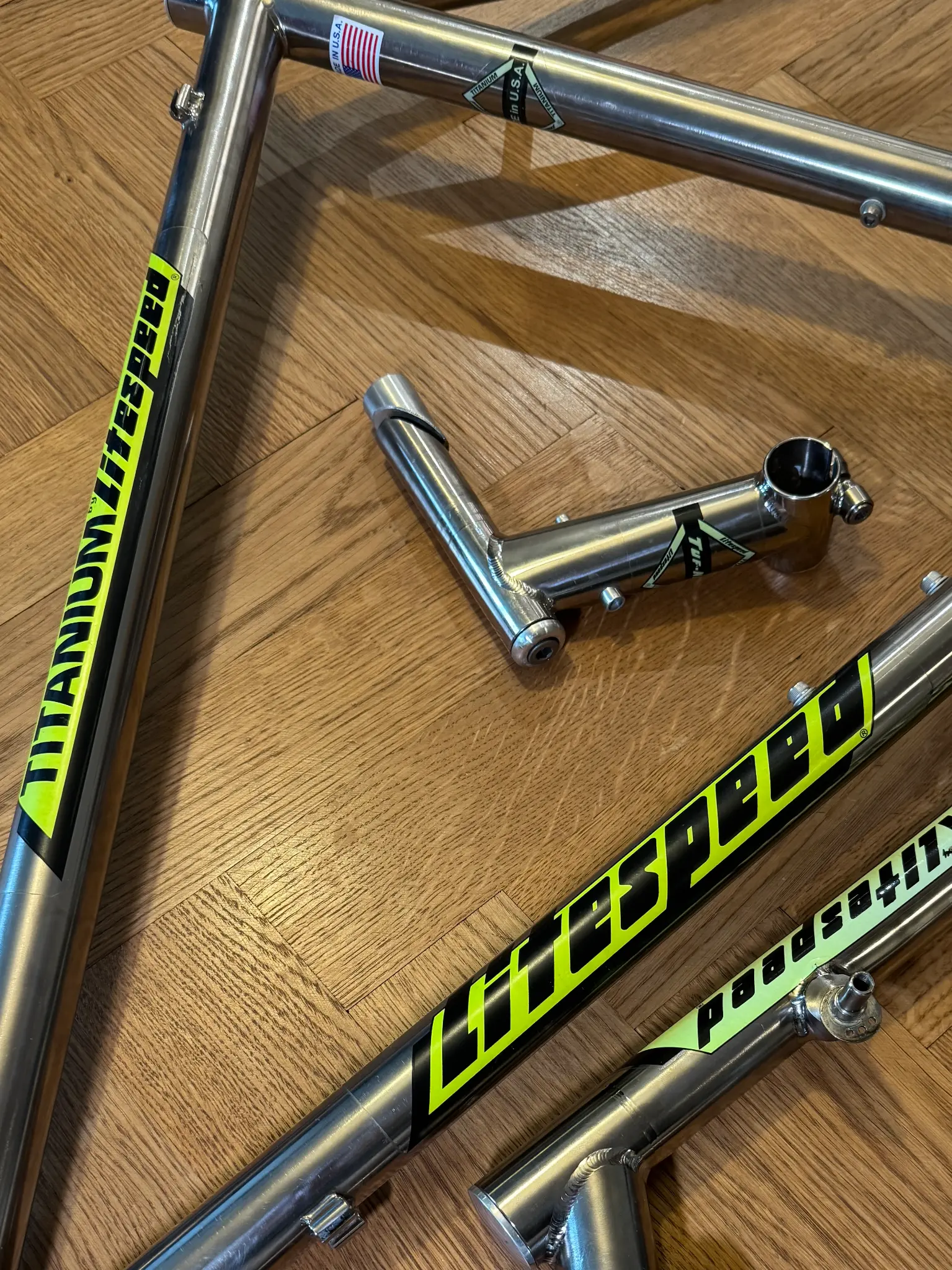

These Litespeed stickers are awesome

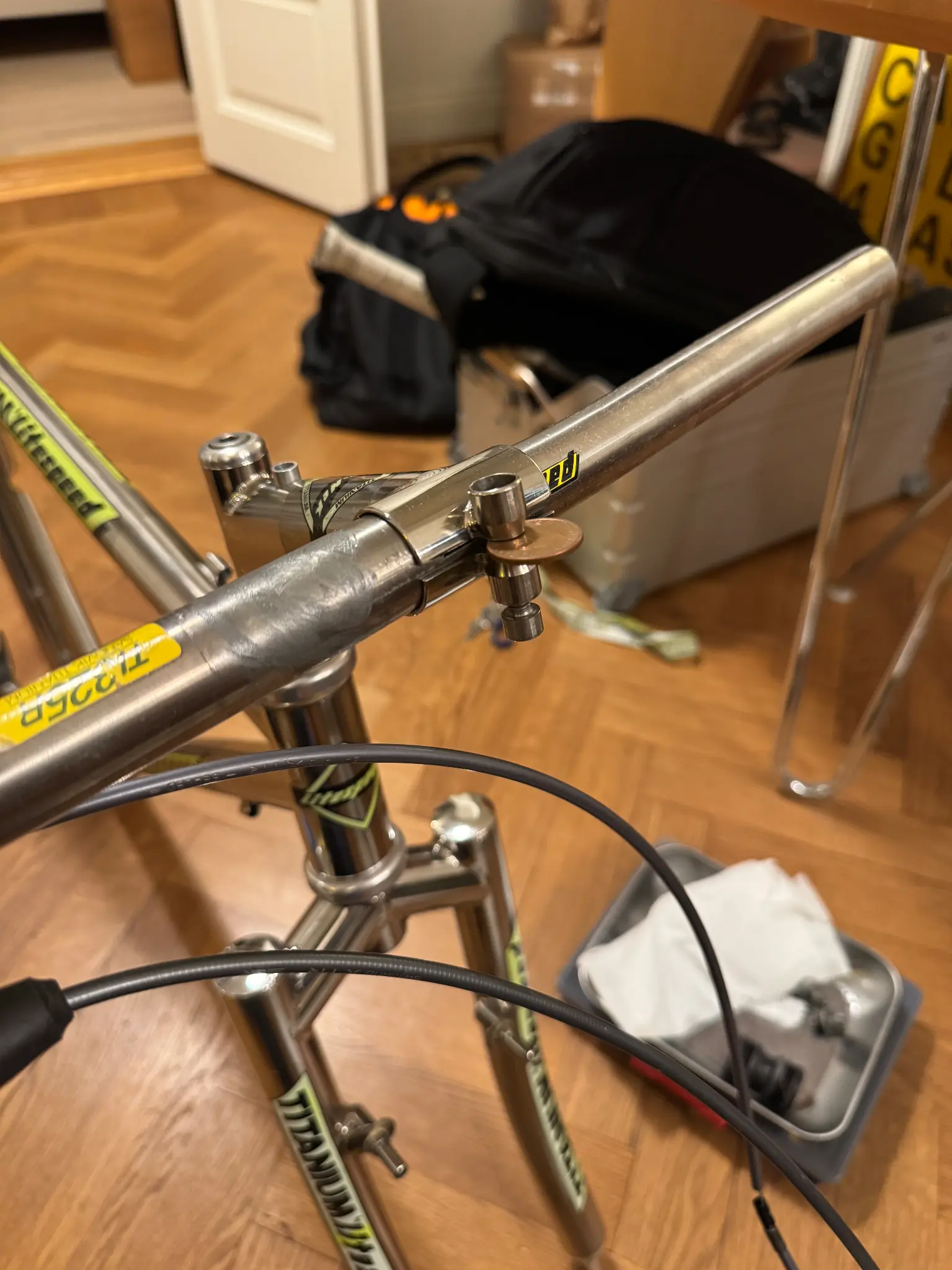

To get a bit more room for the handlebar to slide in, I sometimes put a coin in the split and tighten the bolt slightly to open it up a bit more.

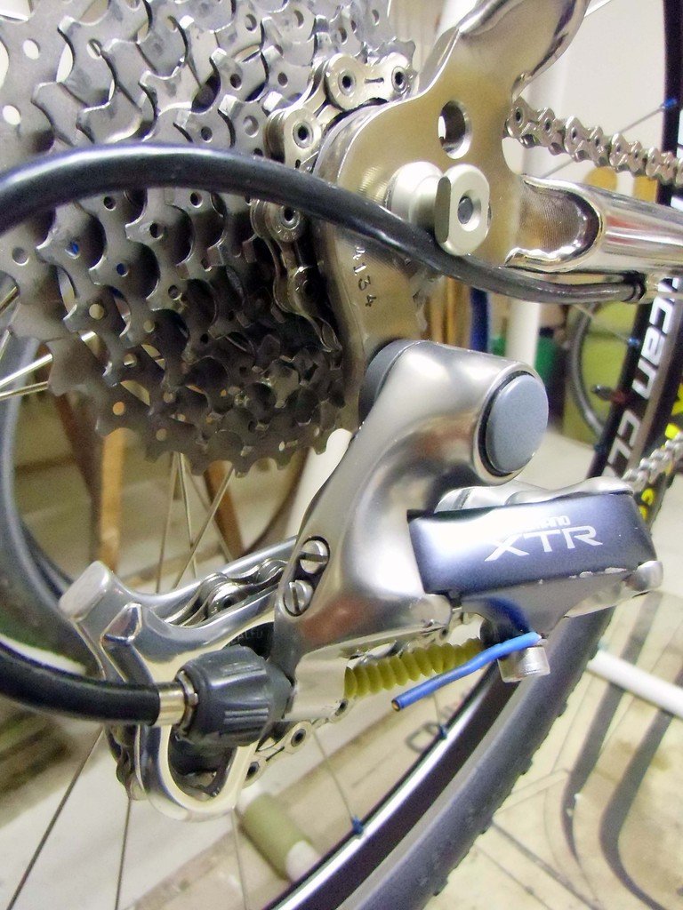

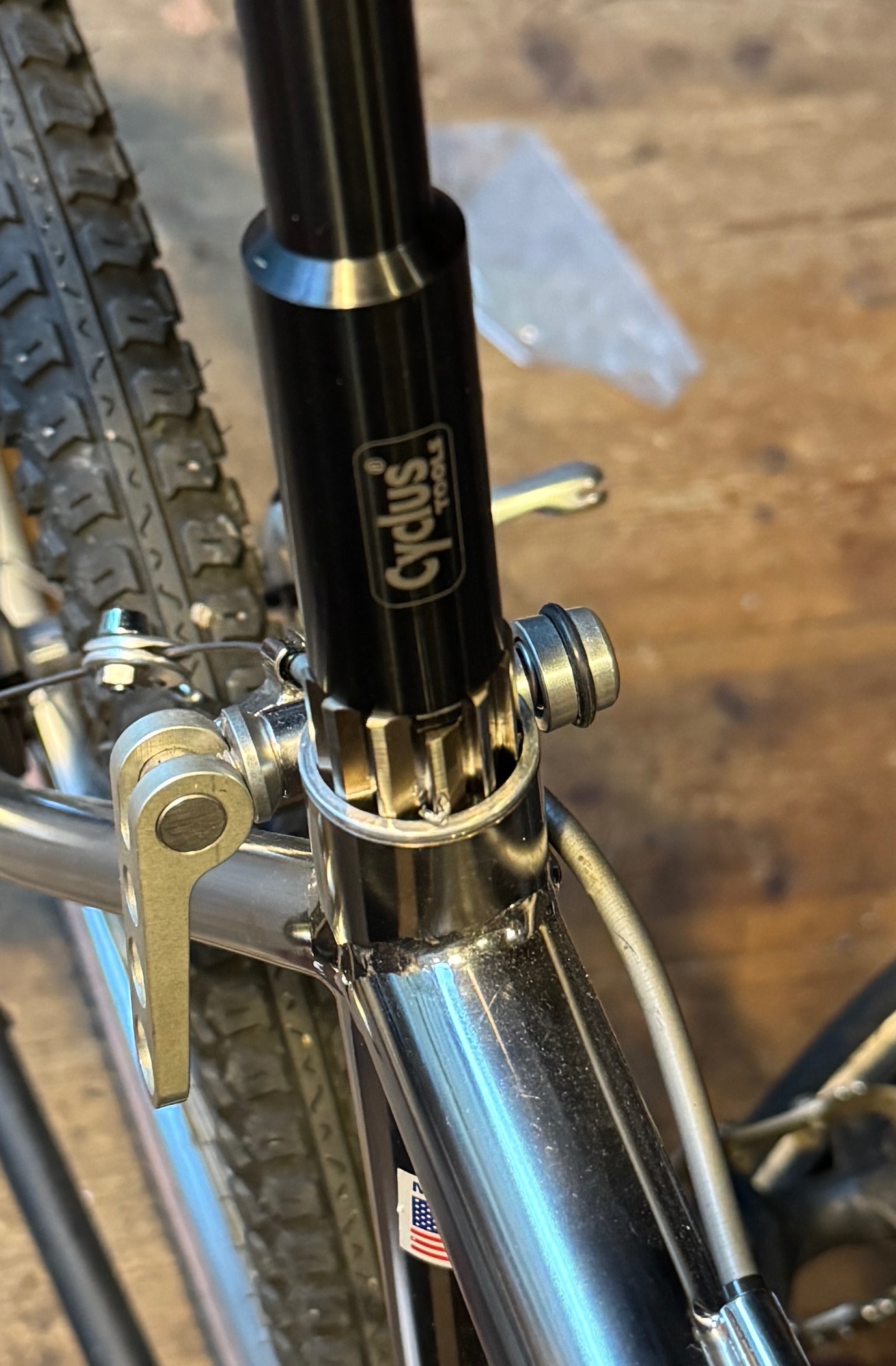

Ran into two small issues. First, this frame requires a smaller-diameter seatpost than the previous one. The bonded shim is 26.8 mm, so I couldn’t reuse my old post. Second, the previous frame had a different rear derailleur cable routing, which meant the existing gear cable housing was too short.
I really wanted to use an early Litespeed seatpost to match the rest of the build. Unfortunately, finding one in 26.8 would probably take ages, and when I was offered a 27.2 here in the forum, I decided to go for it. I therefore chose to ream the aluminum shim from 26.8 to 27.2. An easy job—taking 0.2 mm off in stages using a Cyclus reamer. The new seatpost fits perfectly.

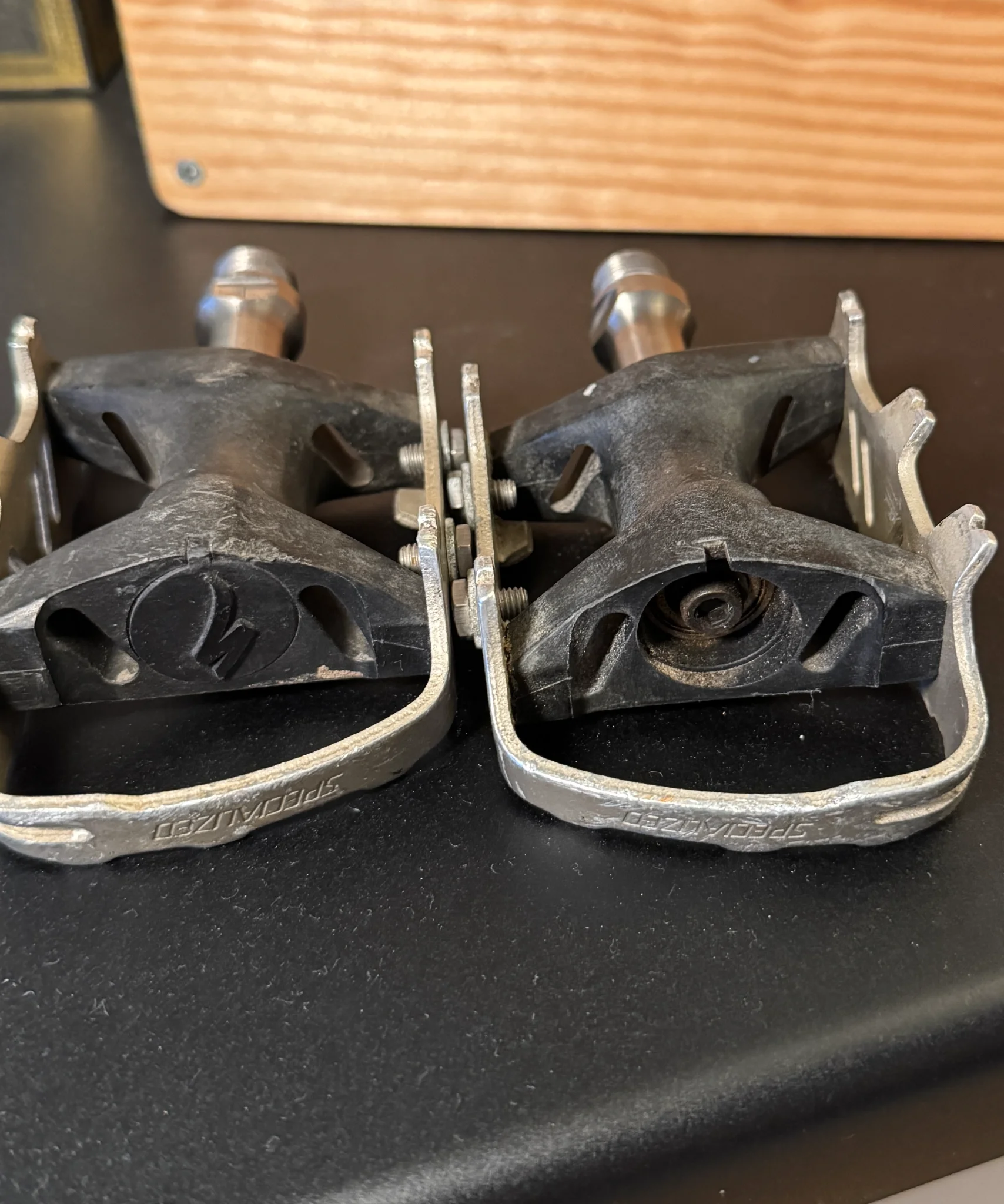

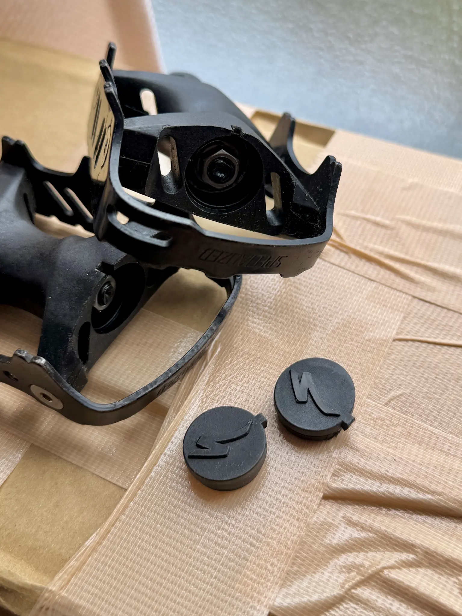

I've been missing both dust caps for a long time, but I haven't bothered to get replacements. Incidentally, the manufacturer of these pedals was MKS, which also had the same pedal with a steel spindle in its range under a different name. See here: https://web.archive.org/web/20240421141432/http://www.bikepro.com/arch_products/pedals/aspec.shtml
Yes it was from the lower tier steel version I found the replacement caps👍.

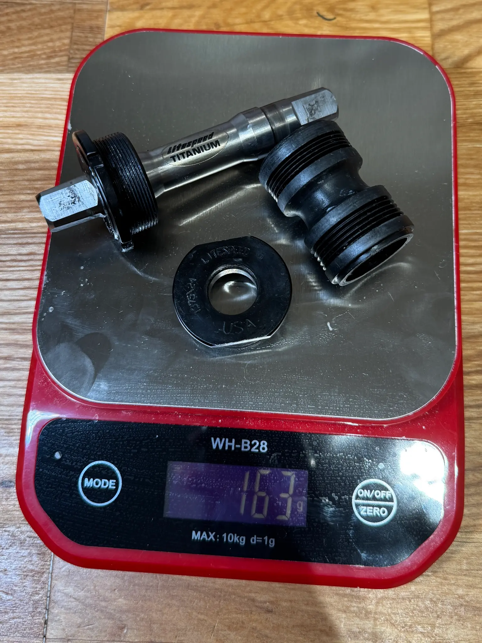

Litespeed bottom bracket weighing in at a whopping 163grams mounted.

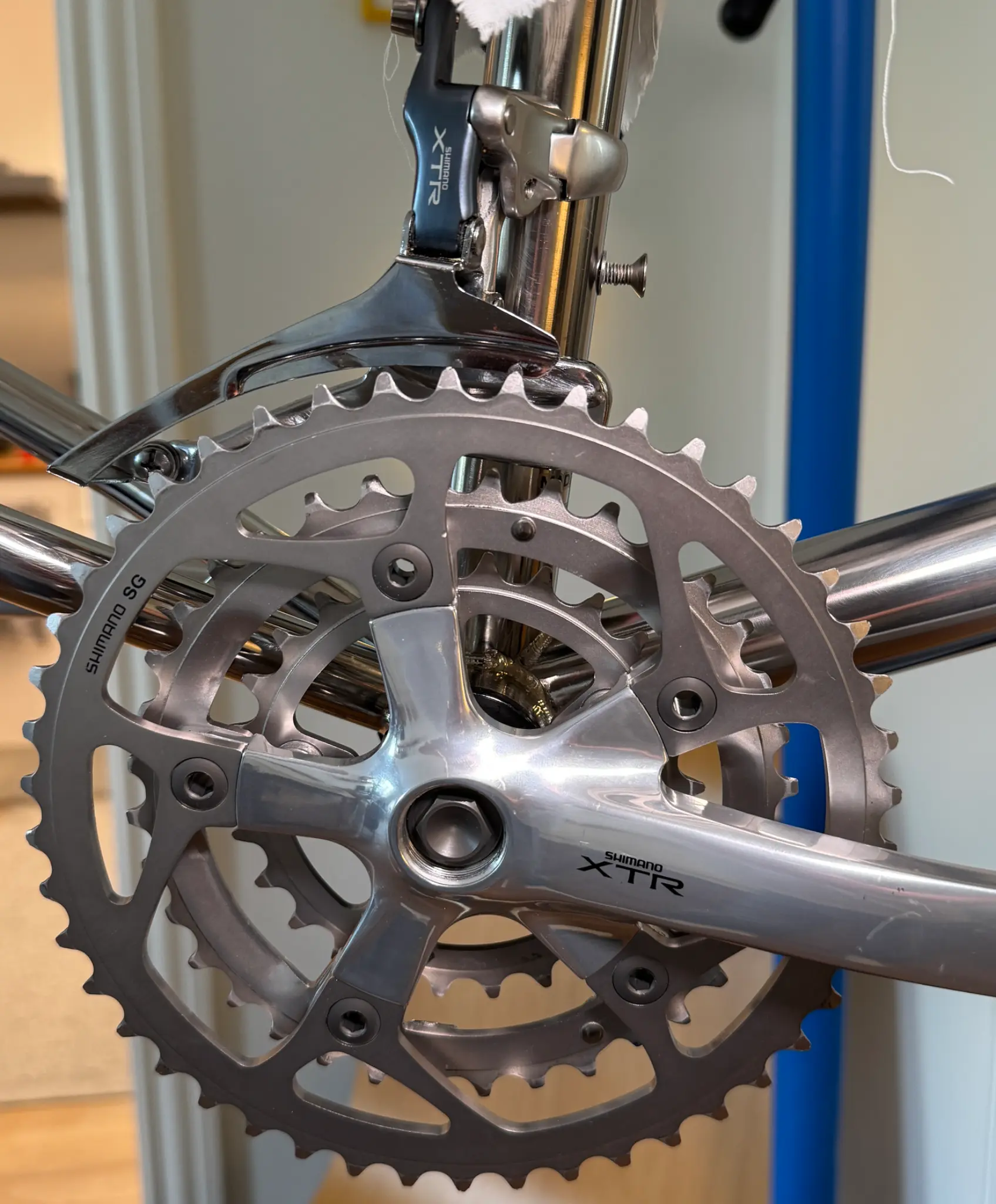

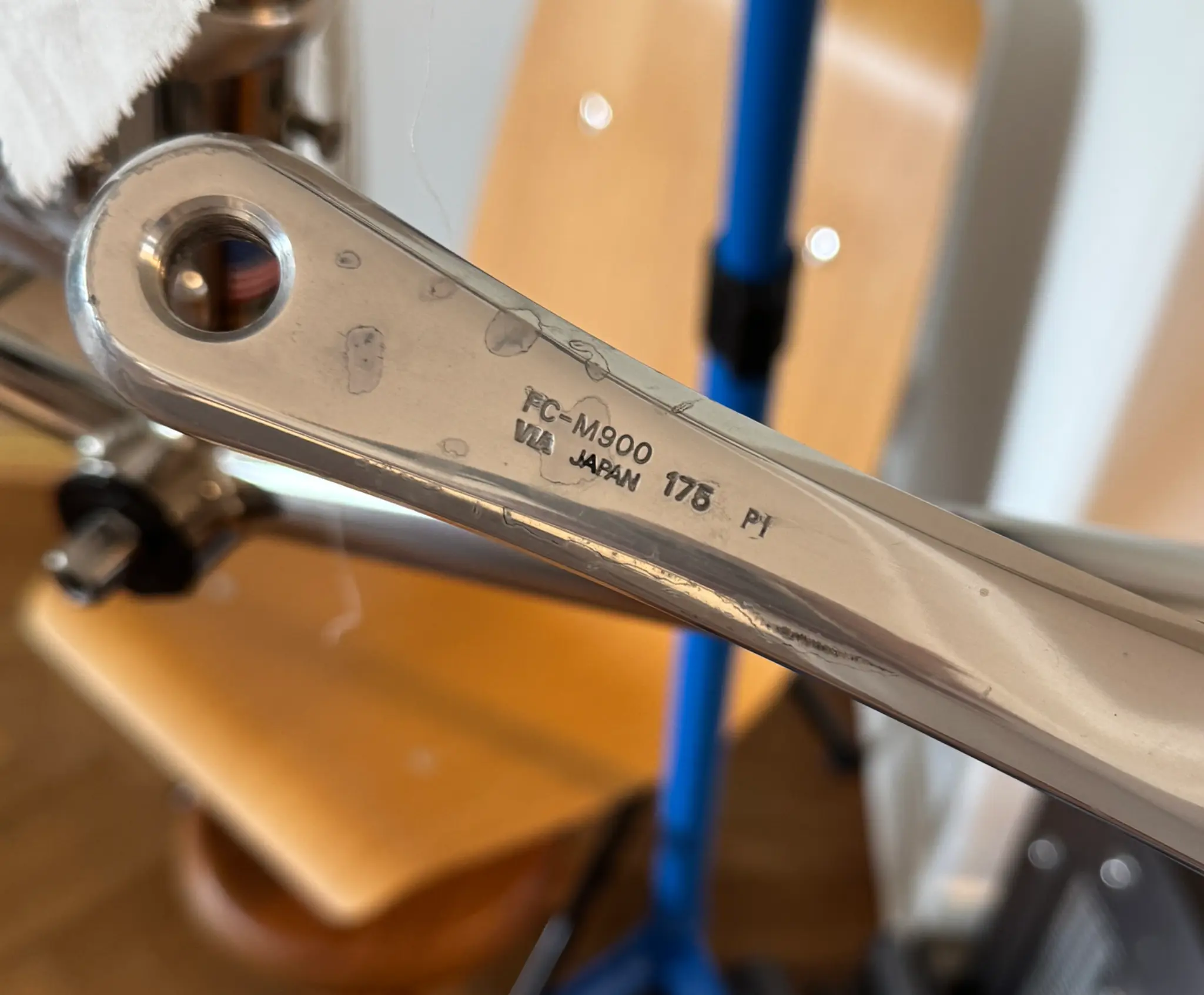

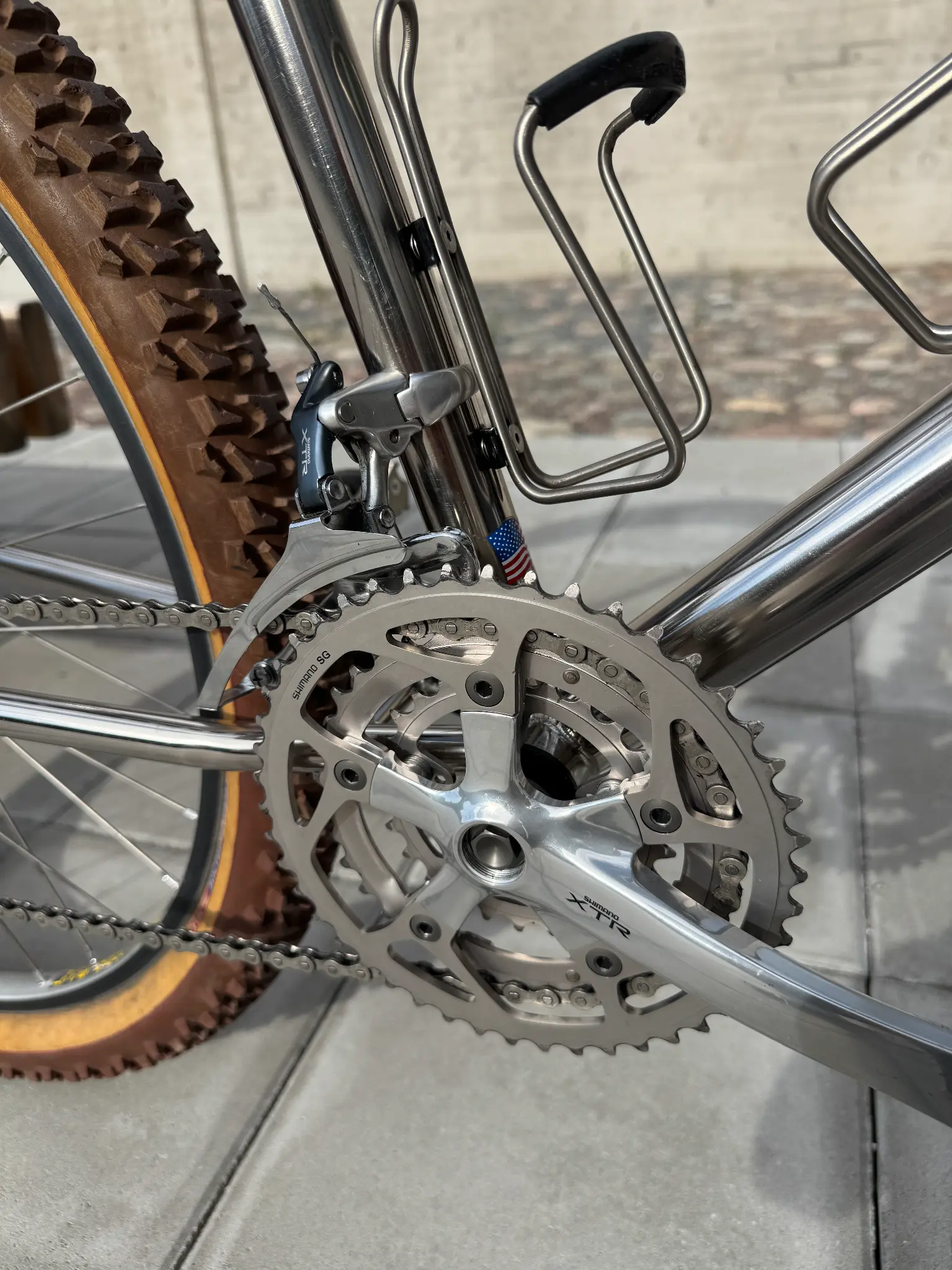

As mentioned earlier the full XTR M900 group has matching date codes stamped.
SRP titanium chainring bolts and SRP titanium crank bolts completes the crankset
