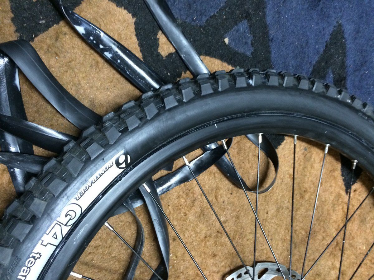

Ghetto tubeless, ueben fürs balance 27.5
