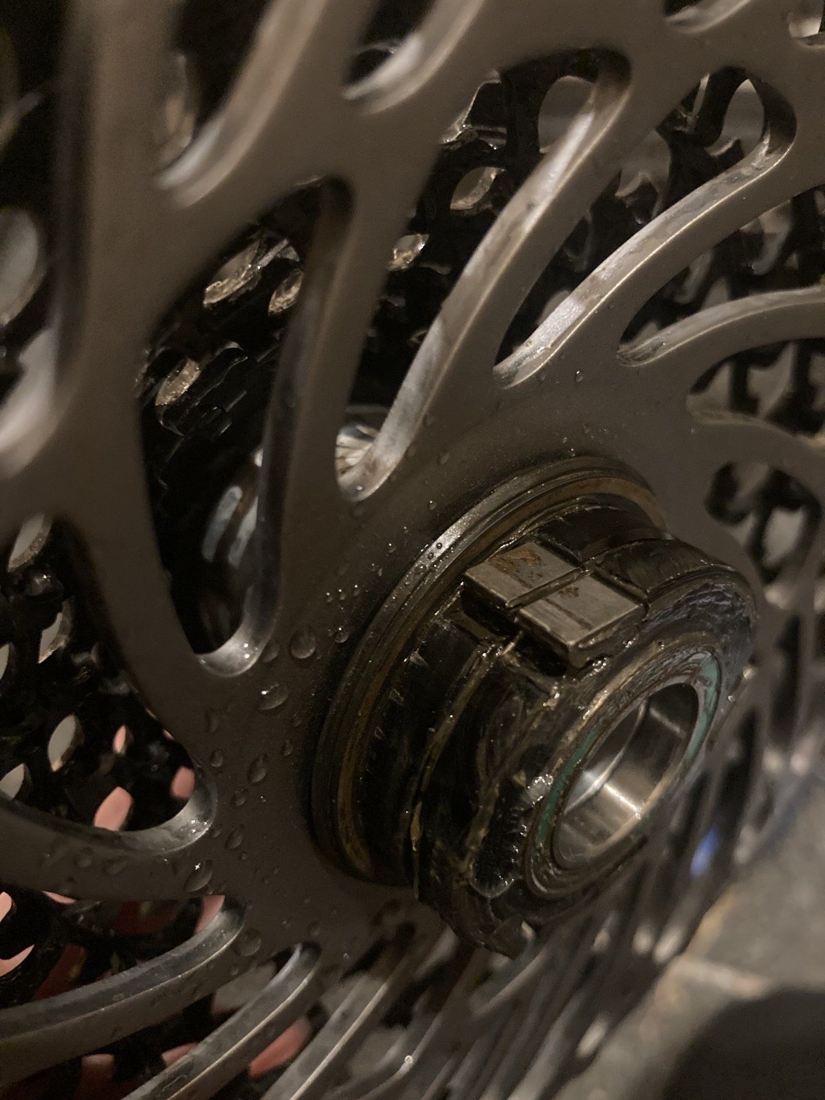

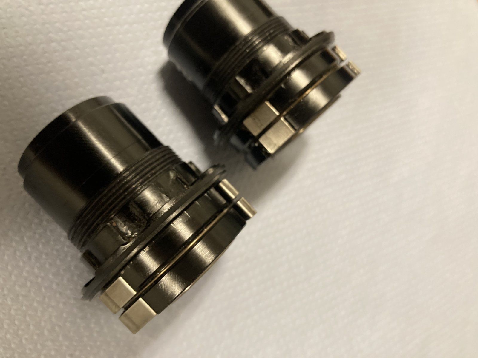

First is the marks on the free hub body. Newmen calls them "deflexion effect" and according to them they are working on the problem. On the other hand they say "it has not a negative effect to riding and so it´s not a warranty case". I think it is a major design failure and in time some metal detaches from the hub body for sure. My 3 freehub bodies has not been ridden much and they all have marks.
Even bigger problem IMO is the poor sealing. Water gets inside the freehub body very easily. It´s almost like there is no sealing at all. Every time I pull apart the hub it has rusty watergrease mix inside. These pictures are after few weeks of wet weather riding and few hose washes. I have seen them in a lot worse condition before I started to take them open frequently. The bearings goes quickly with these. Also rust starts to appear inside the hub. Pawls show signs of rusting very quickly. How many have looked inside their own FADE hubs?
