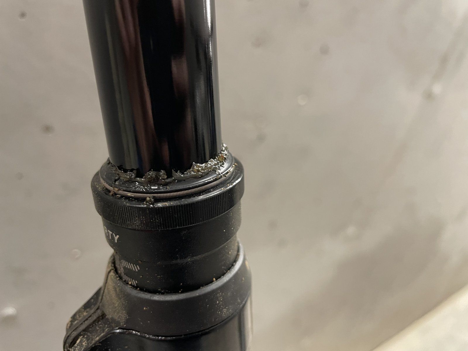

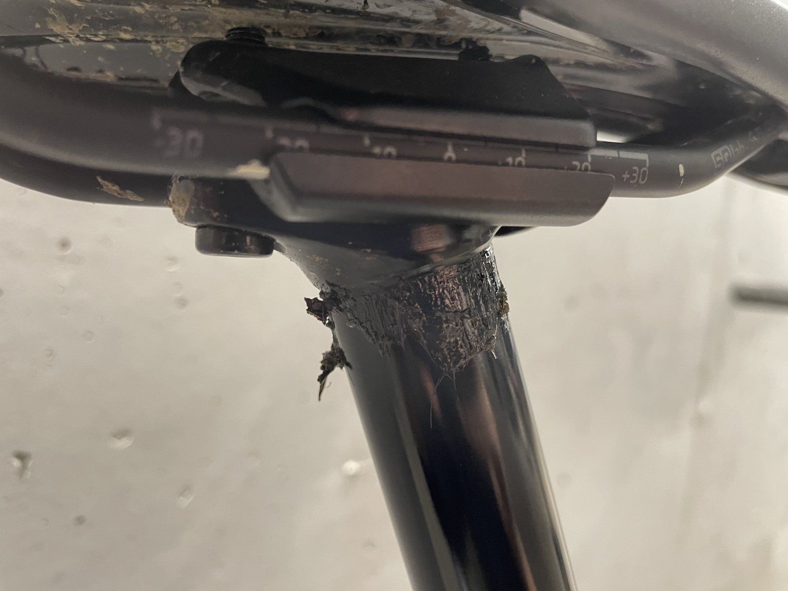

Ich habe vor einigen Tagen einen neuen Dropper von OneUp eingebaut. Heute ist mit aufgefallen wie viel Grease an dem Upper Tube verschmiert ist. Ist das normal am Anfang?
Ich hatte mit OneUp direkt Kontakt. Hier die Antwort:
Glad to hear you're stoked on the post, you'll be pleased to know that the excess grease isn't going to be a problem.
Sometimes our factory applies a bit too much grease during the manufacturing process. Once you start to use the post this grease will come up through the midcap assembly and present as in your photos.
Simply wipe off any excess grease, after a few rides it should settle and there should only be a thin film on the stanchion to help keep it running smooth.
If it continues to be an issue please open up the midcap assembly and have a look at how much grease is in there.
