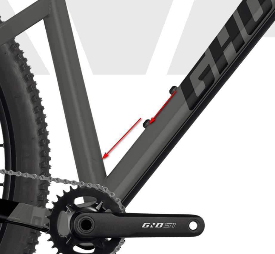

Hello all,
Firstly I would like to apologies for writing in english, but that is the only forum I could find on the Ghost tour. Hoping you guys would be ok to help me with my questions.
I would like to order a Ghost Nirvana Tour essential size M but I would like to have a small detail regarding some dimensions.
Could one of the bike owner could give me the exact size between the seat bar and the bottle holder holes and the space between the two bottle holder holes by any chance?
Please see the picture attached that would be much clearer than my crappy explanations
Sorry if this seems like a strange question ... and I thank you a lot in advance hoping someone could help me with that.
Thanks a lot !
This dimension are the dimensions of an advanced but i think they are similar. The size between the seatbar and the first bottle holder hole is around 9,5 cm, the size between the two bottle holder holes is around 6,5 cm.
Its difficult to measure without removing the bottle holder
Hope my english was okay

[QUOTE = "earlhansa, post: 16609090, member: 531947"]
This dimension are the dimensions of an advanced but i think they are similar. The size between the seatbar and the first bottle holder hole is around 9.5 cm, the size between the two bottle holder holes is around 6.5 cm.
Its difficult to measure without removing the bottle holder : D
[/ QUOTE]
Thank you so much for the quick and very clear answer Earlhansa! Much appreciated. Sorry again for not speaking german on a german forum

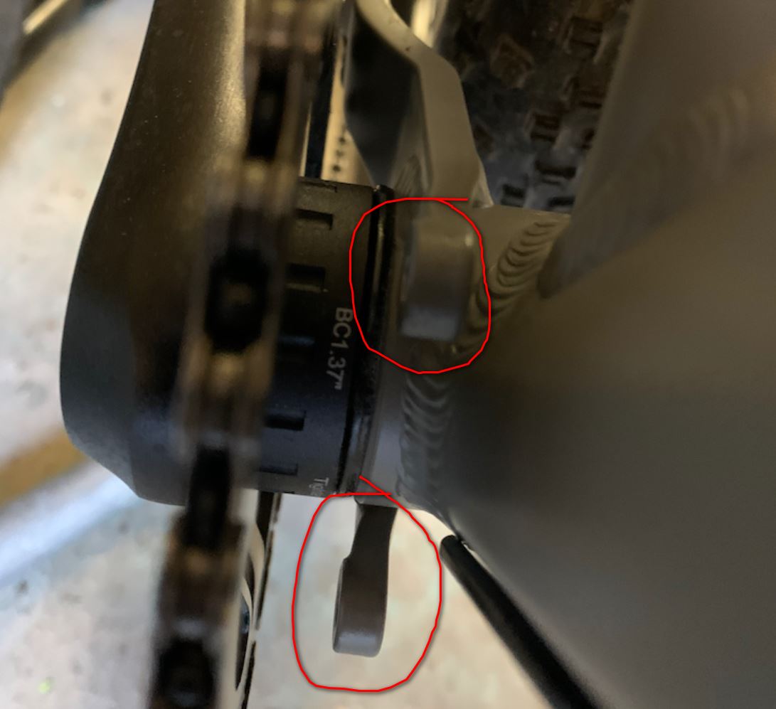

Does anyone know what are those two part by any chance? I never saw that on any other bike before.
Thanks a lot again for your help.
