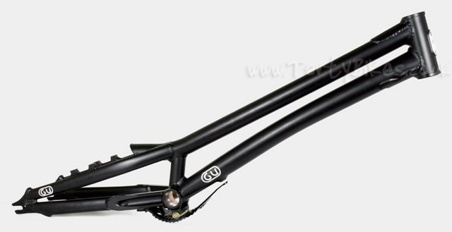

NEW ZM1BZM1-B ,1000mm, 358mm, BB-55, 71.5
NEW-B-2 ,1000,358,BB-60,71.5 (bashguard)
NEW-B-3 ,1020,358,BB-55,72
NEW-B-1(135MM) ,1078,380,BB-30,71.5
