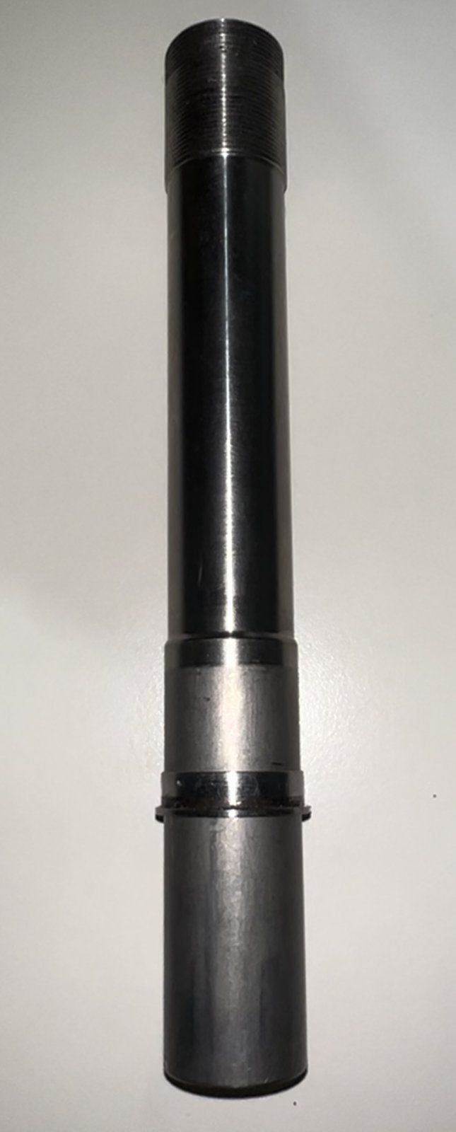

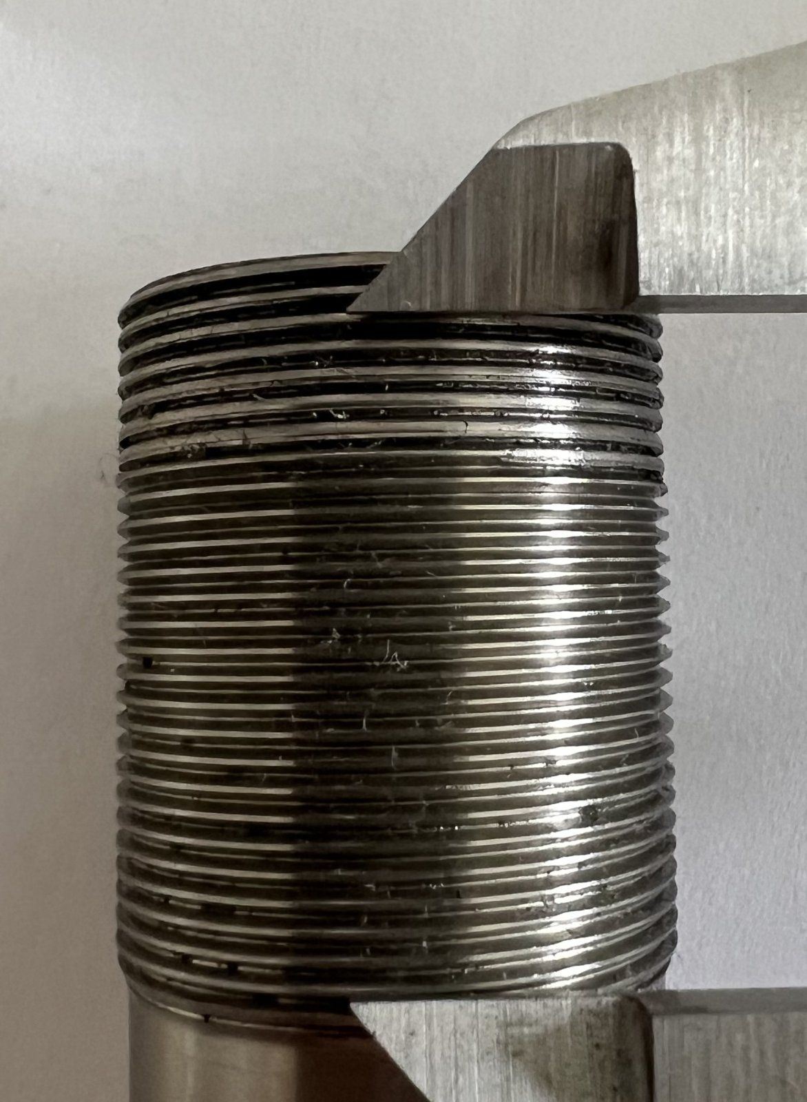

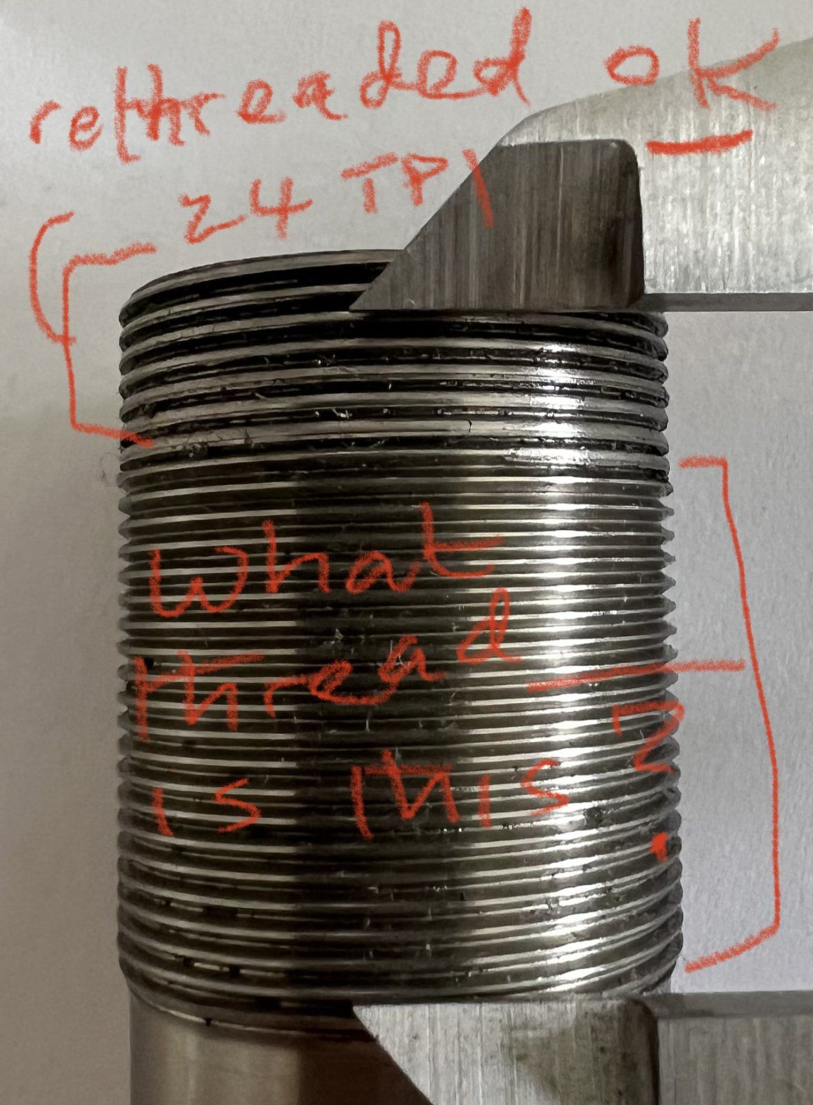

Hi, I bought a Tune 1 inch Titanium threaded steerer from Jenny Christian on ebay a few years ago. I assumed wrongly it has British 24 TPI threads but when I came to fit it, it doesn't fit British 24 TPI headsets. I have asked the seller a few times on Ebay and had no response, also he does not state what thread type it is in his listing !!! I have tried to re-thread it ( see at the top of the thread ) but Titanium is too had to recut 🤔
Has anybody got one like it and what thread does it use please ?
Thanks,
GB

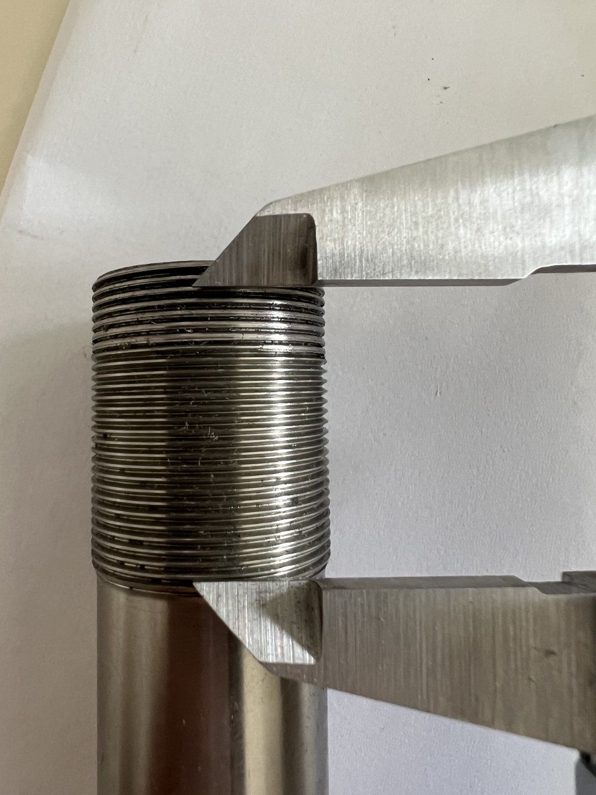

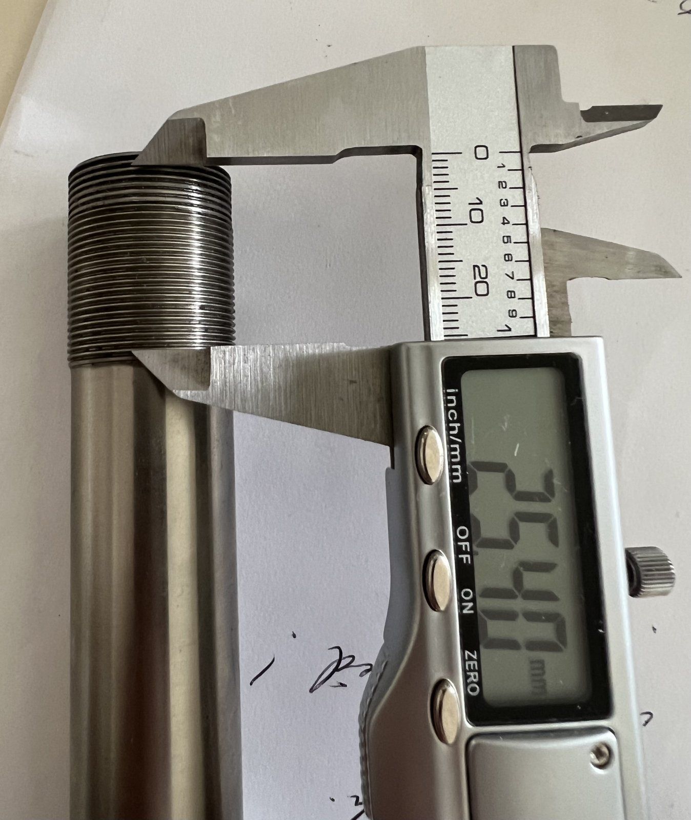

Excuse me,
but two pics are not enough information: what diameter has the threaded part and how many threads do you count in 10mm or 25,4mm length?
Regards Frank

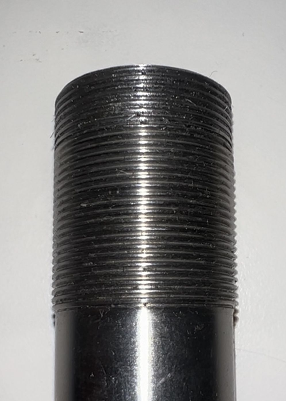

Thanks for your help 🙂 Its a 1inch diameter threaded Tune Ti steerer. There seems to be less threads per 1 inch than I was expecting. You can see from the top section that the 24 TPI Thread cutting tool I used tried to recut the threads to English 24 TPI threads does work now. However, the English thread Chris King and Campagnolo headsets did NOT fit this steerer before I used the cutting tool and wont fit this steerer section below where I have NOT rethreaded it ( labelled what thread is this in picture ? ) . I was wondering if Germany/Tune uses a different thread or is it French or Italian thread ?
I cant rethread it any lower ! but will but a different headset if I can find out which one to use. Hope this makes sense.

I cant recut the threads further down anymore anyway. The section that has been recut at the top does fit an English 24 TPI headset lock ring. It looks bad but it does work 👍 However, I dont want to force the thread cutter all the way down. I just want to know what thread specification he has cut this steerer to on his lathe.
