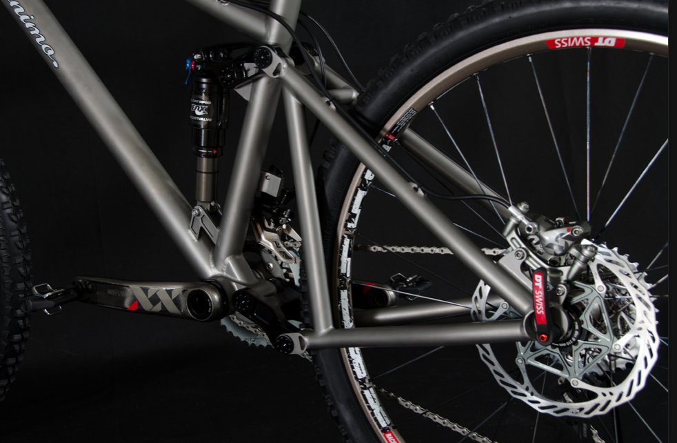

Antonio OSUNA (der auch das interessante Blog "Linkage Design" führt) von JERONIMO Cycles (Namensgeber ist Pedro JERONIMO) hat mich gebeten, noch ein paar Informationen zur Firma und zu dem neuen Modell JERONIMO "Chabardo Ti 120 AVP - JRF" (siehe oben in nuts´ Bildergalerie und im JERONIMO Cycles Flickr-Fotostream) hier einzustellen. Ich denke, dass ich diese gleich ohne Übersetzung in Englisch bringen kann.
JERONIMO Cycles is a small bike manufacturer located in Santa Cruz de Tenerife, Canary Islands (Spain) that exclusively designs custom titanium frames. Someone could say that our custom hard tails are similar to other brands, and that’s probably true, but our full suspension models are really special because the system’s kinematics are custom tailored, too. That’s something that you don’t see everyday, and the main reason why we use titanium. You can’t do that grade of customization with carbon fiber.
The C120 model that you can see in the pictures uses a virtual pivot system that can easily be tuned. The lower link configuration gives us a lot of freedom, so we can play with it and adjust the amount of anti-squat needed in each case. Tall riders need around 25% more anti-squat than smaller riders, and you have to take all the gearing possibilities as well as the fitness level of each customer into account. Sometimes the difference between two riders is huge and that's why you can't make everyone happy only with one standard configuration.
The leverage ratio is a very important parameter, too. We take into account the customer´s riding style, the body weight, and the type of shock that we are going to use.
This special C120 model shown in the picture gallery for example was designed to fit a tall rider, not very aggressive on DH, who wanted to use a 2x10 gearing...
But anything else is possible, it’s a 100% custom design!
Frame specifications:
• 3Al 2.5V titanium main frame and rear swingarm.
• 7075 aluminium alloy links.
• Custom geometry based on a biomechanical study that was performed by Custom4Us for JERONIMO Cycles.
• Custom suspension system.
• 120mm of travel. 190x50 shock (FOX RP23).
• 44mm headtube (compatible with tapered forks).
• BB30PF bottom bracket.
• Direct-mount front derailleur.
• 4 sealed bearings within each pivot point (16 in total).
• 15mm aluminium alloy axles.
• Frame weight 2.95 kg (size XL).
• Lifetime warranty.
Das beschriebene Ausmaß des Customizing - mit maßgeschneiderter Hinterbaukinematik durch Feintuning der Hebelage (hier: unterer Hebelarm des Systems mit virtuellem Drehpunkt) zur Anpassung des Anti-Squat - ist mir von keinem anderen Hersteller bekannt. :daumen:
Eine Kommunikation mit Antonio und Pedro von JERONIMO Cycles ist hier im Forum in Englisch, Französisch und – natürlich – Spanisch möglich.
According to this current thread at MTBR.com I became aware of recently, the price point at least of the model "Chabardo Ti 120 AVP - JRF" (with all extras: dropout with replace hanger, downtube bending, headtube for TR44, direct-mount FD, BB for Press Fit BB30) is € 3,200.00 (without shock). To reply the specific query regards the "Chabardo Ti 140 29" AVP", the guys of JERÓNIMO Cycles should chime in now.
