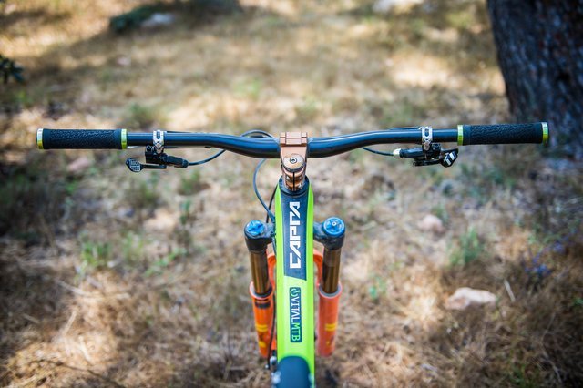

Specialized Fuse / Ruze
TRP plus Sram ( Matchmaker )
http://m.vitalmtb.com/product/guide...TRP/Quadiem-G-Spec,18662#product-reviews/2742
