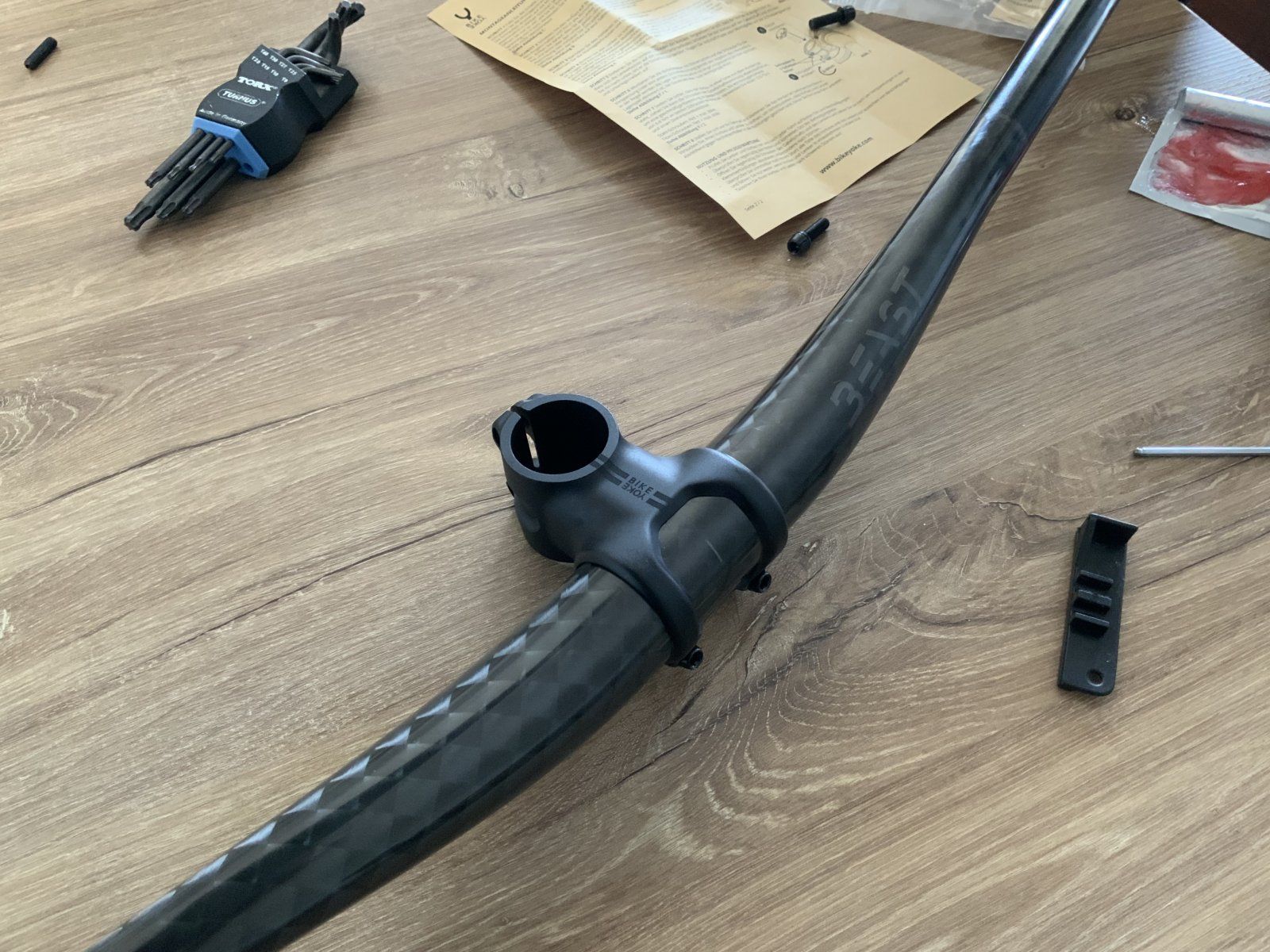

Beast Components Carbon Riser Bar 25 2.0 passt👍🏻
