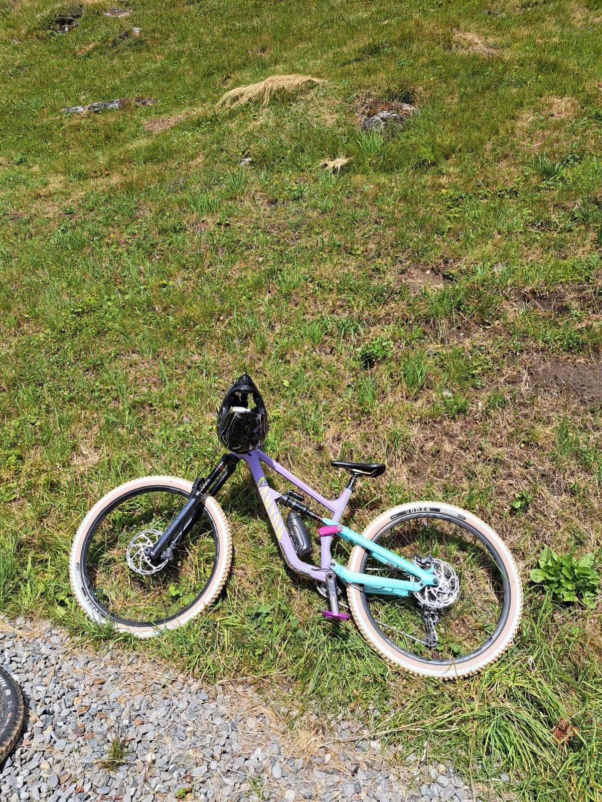

Hey Peter,hello,
I am looking to buy the Torque 29 AL 6 in the color Dijon.
Does anyone have real life pictures of this bike, not quite sure about the color
and are there many problems with cracking noises in the alu frame?
