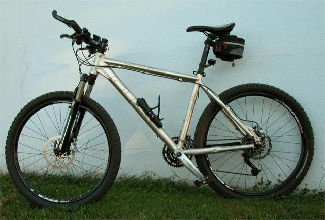

Der Hinterbau von meinem LTD CC 2005 war komplett anders, der vom LTD CC 2006 bin ich mir nicht mehr sicher, aber ich meine an den Sitzstreben oben ist er über ein Rohr verbunden, die LTD und Reaction 2006 haben alle ein X-förmiges Flachprofil.
Foto folgt..

Well, actually there are already some shots of my bike in the gallery, just have a look. I didn't take any shot of the bridge between the seat stays, but on the first pic you can clearly see that the CC frame does indeed use an "acid" style tail end, including more conventional (non-3D?) rear dropouts. The bridge is also that tube-shaped element you can find on the blue LTD Pro on their website.
I guess that clarifies things a bit. Apparently they were using the standard frame for the LTD CC, which makes it about 200g heavier. On the other hand, they are using fairly light weight components like the REBA fork (which should save you at least about 400g over a coil spring fork like the TORA they use on the LTD TEAM) and the XT crankset, that should easily off set the weight penalty. At one point I also considered the LTD TEAM - the dealer weighed both (same frame height) and the TEAM was considerably heavier than the CC.
