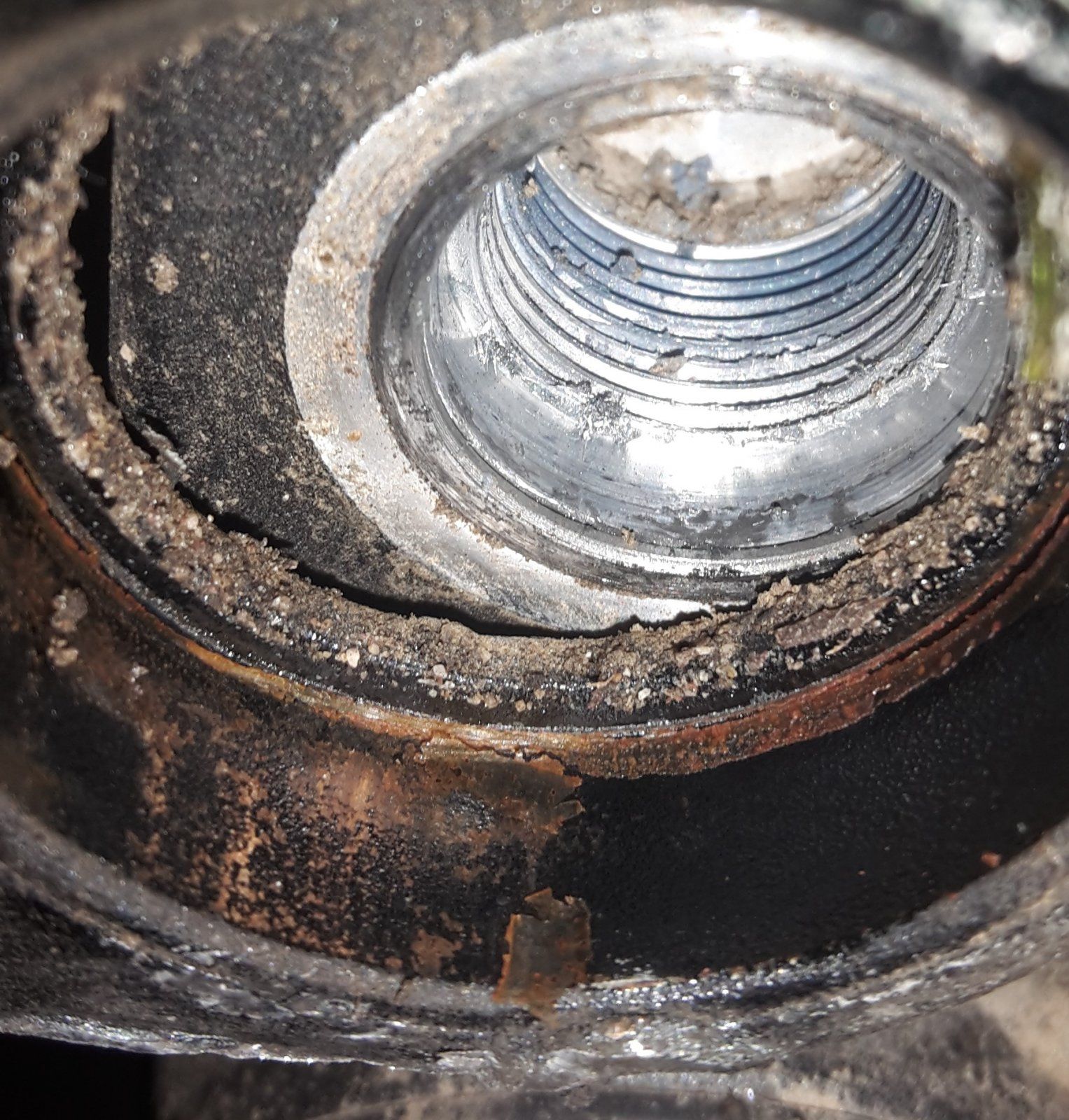

- I also had creaking at "horstlink screws" on my 601 Mk4 - remove, clean, loctite on thread and grease on contact surfaces - problem gone (as
IBEX73 said). From Liteville it comes just with loctite without any grease on contact surfaces.
- It is also possible that some bearings doesn't fit correct (too big hole in frame - not in correct tolerance) and they move a little - I think it is more of a problem on anodized frames (because some material go away when anodizing + loctite doesn't hold as good on anodized surface - Liteville should machine bearing seats to tolerance after anodizing....). I had this problem also on my 601 Mk4 (bearings near bottom bracket) - Liteville repaired frame: bigger hole in frame + "oversize" bearing (bearing with different tolerance).
mokka_: All looks the same just different tolerance on bearing and bearing seat in frame to get different more secure fit (I didn't get exact information on bearing tolerance....). Problematic were bearings on chainstay near Bottom bracket - when I unscrewed a bolt, bearing came out together with bolt - without any special force....there was also loctite from factory but it didn't hold - frame was 6 months old.
