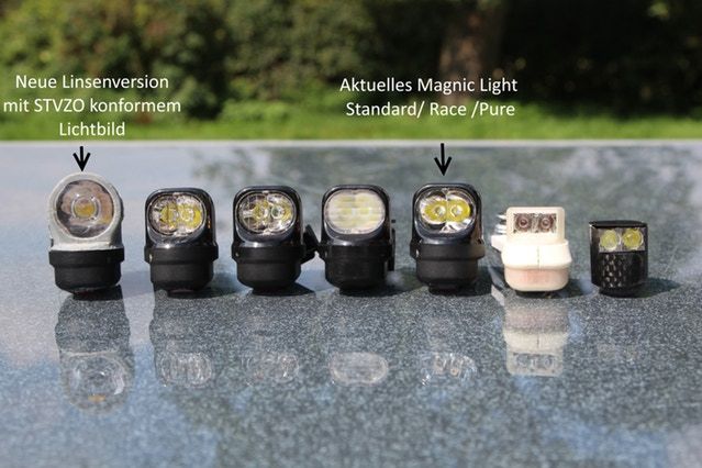

"Here we present features of the new Magnic Light iC with steadylight & brakelight.
Magnic Light iC has four different user-selectable operating modes:
Mode 1: Constant driving light & constant steady light
Mode 2: Constant driving light & Constant steady light & brake light (two LEDs are flashing alternately when speed is reduced significantly)
Mode 3: Constant driving light & flashing steady light & brake light
Mode 4: Flashing driving light & fast flashing steady light & brake light (two LEDs shine constantly when speed is reduced significantly)
(Even mode 4 is suited for the frontlights because the in the cyclists focus light remains constant- flashing is only visible outside of the beam region).
When the bike stops the steady light will shine for 4,5 minutes. When speed is reduced significantly a brake light signal is emitted (two LEDs are flashing alternately in Mode 2 & 3 resp. two LEDs shine constantly in Mode 4).
You can switch between the four modes (from mode 1->2->3->4->1) by turning the wheel for some seconds as follows: After you have stopped for 10 seconds a short signal (steady light of the following mode) is shown and you can switch to the next mode: Turn the wheel quickly and stop after another signal is shown (example is in the vido). It is possible to turn off the switching process completely (reversible). We recommend to choose your favourite mode and then turn off switching: Wait for the signal at the end of the steady light (after 4,5 minutes), turn the wheel quickly and stop after signal is shown. Lights can either be fixed by a click adapter for fast exchange or by a fix anti-theft adapter with anti-theft screws and tool.
We are delayed with shipments of preorders due to production problems which now have been solved. We plan to ship all all preordes within the next 6 weeks."
"In standard mode (1) the lights don't flash and have no brake light function. Light power for all modes is identical (when cycling). Switching between different modes is only possible with loaded capacitor (cycle ~1 minute before switching). You have to stop and then turn the wheels (with lights attached) as shown in the Switch- Sheet. You may also lock your favourite mode or unlock. The chosen mode is stored in memory - so it won't be forgotten when the lights turn off. You may configure all lights (front light & rear light) as you like.
A video + a longer version will follow soon. For the moment I hope this short sheet will answer the main questions"
