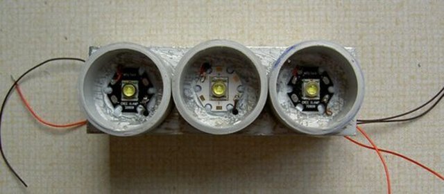

Hi, here my new triple light, very, very easy of doing, how you can see, I hope that like us
I have used a square tuve of 40x40mm and PVC tube of external diameter of 40x40mm too.
Now glued the PVC tubes to the aluminium tube
Inside view, I have used too a "custom" inside heatsink how you can see
Glued the 3 leds to the aluminium tube (I have used 2 Cree Q5 and 1 Cree P4, I know that have was better use R2 leds, but was that I had

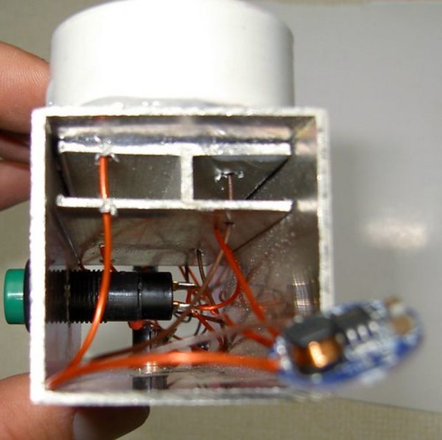

I make holes in the square tube and I have soldered the cables...
Now I have solder the cables to the swich, drivers and power conection, I have used 3 drivers to can use a battery of only 7,4 volts

I have isolated the driver with....(sorry, but I don't know how it say in english "manguera termoretractil") :madman:

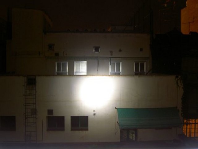

Well, I still don't have ended the light, already don't have put the lateral caps, but I hope ended soon and put any beamshot
