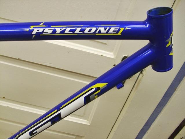

1998 18" GT Psyclone 4lb 1 oz or 1817 grams
