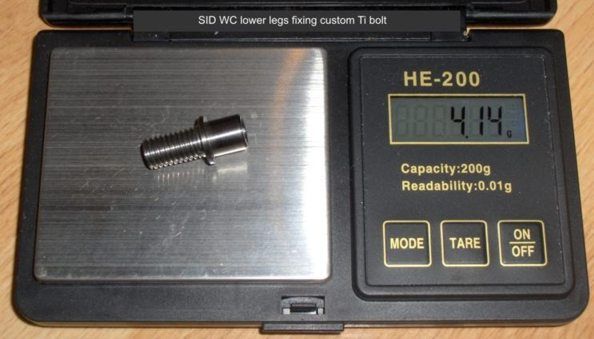

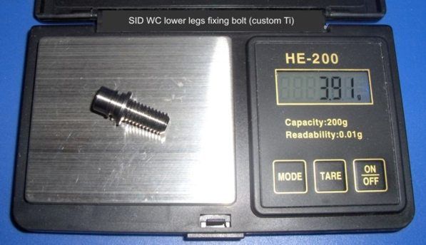

Hi,
My friend made two Ti such bolts for me. They are drilled out so you can still use damping compression adjuster if you want. Enjoy the pics!!!
