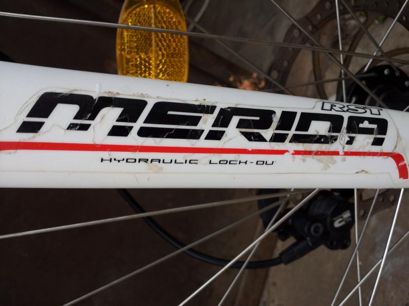

Thanks for the answer, my fork is a litte differ but i attache some picture to see if she is gila ml because of she it write hydraulic lock-out
Dear marusy80,
the fork has a mechanical lockout, the stikcer of the fork is wrong.
The fork looks like it could use a service ;)
The RST_EU_Team.
Thanks for the answer, i think that the sticker is wronk because i see the sistem in the service manual from the site and it look like gila ml
