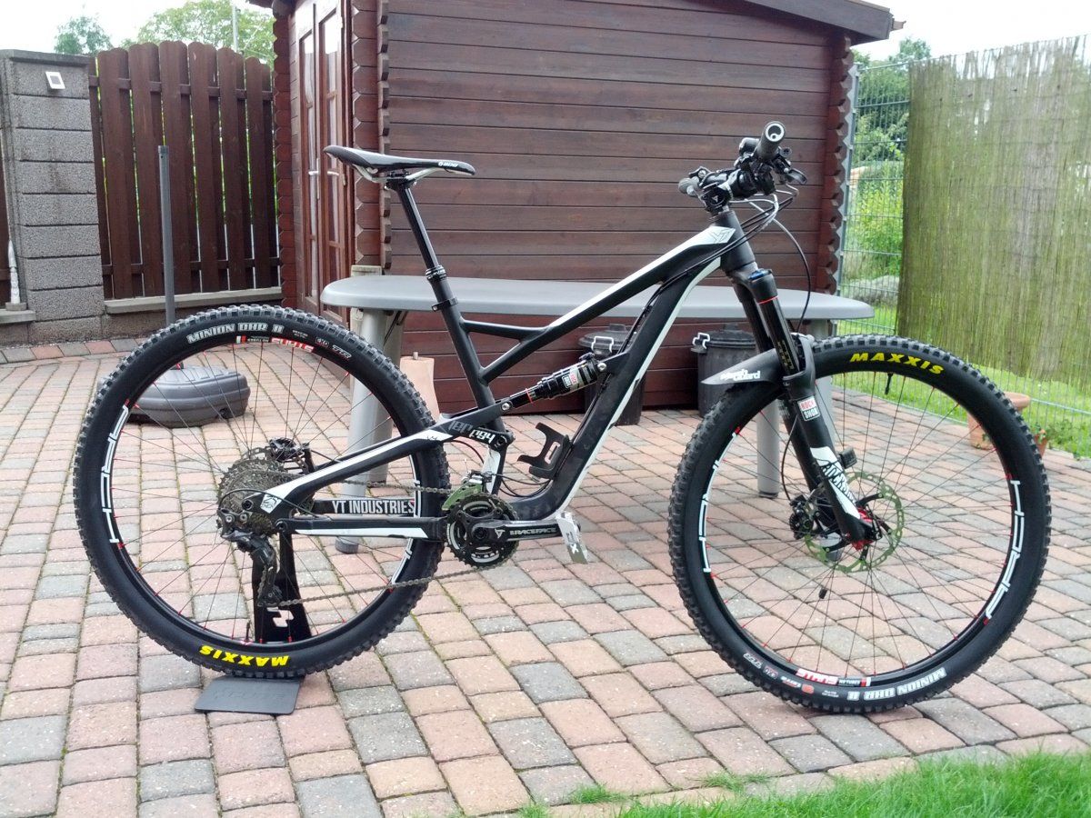

I am trying to get some weight of my JEFFSY CF PRO, 11,6 kg now
