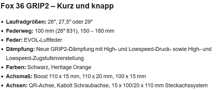

https://www.mtb-news.de/news/fox-36-grip2-federgabel-im-ersten-test/
