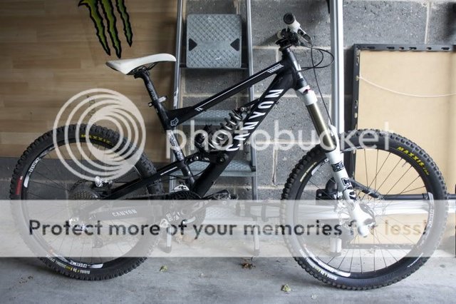

I went with the offset bushings i mentioned earlier. Got a 2mm offset each end.
Not sure how much slacker or lower the bike is, but it seemed to rail berms quicker on it's first outing!!
