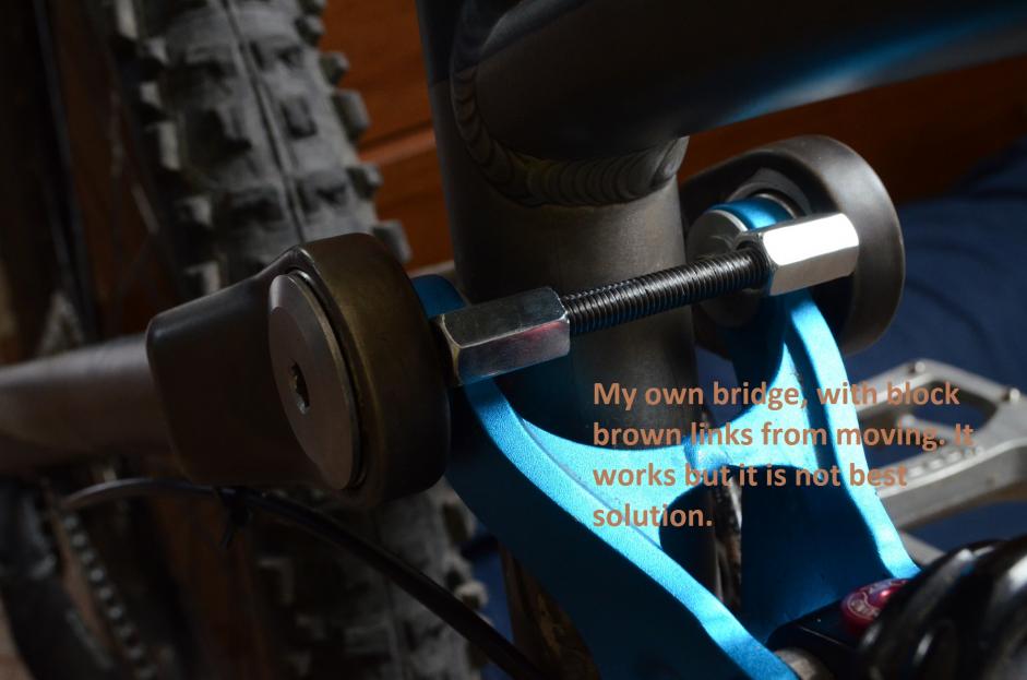

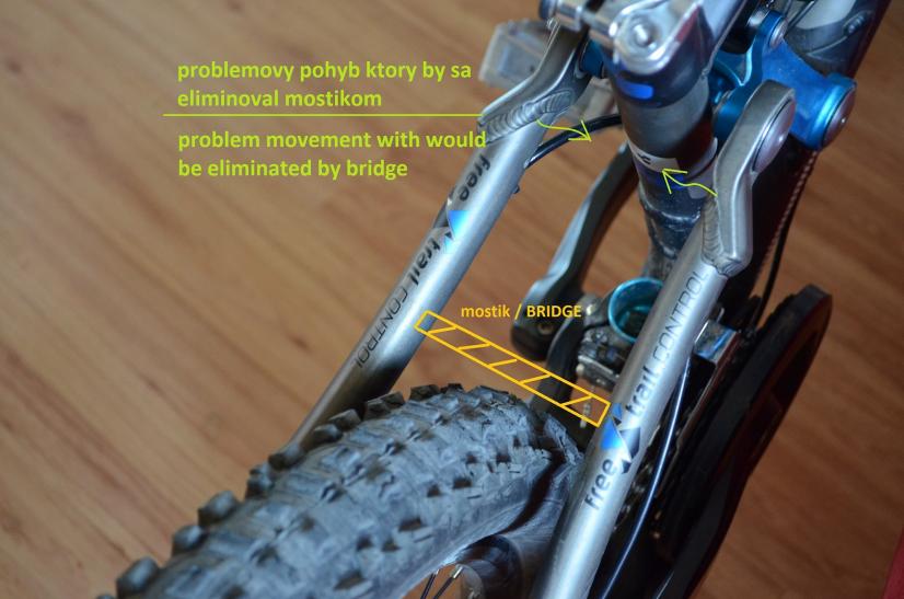

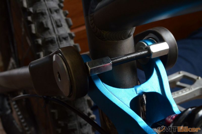

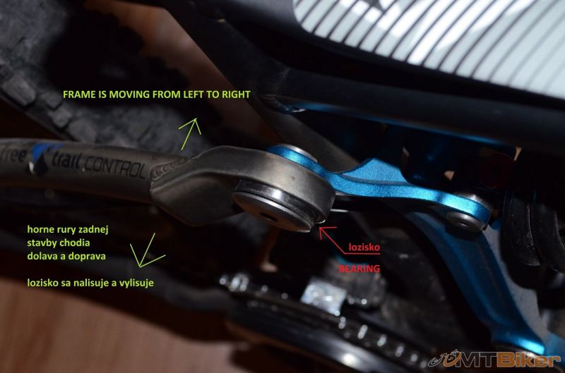

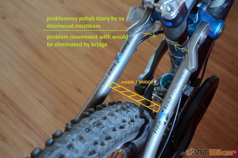

Hello guys.
Firstly Iam sorry that Iam typing in english but I dont understant your language.
Me and my girlfriend we both bought Cube Hanzz bikes. We are happy with it but there is one big problem with construction of frame.
As you can see on photo bearings are attached to blue link and pressed inside brown link. After some time it is not so tight and brown link is moving from left to right and both bikes are not possible to ride anymore.
Small clearance between bearing and brown linkage means that the frame will move and bearing will stay tightened in usual place where it have to be.
Frame is missing "bridge" between left and right side, so it can dance independent of each other and cause this problem. If bike have used the bridge moving would be completely eliminated.
I think that all of you will notice this problem in time.
It may occour in this situations.
- You will drop from bike and it will fall on brown linkages and so the bearings will pop out from frame
- After you change bearings small deform of frame can occour and will make this happen.

Hello guys.

Was hat das eigentlich mit der Sache vom matuso auf sich?
Habe mir das bei meinem noch nicht genauer angesehen (steht aktuell im Ausland) aber haben die neuen Modelle dieses Problem auch noch?
Das Problem ließe sich doch relativ einfach durch eine entsprechende Buchse/Hülse beheben!
So "blöd" können die Ing. von CUBE doch net sein??? :confused:
