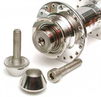

Phil Wood KISS OFF
"The 52 mm chainline avoids chainwheel clearance problems on MTB frames."
