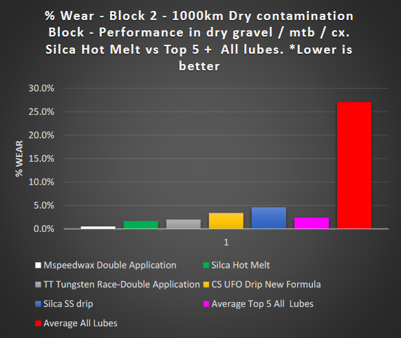

Das Mittel macht den unterschied:
Wenn man sich in den Daten von ZFC das beste Mittel, und das schlechteste (muc off) anschaut, dann ist in manchen blöcken der verschleiß um das Hundertfache höher.
Das ist ein Extremfall, aber es zeigt wie groß der Einfluss auf die Haltbarkeit der Kette sein kann.
Natürlich wurde nicht jedes mittel gestestet, aber ich persönlich würde doch lieber auf eines mit guten Testergebnissen setzten.

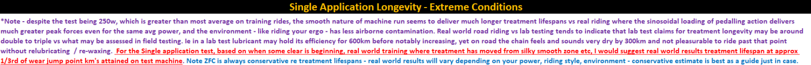

Single Application for Long event – 9/10
Im going to keep it more simple here vs trying to cover off if its road or Leadville 100 – you already know from above wet vs chain coating for offroad – so use that info in conjunction with the fact that synergetic is very long lasting per application. Remember a wet lube can also be topped off easily if needed in a very long event, or you can use to top off your chain coating chain if treatment is sounding too dry. Synergetic is a great choice here EXCEPT the application needle does make it harder to get some out quickly in a race – if you are topping off in a race you aren’t really too concerned if you over apply, you just need to get lube on asap and go. If I was me and I felt I needed to top off with synergetic in a race like Leadville, unbound gravel, paris-brest-paris etc, I would put some in a different applicator bottle that I could literally apply in 10 seconds and go vs the needle applicator. If I was silca, I would release a 5ml race carry bottle with an applicator tip suitable for quickly topping off during a race.

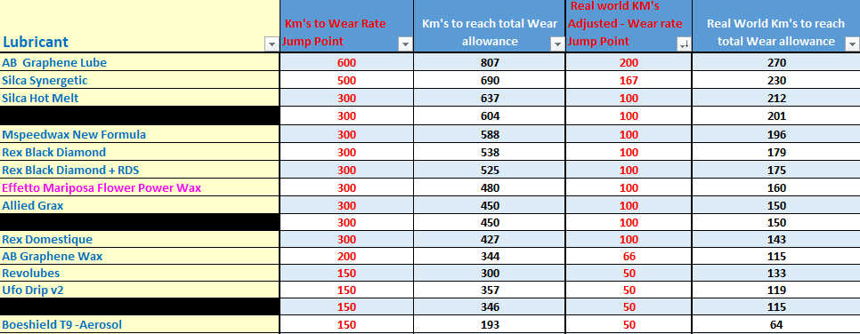

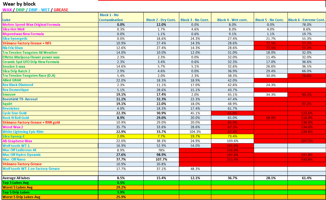

Testergebnisse verschleiß:

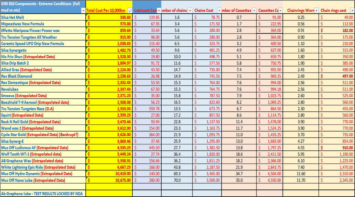

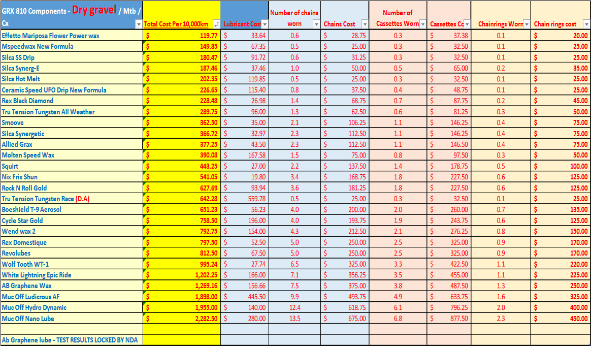

Cost to Run 10k km hochrechnungen:
