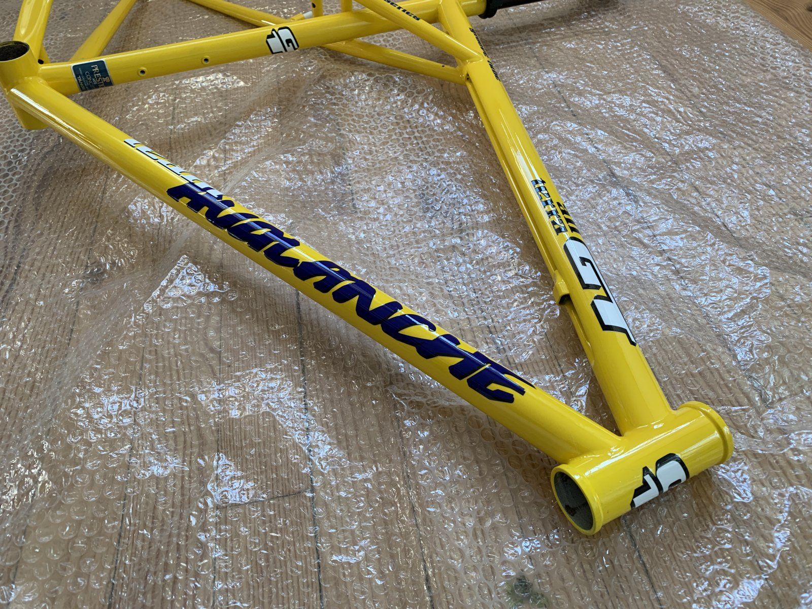

Thank you very much Kevin. Here is a photo of the frame as it currently looks like. After the bike shops reopen again I will let install the Tioga headset and the bottom bracket.
