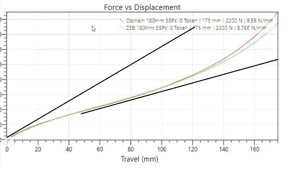

Ist von MST auf Twitter geklaut, das hat Mario mit seinem Laba Prüfstand als Kennlinie gemessen.
2022-05-12 20_56_13-M-Suspensiontech GmbH (@m_suspensiontech_gmbh) • Instagram-Fotos und -Videos.png

It's hard to see in this kind of chart, but it's actually very digressive. The angle of the slope is proportional to the spring rate. At the start it's about double than in the middle:

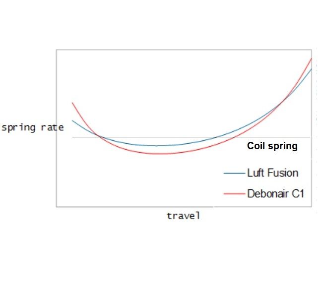

which confirms my calculations based on the size of the negative chamber (the ZEB is identical to the Lyrik C1):

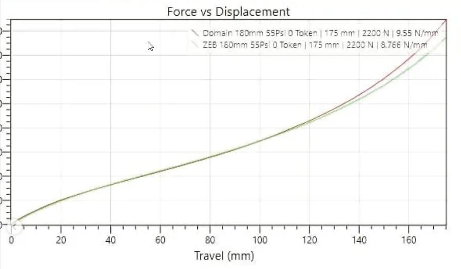

The 38 is much already better than the ZEB, as this chart from bikeradar shows:
(source: https://www.bikeradar.com/reviews/components/forks/suspension-forks/rockshox-zeb-vs-fox-38-fork/)
i wouldnt confirm that at all, as you can see in the Graph, the 38 cant even fully extend after the Rebound.
The force of the 38 is too low in the Beginning until 30mm, this travel is kinda lost. In direct comparison the Zeb is often described to ride much higher in the Travel than the 38. In my opinion they have both their own Pros/Cons, and it depends on weight and riding Style which will work better.
Thanks for the second chart, the spring rate is much better to showcase the characteristics of the spring. Progressive or degressive parts get much more apparent there.
My feeling on the trail is also (without having measured anything at the internals), that the Lyrik C1 and Zeb A1 do pretty much the same. With the Zeb A1 being worse (i.e. more of a dip in the spring rate), but that could also be an effect of the larger piston diameter together with low pressure, which makes simple friction more apparent.
Would be interesting to get also a spring rate chart for Zeb A1 vs Zeb Luft Fusion.
That bikeradar article is also an interesting read. I'd agree in most parts concerning the Zeb (as I don't have a 38)
This is from the bikeradar article which Lupicus quoted:
"And once deeper into the travel, when braking or pushing into a turn, it’s the 38 that rides higher. That makes it more predictable due to the more linear increase in support, while the Zeb pushes a little deeper before the force builds up towards the end of the travel."
I'd say the same thing for Zeb A1 vs Zeb LF. If you are putting much weight through the bar, the A1 is everything but high in the travel. I'd rather say it's quite low in the travel, above all in kind of static situations where hydraulic damping can't do much (the much quoted slow&steep descent). The only solution for this is to go to far too much pressure (what I did in the end, to make it work on primarily technical trails). The Luft Fusion is much higher in travel in those situations. Very much noticeably higher, and for me this makes a big difference in confidence on the bike.
What's also interesting, is the measurement in the Bikeradar article, how much time the fork spends in the first few millimetres of its travel. For the Zeb they measured 14% in the first 10mm of travel. That's surprisingly much. This is exactly the part, where the fork is very uncomfortble, and where in the force-travel-diagram a hump can be seen. This will certainly attribute to the feeling, that the travel is kind of missing a part in the middle. At first the fork is unwilling to compress, then as soon as it does, it compresses fast and much, and in the end it ramps into progression also very fast. And this also explaines to me, why I needed a lot of sag in the A1 Debonair to make the Zeb fairly comfortable, to avoid being in this uncomfortable part of the travel very often.
To me, a more linear spring rate makes for a much more composed and reliable feeling when it comes to bigger hits and also technical steep stuff... everything where you use much fork travel and where you are often in the last part of it. Maybe standing high in the first part of travel is more fun or more agreeable on easy flat stuff, but to be honest that part doesn't interest me much on an enduro bike, if I want to have fun there, I take my gravel bike and enjoy standing ultimately high in the travel of my rigid fork ;)
This sounds like the A1 Debonair is exactly what you want. You should be happy about that, saves much money :)

Trotzdem wirst du mir nicht objektiv erklären können, dass in dem spring rate Diagramm von Bikeradar eine Gabel mit der grauen Kennlinie ab 60mm Federweg höher stehen sollte als eine Gabel mit der gelben Kennlinie.
doch, das kann ich, wenn man die Gabeln nicht nur zum Stolpern benutzt wird man die 38 nicht mit 15% Sag fahren, außer man fährt im Worldcup. Ich hatte hier doch schon beschrieben das ein Anfangsbereich der unter einer linearen Kennlinie einer Coil liegt für mich je nach Einsatzbereich nicht gut ist. Das ist bei der 38 auf einfach der Fall. will mich hier auch nicht nochmal widerholen, hier ging es auch nie um 38 vs. Zeb.
Unabhängig von 38: welche Luftfeder soll das betreffen? Anfangsbereich unter Coil. Da hätte ich jetzt gerne mal ein Diagramm zu gesehen, von irgendeiner beliebigen Luftfedergabel wo das so ist. Mir würde mal keine Gabel der letzten 10 Jahre einfallen, wo sich das so angefühlt hätte, oder wo ich eine Messung gesehen hätte, die sowas zeigt.
Auf dem Bikeradar Diagramm ist sowas zumindest schonmal nicht zu sehen (hoffentlich fängt jetzt niemand an, auf dem Gekrickel der Messlinien rumzureiten, was ziemlich sicher Mess- und Reibungsartefakte sein dürften, aber nichts mit der Kennlinie der Luftkammer zu tun hat ;))
Unter linear wird der Anfangsbereich der 38/luftfusion nicht sein, ich glaub nicht mal, dass das möglich ist, müsste ich aber mal berechnen. Ist nur Messungenauigkeit bzw. der Einfluss der wahrscheinlich sehr langsamen Einfedergeschwindigkeit des Prüfstands. Sieht man auch an der saubereren Kurve auf dem Rückweg. Also einfach linearer und linearer in den ersten 2/3 immer besser als sone Rückschrittskurven wie c1 oder a1 zeb, da gibts m.M.n. keine zwei Meinungen. Es werden immer wieder Versuche unternommen solche Kennlinien als in irgendeiner Hinsicht vorteilhaft zu verkaufen, ist aber alles Quatsch m.M.n. (und ich habe diese Diskussionen sehr genau verfolgt und versucht bei mir zu validieren). Warum ist den mittlerweile alles auf debon air/evol umgestellt? Einzige limitierende Faktoren sind max Druck und übermäßige Progression, wovon zumindest das letztere von luftfusion/38 erfolgreich umgangen wird. Kleine Anekdote, weil ich gestern wieder ne Luftkennlinie linearisiert habe und es einfach nur krank ist, wie schlecht kleine Negativkammer demgegenüber funzt.
Das im Bikeradar Artikel wird so sein, denke ich auch. Das Gekrickel muss man interpolieren, sonst kann man sich nur einen Wolf über Nonsense-Artefakte reden. Und zusätzlich schreibt er dann noch weiter hinten, dass v.a. die 38 einen Service nötig hatte und er den erst nach dem Test durchgeführt hatte. Es wird also auch noch unnötig viel Reibung im Spiel gewesen sein, kann man auch an der auseinanderlaufenden "Rebound" Kurve ableiten. Aber schlechte Wartung hat ja nix direkt mit Federkennlinie zu tun.
