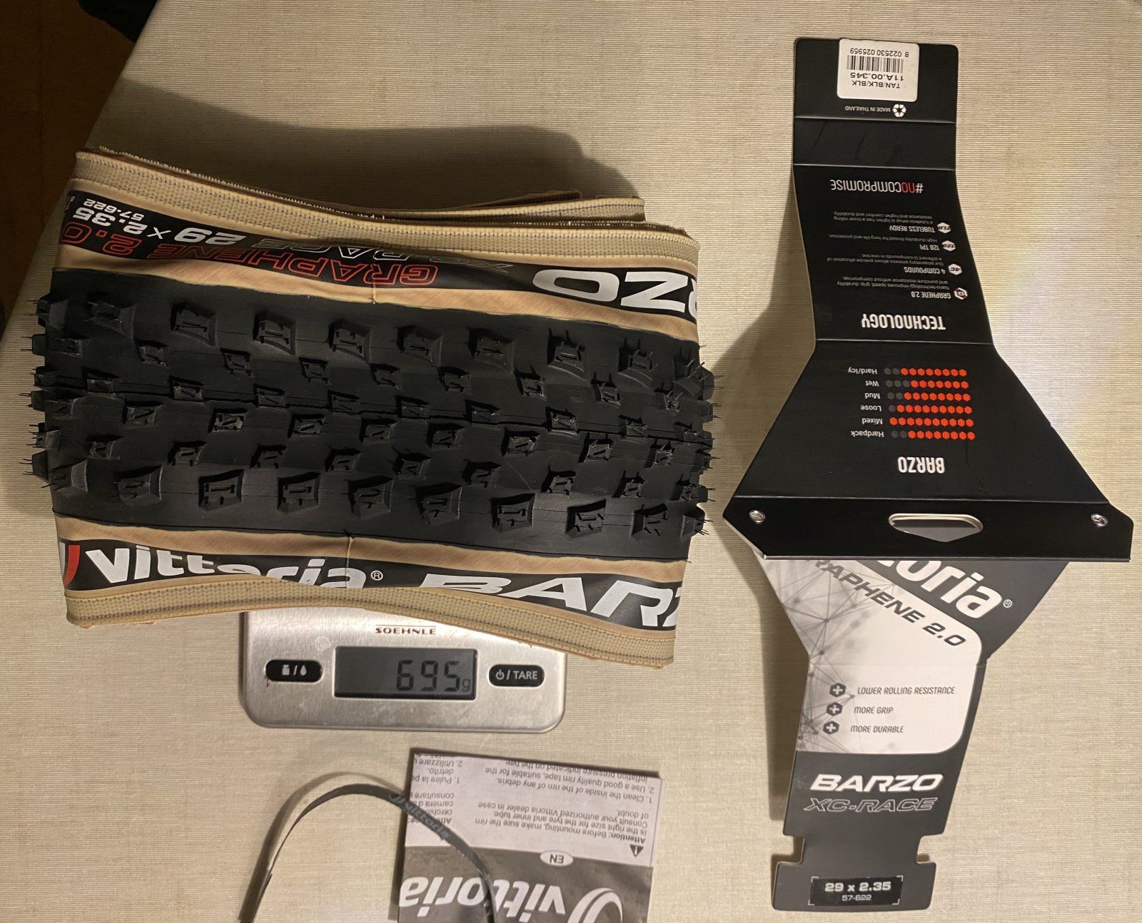

Barzo 29 x 2.35 XC/para: 695 gram (sample 2 and 3: 699 and 703 gram), tubeless setup very easy (not like Conti RaceSport at all)

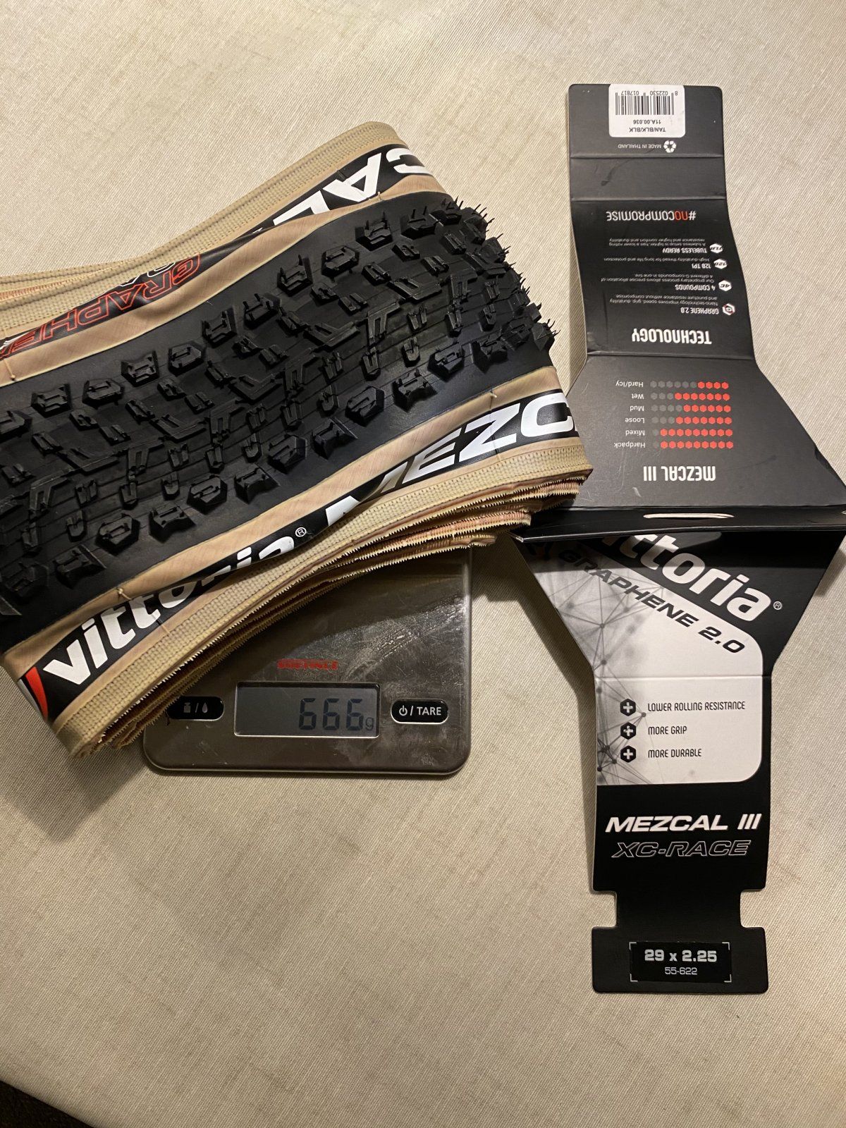

Mezcal 29 x 2.25 XC/para: 666 gram (tubeless setup again very easy)
@rapsac Thanks for the information! I was looking for the Barzo 2.35 as Skin version, but 2.35 is not really available anywhere, just the 2.25.
