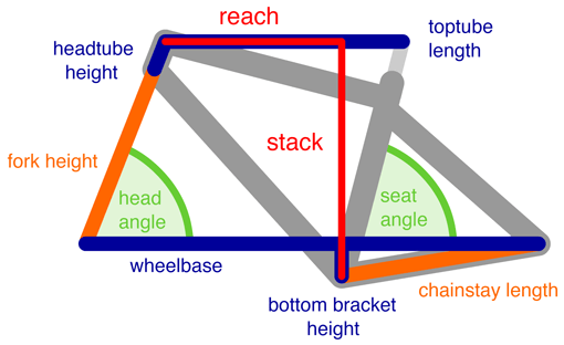

http://bikegeo.muha.cc/

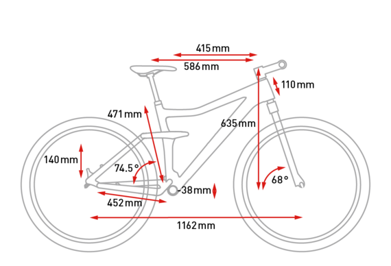

Stereo HPC 120 29 RH 18"

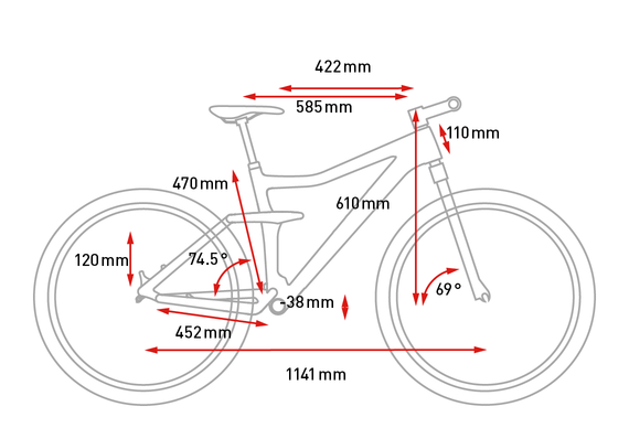

Stereo HPC 140 29 RH 18"
