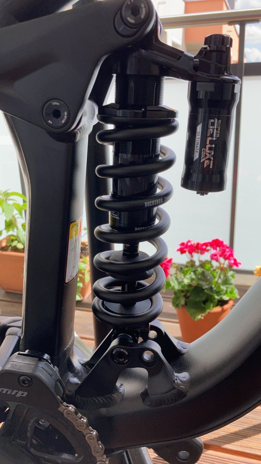

How about fitting a shock with the correct sizing recomended by Cube? I don't think that anyone tried to mount a shock with bearing-ends to this frame so 1) you get a shock with "normal" eyes or 2) you have to check on your own if your shock will fit.
The 2020 TM model had a coil shock with bearing-mount stock. But the bearing was at the lower shock mount. I think @danxbike wants to know if the shock could be turned upside down.
Are you sure about that? On the internet I can't find a picture where you can clearly see a bearing-mount...in most pictures it seems to be regular eyes.
Top-mount (bottom shock-mount): https://s14761.pcdn.co/wp-content/u...o-170-2020-Mountainbike-News-033-1140x760.jpg
Bottom-mound (top shock-mount): https://media-prod.velomotion.de/wp...9/02145803/cube.stereo-velomotion-2019-02.jpg
Estos son los cojinetes del amortiguador, tengo la cubierta antipolvo de 40 mm y el hardware superior es de 40 mm, así que creo que encajará bien, el hardware inferior es de 20 mm y el amortiguador es de montaje estándar, por lo que debería encajar como esta foto:
51ab2980-7d31-4e32-aa77-237a3f1b0378-jpeg.1316214
Esta es la cubierta del cojinete de polvo de 40 mm.
Donde compré el amortiguador dice que solo se ajusta a la transición Patrol 2017, pero en este caso los números también se ajustan.
Saludos y gracias por el apoyo
