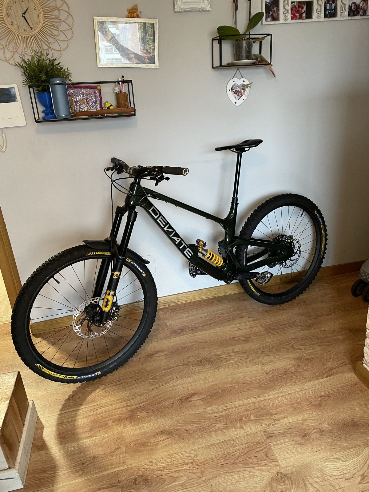

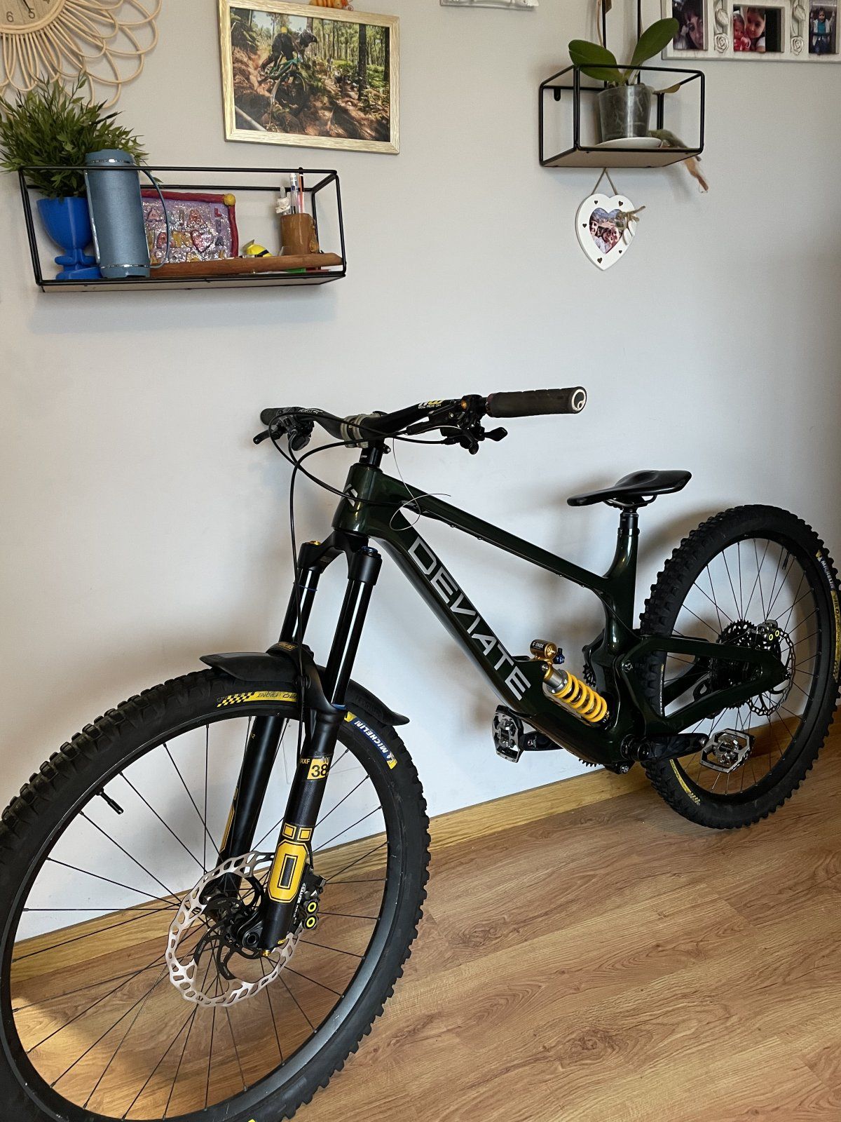

In the end, the 240 seatpost entered inside!!!!! the problem was that you had to move it a little to the sides and that way it fits whole, in the frame of the photo L with oneup 240, I'm missing a little
that is the maximum that enters with cable, now I only have to reduce from 240 to 230 and I will be at my height jjjjj
