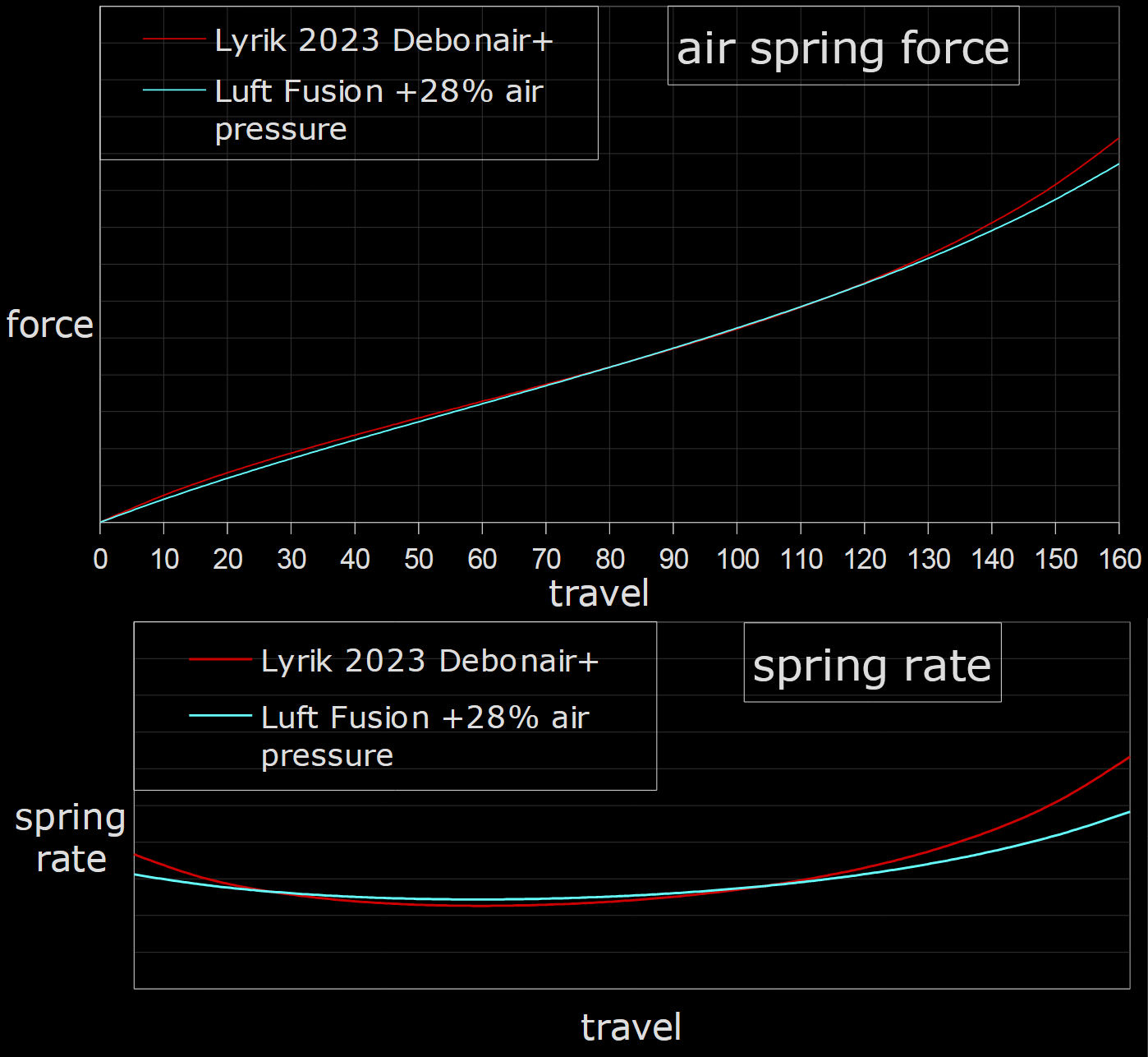

Hat die schon jemand?Luft Fusion available now for Lyrik 2023
Negative chamber is 75% bigger than stock (which was already not bad)
Positive chamber is also significantly larger. The effect is equivalent to 1 less token.
This is just the effect of the air spring (positive and negative chambers)
The compression of air trapped in the lower leg is also decreased. Based on measurements I've done on other forks models I estimate about -15kg of force needed to bottom out. This is due to the different compression ratio and smaller surface area of the seal head caused by the large air shaft, in addition to the removal of the buttercup.
