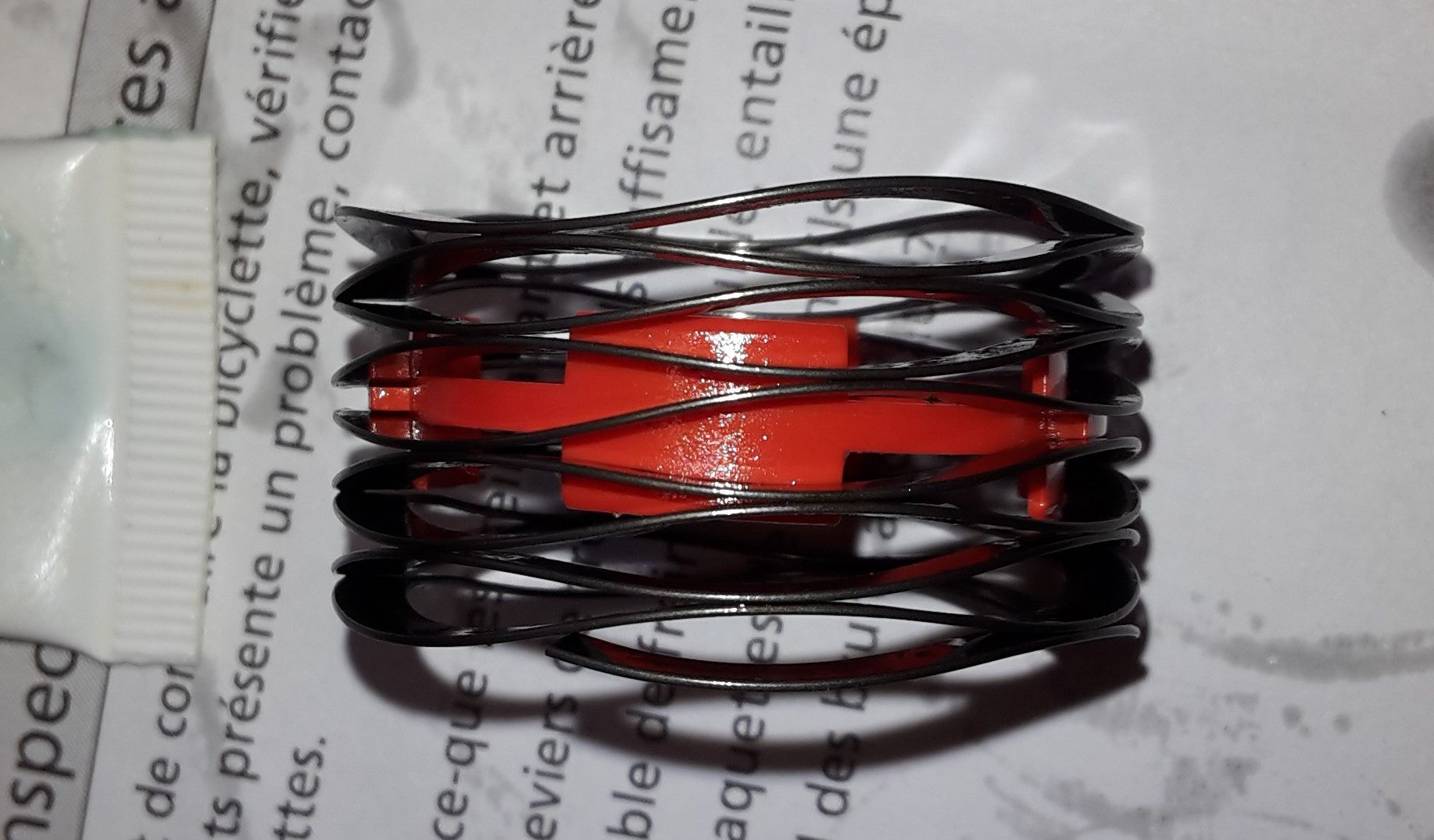

Hello!
Is it important where red plastic guide is on counter measure spring? it should be in the middle?
