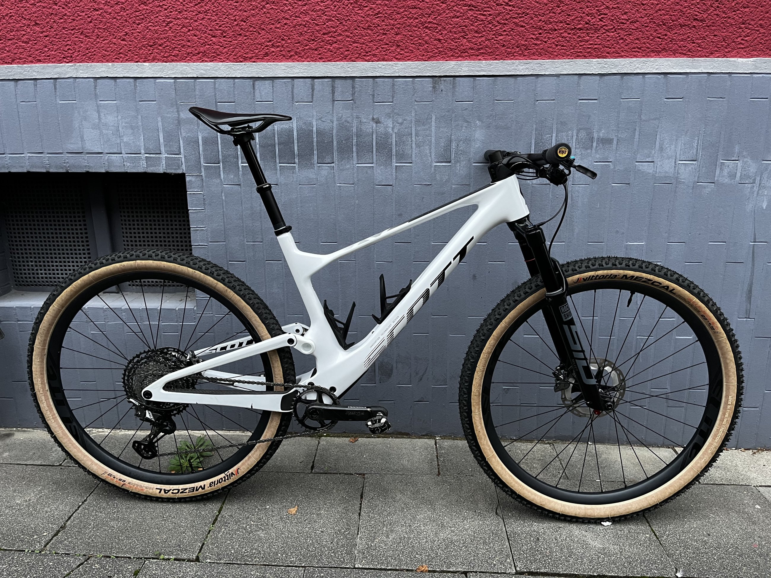

Okay, thank you very much. I don't feel like experimenting, so I'll probably go with the M9125 crank.

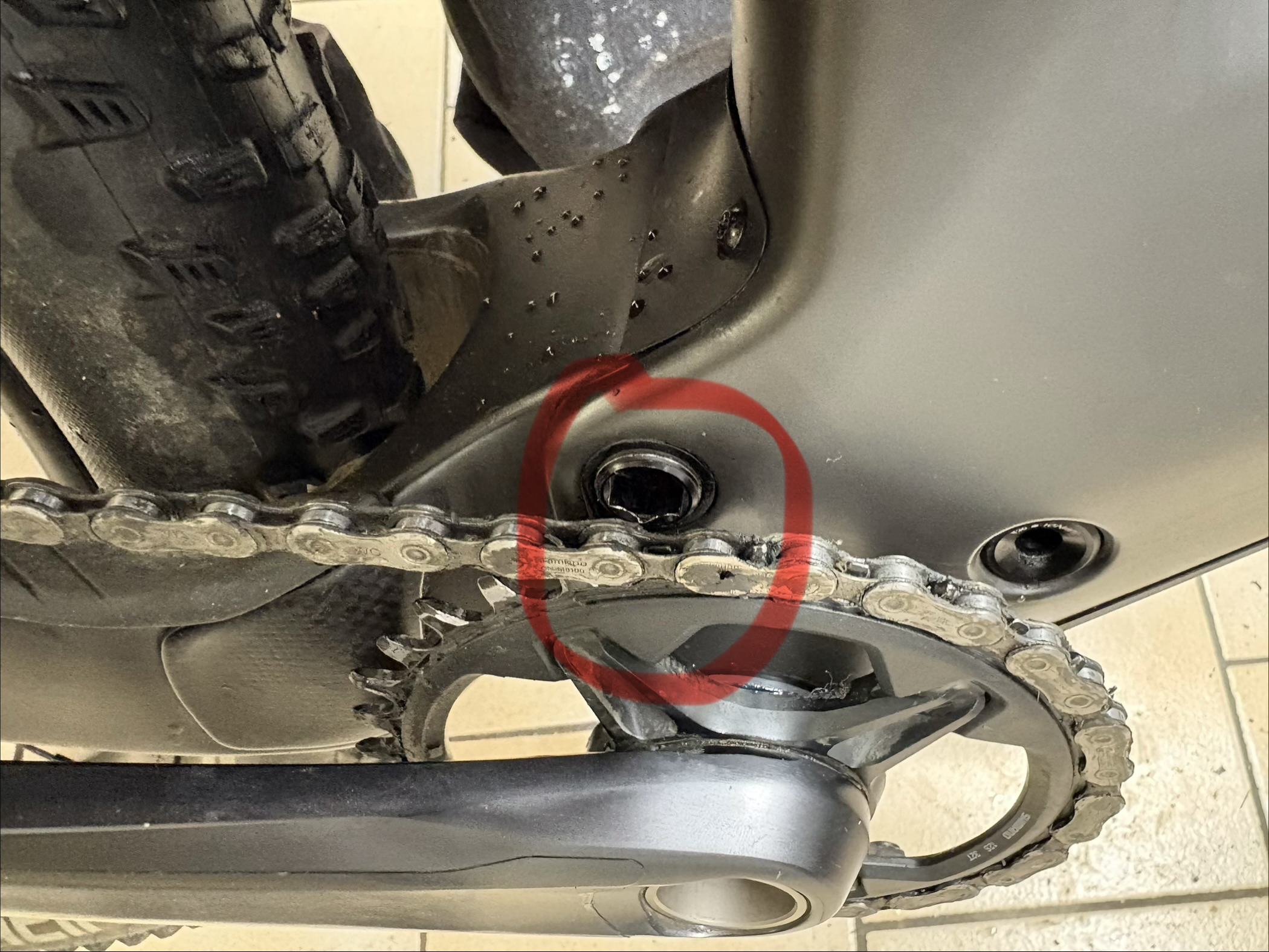

Something creaks when I pedal, and I've checked everything except the bottom bracket and the crank.
By the way, the new shock/fork, the 2024 model, fits very well, so thanks again for the advice.

Bike looks good, the graphics on that model are my favourite. I found that the bolt on the drive side of the SL crank would loosen if it was not correctly torqued down and needed to be checked again once it has been ridden a few times. I did replace the RF BB (double row bearing model) because the previous owner did not maintain it and the bearings were rusty on the DS. It is in the Scale now and absolutely no problems but I have bought a spare XTR M9125 crank/BB if it does fail.
