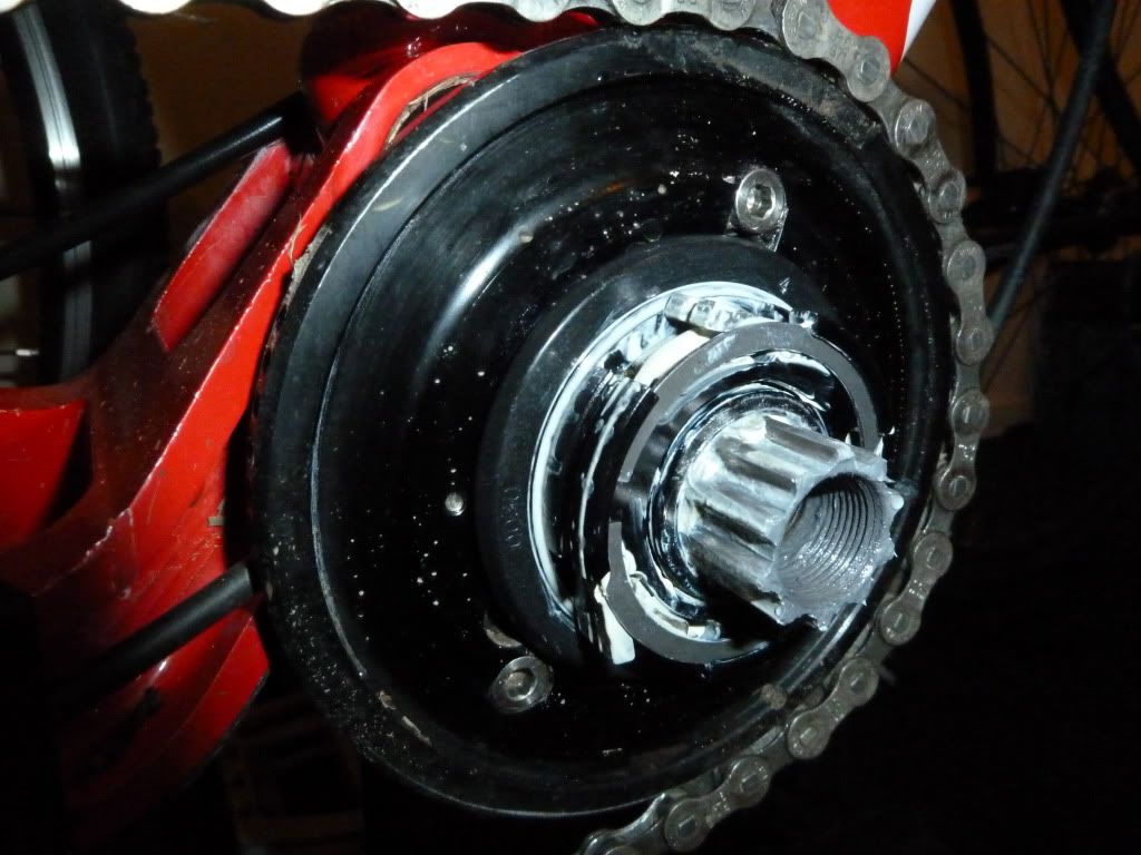

Hi,
First let me apologise as I don't speak speak a word of German so I'm hoping some of you can help me out in English. Looking through your thread and using Google translate it seems you guys have some good knowledge of the Hammerschmidt.....
I'm having a little trouble with my Hammerschmidt AM, it appears to be occasionally slipping when in overdrive. When I'm pedaling in overdrive in get a loud 'click' and a split second feeling that drive has disengaged, this can happen 2 or 3 times per ride.
I've checked the pawls on the back plate and they appear to working ok, I haven't yet opened up the gearbox side as I don't yet have the tool....
Just hoping someone else has experience the same problem and knows a fix for it..
Thank you.
Neil (from the UK)
Hi Neil,
slipping in the overdrive mode happens normally only if the bowden cable for the gearshift is not properly set upped. Please check first that the two positions of the gearshift are okay.
Another question, how many kilometers is the drive in use now and under which conditions (temperature and rain/mud/snow etc.)?
Hi,
Sorry if forgot to mention i've checked and adjusted the cable several times and it's made no difference to the slipping. Operating the shifter while looking at the lever on the hammerschmidt back plate it appears to be working ok...
It's got roughly 300km on it, some very wet conditions, not a lot of mud, mostly rocks and only one ride in the snow.
Would it be possible for you to make some photos from your gearbox where the pawls normally attaches. I would like to see the tracks from the pawls on the cogwheel
Is your bottom bracket Ok? Do it have not to much clearance?
Hmm, this looks Ok. Slowly the ideas of me going ;) If the
- bottom bracket is Ok
- the back plate is properly attached
- and the gearshift is well set upped
than the overdrive mode should not slip, at least not in the middle of the the work. But a kind of slipping could still appear if you just begin to crank.
Just for completeness: could you make shots from the three pawls?
Do you have mentioned any special cases where the slipping appear?
I'm really stuck too, it looks like new, I would have though that the slipping would cause some damage or scratched but there is nothing....
Here's the pawls;
It seems to slip mostly under light pressure, while sat down pedaling, not under heavy pressure on the pedal as much.
Oben Unten
