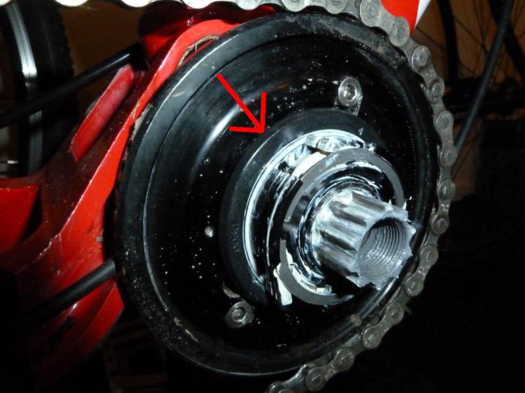

Yes, this looks well too.
It seems to slip mostly under light pressure, while sat down pedaling, not under heavy pressure on the pedal as much.
This looks like the case I described with: "But a kind of slipping could still appear if you just begin to crank."?
Put the gearbox on the bottom bracket. Go to the Overdrive mode. Let the chain out of the gearbox (like on your picture). Then make some rotation with the gearbox as you would crank and listen if you hear something not "normal" inside the gearbox.
If every thing is Ok, trie to crank back a little, just so far that the first pawl jumps over one of the teethes of the cogwheel and than crank again to the front. Does this sounds Ok?
Ok, Without the chain and in overdrive when cranking forward it sounds normal, just the faint 'whirring' of the gears inside.
I then cranked back a little and most of the time it was ok, but sometimes I could hear only 2 or 1 of the pawls click back over the teeth when cranking backwards very small turns, like millimeters.
I cranked back so I could only here one pawl click, then with the chain on and hold the brakes I push the pedal with my foot and I got the same loud 'click' and slipping I see when riding......
As I said before, this kind of slipping is Ok and can't be fixed really. I mentioned slipping like this only on cold days something around 0°C because I use a grease which is not fluidly enough.
If you have also this kind of slipping more often in the cold days, then just try a more liquid grease.
Cheers, it doesn't seem to be happening more now were in winter, I don't recall it happening when the temperatures were above 10°C, it was 2°C this morning when it happened 3 times.
Thanks again for your help.
Neil.
By the way, some grease on this rubber wouldn't be bad. This would protect the inside of the gearbox from mud etc.
(I modified one of your images - if this is not Ok for you, let me know)
