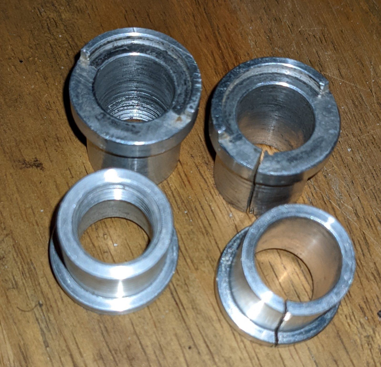

  • 2 sets of adaptors to fit 15x100 hubs with rock shox maxle (not included) on Doubleagent forks:
Wie sehen die aus?
=> 15x100 auf 20x110?
Ja genau. Hab ich mir mal drehen lassen, passt für 148mm Maxle mit M15*1,5:
Funktioniert super, hab ich mir jetzt auch für die Metric besorgt. In 20*110 bekommt man ja kaum ein preiswertes Laufrad.

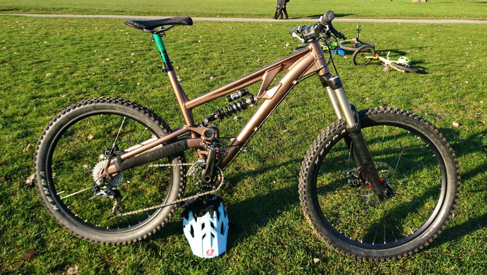

Slowbeat -- thank you for confirming the travel mod cannot be done. I am interested in your parts. Mine is a 2015/16 Revo I bought from Rene Schultz at Bioinicon. Here in Seattle we go straight up and straight down -- lol I love the bike but it is getting old. My Metric has 160 mm and high and low speed compression damping and rebound damping. the coatings on my fork are decent but have a couple scratches. my shock is scratched more. the damping still works well. The lock out is not so great anymore. I noticed the fork is a bit sticky when adjusting travel on the fly.
I was thinking 180 up front could give me more slack for the downhills. would you recommend the Double Agent over the Metric? What do you think is the best set up?
I don't know the difference between G1 and G2. And my rear end is not boost it is 12x142. I think Revo 2 is boost. Am I right?

BTW I have a 20x110 up front.
I also have a first gen Bionicon Edison (my old bike) with the double agent (no damping adjust) -- did I read the 27.5 will fit that?

Hm, looks like a Evo? Thought first Revo prototypes were 2017 makes featuring 142mm rears like mine. When they made it to the market they were 148mm if i remember right?
Main difference between regular Evo and Revo is boost, TT/ST length, tyre clearance on the rear and no 26" option.

Ich schau bei Gelegenheit mal ob ich die Skizzen dafür noch finde.
Hab bei kommerziellen Anbietern ca. 40€ pro Sück bezahlt, was voll versteuert ein fairer Kurs ist.
Sind nicht eloxiert, aber auch nicht korrodiert.
Ist auch die eleganteste Lösung für die Doubleagent da mal normale Laufräder zu fahren.
