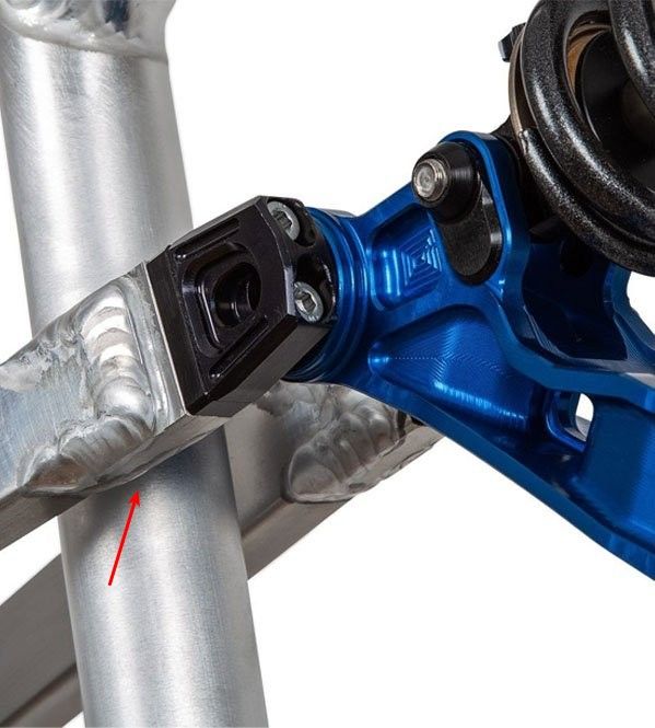

Hi,
I'm asking this here, maybe someone has answers, since Nicolai seems slow to answer such questions on email.
I'm thinking of getting a small G1 frame, and going with the 15mm seatstay mutator, which would raise the BB and steepen the HA quite a bit.
The thing is, in their docs, this frame/mutator (the 15mm one, mutator ID 106, link here) combination is "not recommended". My question is why?
What is the reason for not being recommended? Is it a structural issue e.g. chainstay hitting the seatstay, not being able to achieve full travel or just because of the specification difference from the advertised values e.g. head angle being so different?
Second question is, when ordering the frame, can I choose the mutator(s) I want and have it mounted from the factory? If not, any idea which are the factory/stock mutators for a small frame?
Finally, what has been your experience when communicating with Nicolai?
I know they're a small company, should I expect it to be slow? Some other brands have been much faster to respond, not sure what to make of it and am wondering if the process of ordering/support would be the same.
I can only assume what is the reason for. The answer to this question should be given by Nicolai himself.
IMHO, I cannot imagine that a structural problem will be the reason.
The geometry will be not fit completely to the suggestions of Nicolai how to setup a race bike.
In any case, you need to check the distance between the frame and the tire. That is a standard procedure when you change the mutators recommended or not!

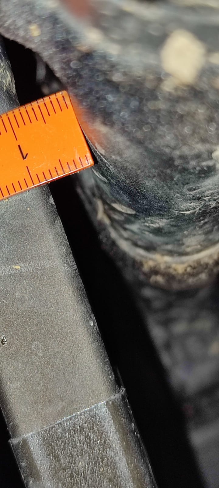

I did get an email a few hours ago, and as B1H4 mentioned, they suggest mounting the mutator and doing a collision check, which isn't ideal, since if it wouldn't work, I'd have to return it :)
Can anyone please measure the clearance between the seatstay & seat tube?
With a longer seatstay mutator, I'd be pushing the seatstay back and if there is reasonable clearance for the end with the welds, it's probabily going to be ok.
Thanks a lot!
Hello, please excuse the dark pictures. You should see the clearance between the seat tube and the seat stay.
Sorry for the dirty bike, but it is in use, especially in these weather conditions.
The measurement was made statically. Under lateral load, you can expect some deflection of the seat stay, which can lead to contact with the seat tube.
For example: If you hit the ground up after a jump with the rear wheel at an angle.
