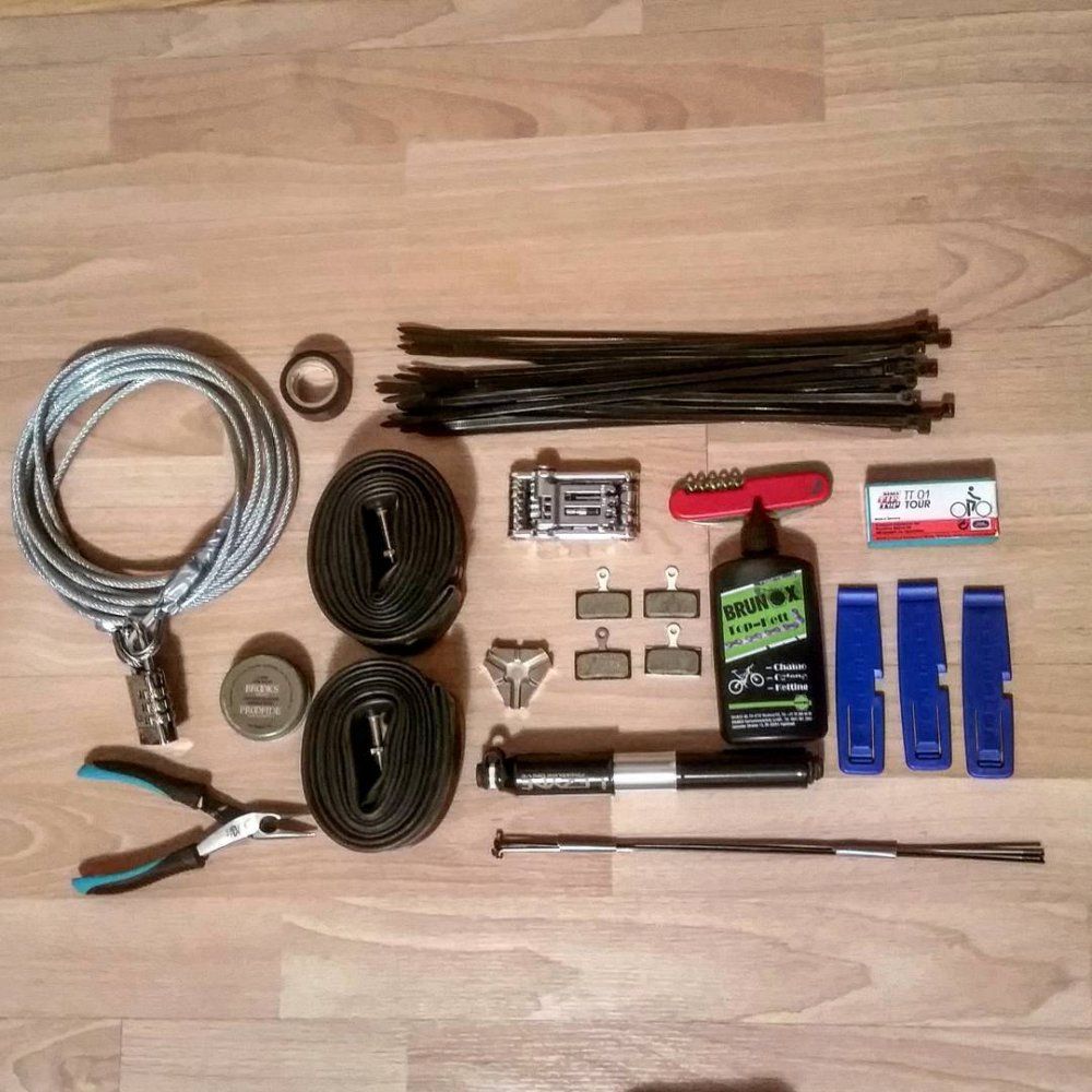

1v6 Werkstatt:
- 2× spare tubes - tire levers - multi tool - knive - pump - pliers - wired band (multi use purpose) - zip ties - tape - spare break pads - spokes - chain lube - patch kit - spokes wrench
