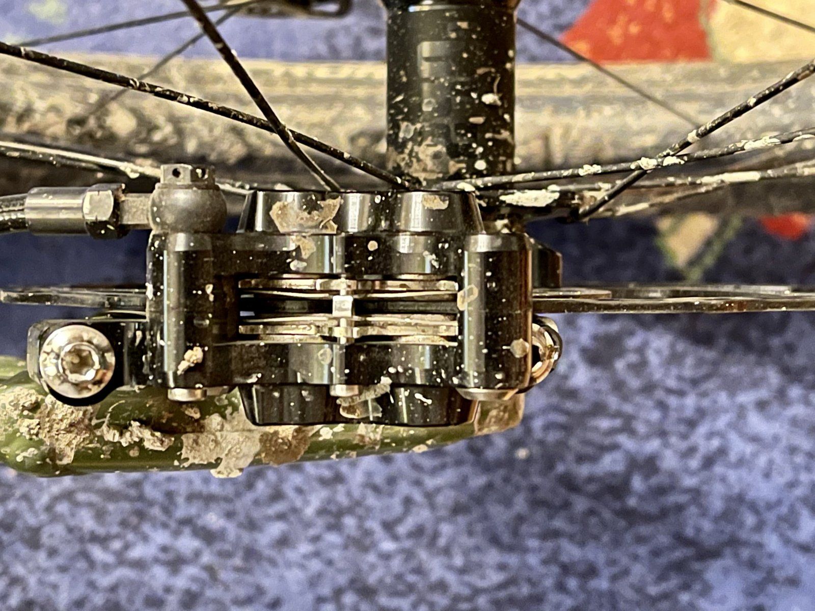

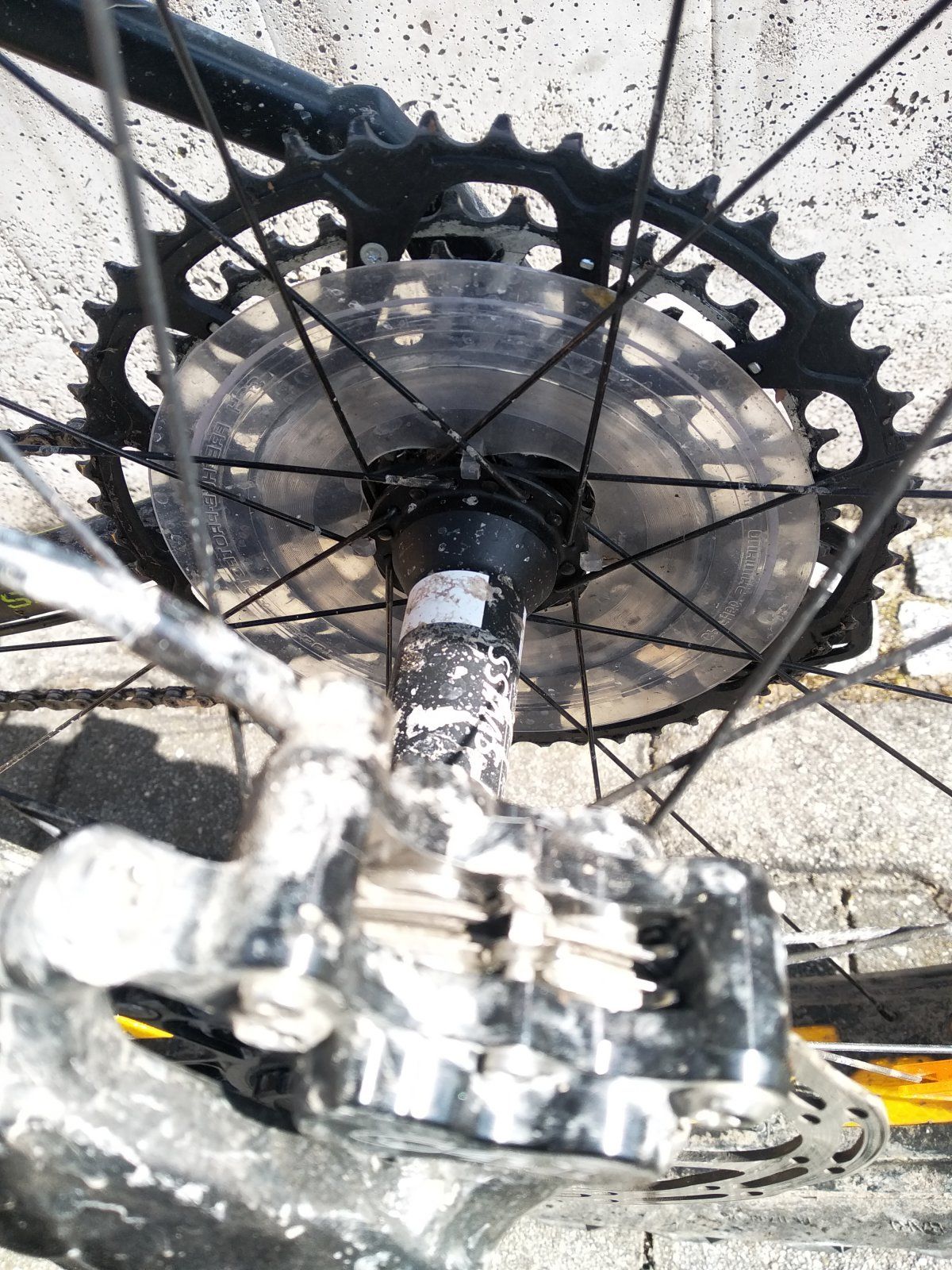

Noteworthy is the different bleed nipple at the caliper. The small T10 screw is to be removed, the filled syringe then attached after which the 7mm nut is turned a bit (ccw) to open the bleed nipple to make oil flow possible. The small T10 screw at the caliper has no o-ring since it does not close off the caliper. I have not found an updated manual yet, but guess it will be up soon. The Heinzelman kit has the smaller attachment included for the caliper bleed nipple.
