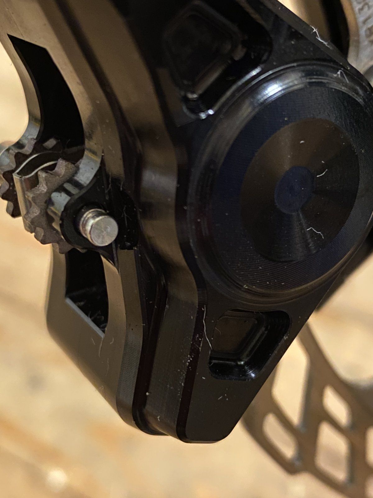

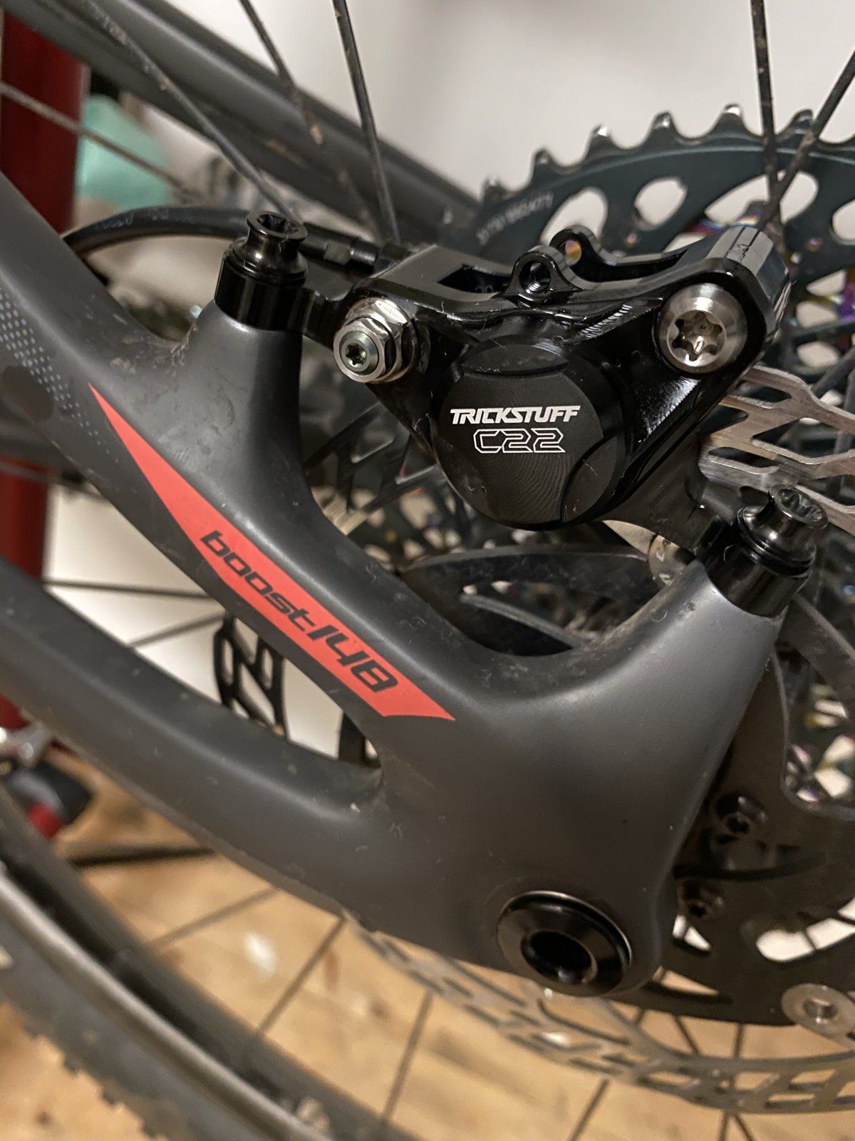

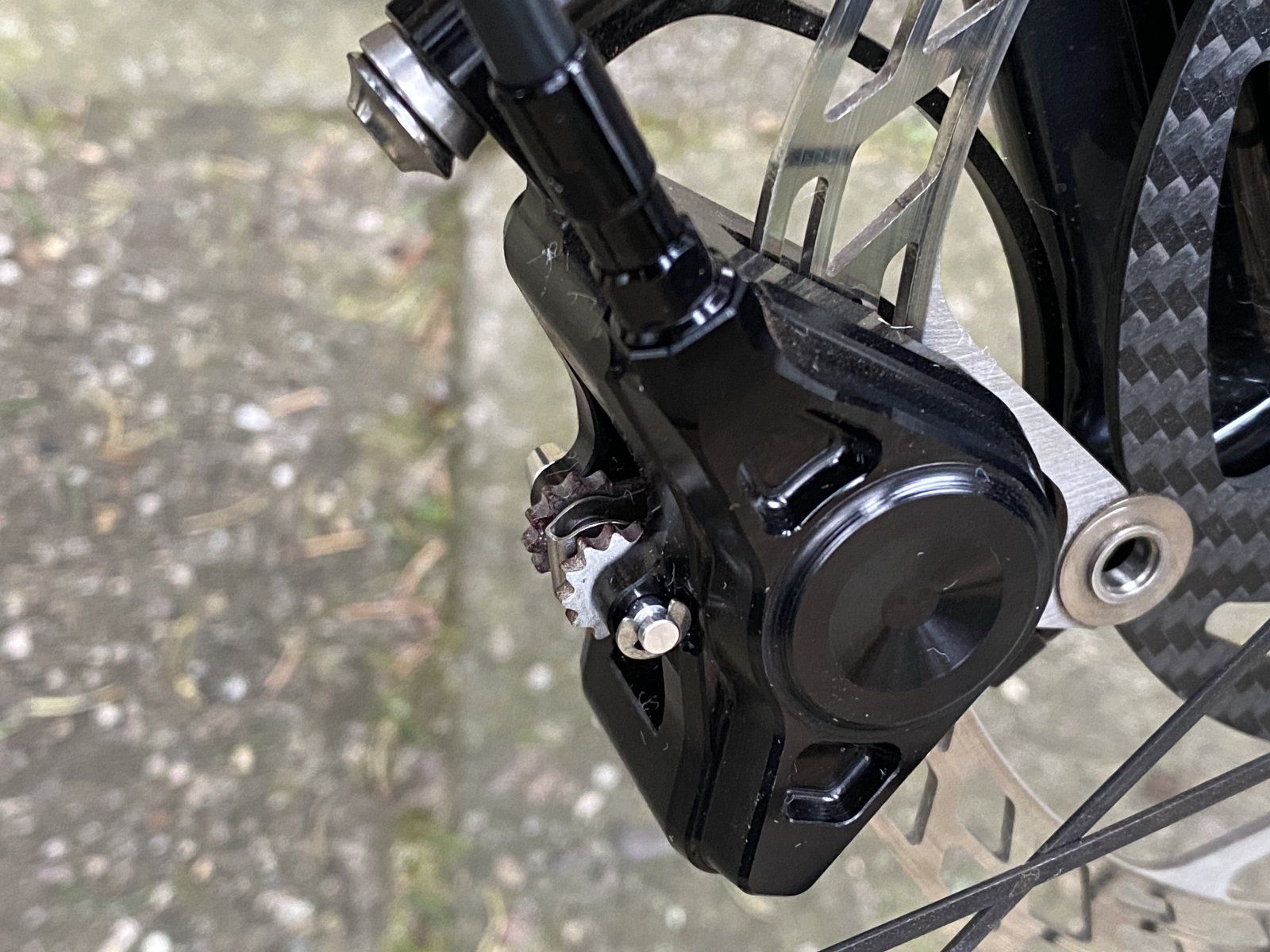

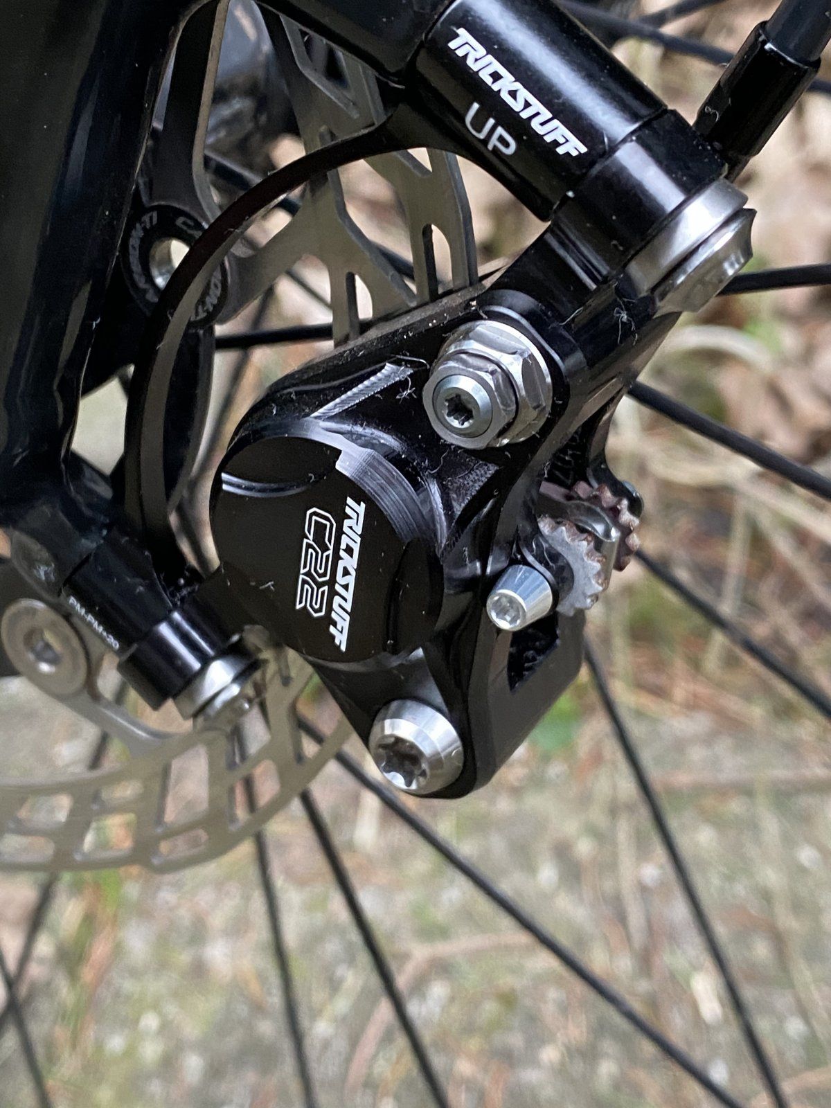

Piccola Carbon brakes with C22 caliper are installed. Nice! With a small and silly challenge: how to install the small clip on the brakepad holder bolt without scratching the caliper? The space seems to be too narrow for the clip. On my C21 caliper this fits easily. What am I doing wrong? I have tried it upside down, left, right etc. The clip itself is not easily bent. Presumably I am missing something obvious?
I have managed to get it on by pushing it on sideways. The fit is very tight and the end of the clip does touch the brake caliper (slightly scratching the anodizing). Apart from this scratching (and perhaps the added security of the more protective fit), the handling of the safety clip is easier with the C21 caliper. Perhaps an alternative clip can be found? In the mean time I may remove some material from the clips to see if that works better. Due to having to put it on sideways I have no use of the 'widening end parts' anyway. It may impede the secure fit though. (just ride the bike ;-)
You are right - this clip is not the best version. Handling is easier if you bend the clip by 90 degrees, as the Shimanio clips are designed. Bending is easy with a flat plier.
In the future we will supply a different clip (Formula style) which is much easier to handle and which won't scratch the surface.
Thanks. I will use lock-tite in the mean time and order some e-clips from Amazon (and ignore my newly scratched caliper - the first scratch hurts the most as you know).
Piccola Carbon/C22 test-ride done today (with Carbon-Ti rotors). Previously used Hope Race Evo X2 which are not very strong (not to say relatively weak) but have modulation without end. The Piccola's are much stronger but still modulate (very) well. Need to use them in more hilly terrain obviously, but first impressions are very favorable.
Found some e-clips on Amazon, but slightly too big (2,5mm), ordered some that should fit better (2,3mm).
