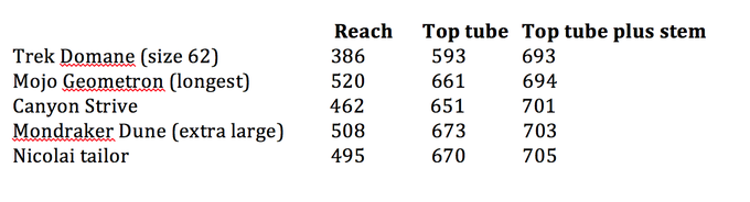

Mondraker macht das dann noch mal ne Ecke länger als Specialized. :) Das ist in jedem Fall zu begrüßen, dass mehr Hersteller diese Maße so kommunizieren. Hier gibt es ein paar interessante Vergleiche zu diesen Werten.
LIMITS TO SIZE –
Now many would consider this bike massive. And maybe because of this and bikes like the Dune and Mojo Geometron there has been a perception that these are futuristic monster size bicycles. This is incorrect. True they might well be the largest size mountainbikes but as bicycles go they are no more than average when you look at road equivalents, this is contrary to what many are suggesting that the lack of mountainbike sizing is because of companies following the same geometry as that of road.
The road market is far more switched on to rider size and fit and many of the component angles change depending on frame size. More than this there is a bigger spread of sizes in road frames for rider size and height. Many bikes can be purchased in upto seven sizes plus custom options and frame fitting as a pretty standard fare. However the size range differences of the bike comes in contrasting places as you can see below.
The table shows the range of certain aspects of frame geometry from the smallest to largest bikes between particular bikes. It compares an average size road bike – the Trek Domane – to what’s commonly talked about as a monster mountainbike.
Geometry Range between road and mountainbike (smallest- largest)
Reach Wheelbase Top tube Standover
Trek Domane (7 sizes) 18mm 48mm 74mm 120mm
Mojo Geometron(3 sizes) 35mm 45mm 42mm 68mm
What the chart shows is that the difference in reach between 7 sizes of Trek Domane from small to extra large or frame size 50-62 in real terms – is a tiny 18mm. However the top tube length has a greater range than the three sizes of Geometron (one of the largest off road bikes we could find) and a standover range almost double that of the Geometron. Interestingly the reach range numbers on the Geometron are in fact quite small, in fact you could almost twist a handlebar to attain a similar range. But look at the numbers of each particular bike.
