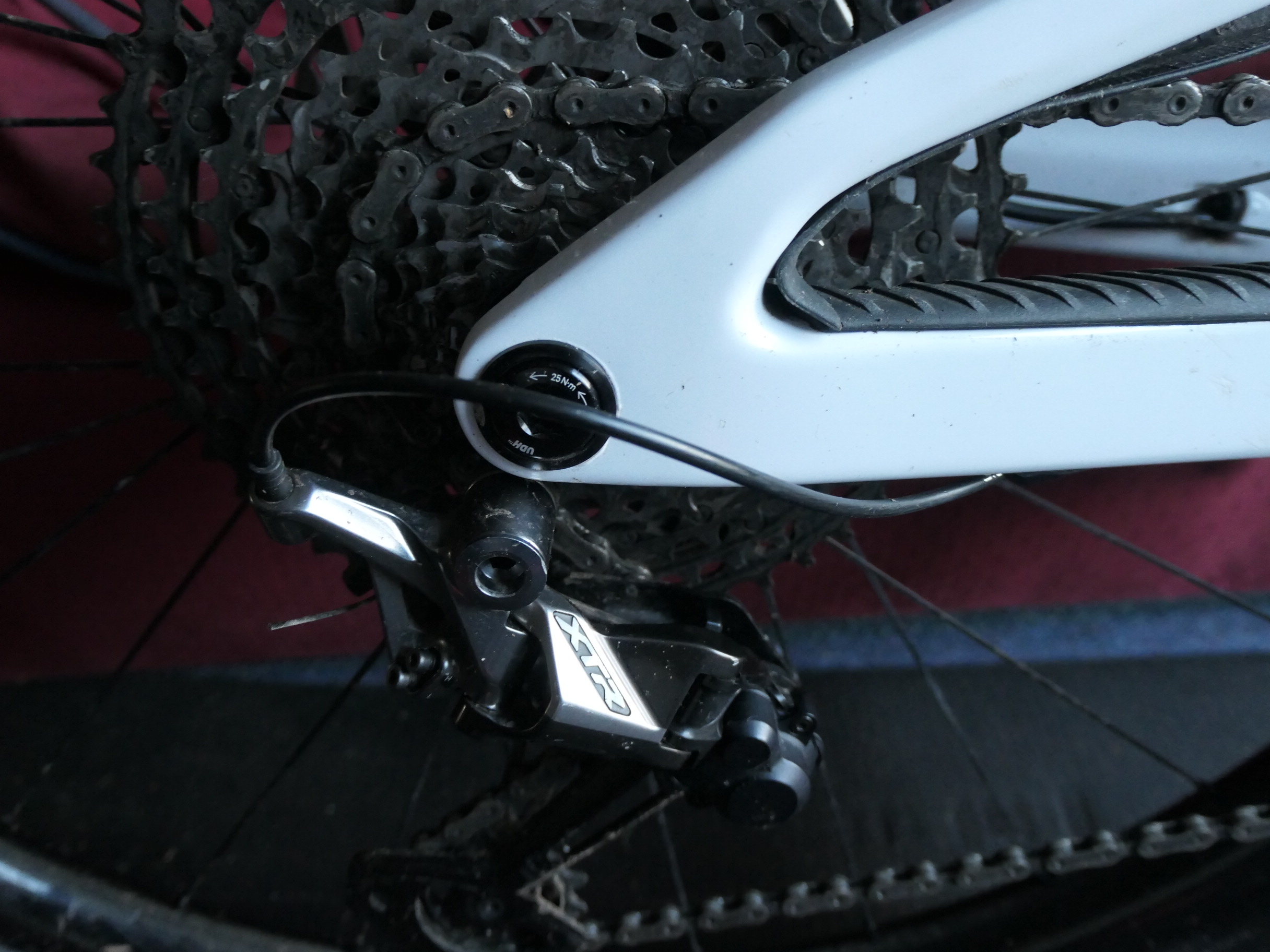

In my Spark with XTR mechanical I actually use a Jagwire 3mm housing (same as dropper) and 1.1mm cable. I used the hose end caps that are for the Jagwire 3mm housing but terminate as a 4mm hose. I tried this to make it easier to thread though to and out of the rear chain stay and I also was able to feed it though the headset spacers down the frame tube etc without having to undo the fork stem. After slackening the lower two shock bolts I pulled the shock back and was able to thread the hose through the rubber bellows into the chain stay. I used an angled pick and a magnet to get the hose from the chain stay and through the hole. Note the crossover at the BB. Changed it a year ago and shifting has been faultless.
