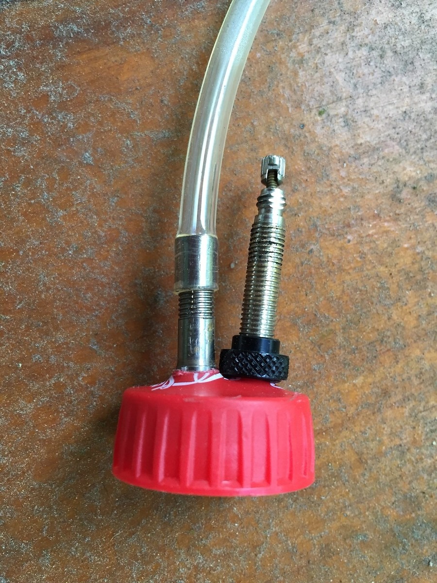

https://www.vitalmtb.com/forums/The-Hub,2/Joe-Barnes-DIY-Coke-Bottle-Tubeless-Compressor-Hack,8450
